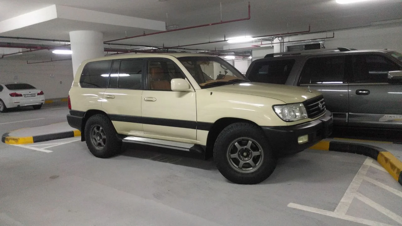

method 304 17x8.5 zero offset with 35x12.50 kenda klever
I’m looking at the same model but will be sticking with the 18s and a milder offset of +25ET. Did your Method 304s on 17 clear the hub center bore without issues?
Curious too... Been debating with the 304 or 301 in the zero offset or the +25 as I want something that is sucked in a bit. However not sure if I will need spacers to run or not.
The 18” 304s only has one offset spec and that is +25ET. I’m on factory 18” lx wheels (offset +60ET) now with 1.25” bora wheel spacer which sets me in the +28ET area and I’m already happy with that slight poke outward the hub. But I haven’t really read about the ‘backspacing’ part of the wheel (6.0”) if it will conflict with the hub flange or calipers. I sent method an email earlier hopefully they respond sooner than later, will keep you posted here as well.
