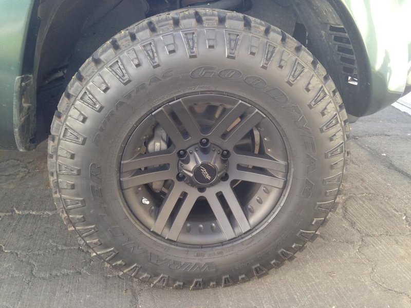

You guys are an answer to my prayers. I am due for new tires and I'm completely sold on the 305/65R18 Nitto G2's, however that tire spec calls for a minimum of 8.5" wide rim. The current rims that I'm running (5-spoke Tundra rims) are 18x8 +60 and Discount won't mount and/or warranty the bigger tires. I know that I could always get a mom and pop shop to mount them, but I have come across a deal on craigslist for some MB Motoring Vortex rims that are 18x8.5 +10. Their appearance is subtle and won't make the truck look ridiculous, however the one thing that I'm having issues with is that with the new offset and bigger tire, the tires will stick out from the wheel well by about 1"-1.5". Based on the fitment calculators and my current set-up, I will have no issues with rubbing. What's your thoughts on the wider stance and the tires not being tucked all the way under the wheel wells?
Your thoughts are appreciated.
Not the actual rim, but same style and color for reference.

I love the wider stance, I had to use 30mm spacers on my tundra wheels to get the offset to +20. I'd like them to poke out a little more, so a +10 on a 8.5" wheel is the perfect look I'm going for. You won't rub, just crank the tb up front a little.
They owe me black lug nuts, but other than that, very pleased with the new look.
@TXBeachCruiser612 Do you mind posting a pic from the front or rear showing how they position widthwise in relation to the fender? I like those wheels. You got a good deal on them off Craigslist....had my eye on them as well.
@TXBeachCruiser612 ... thanks! My 275s would likely be more flush with the fender edges which is what I'd be looking for.
