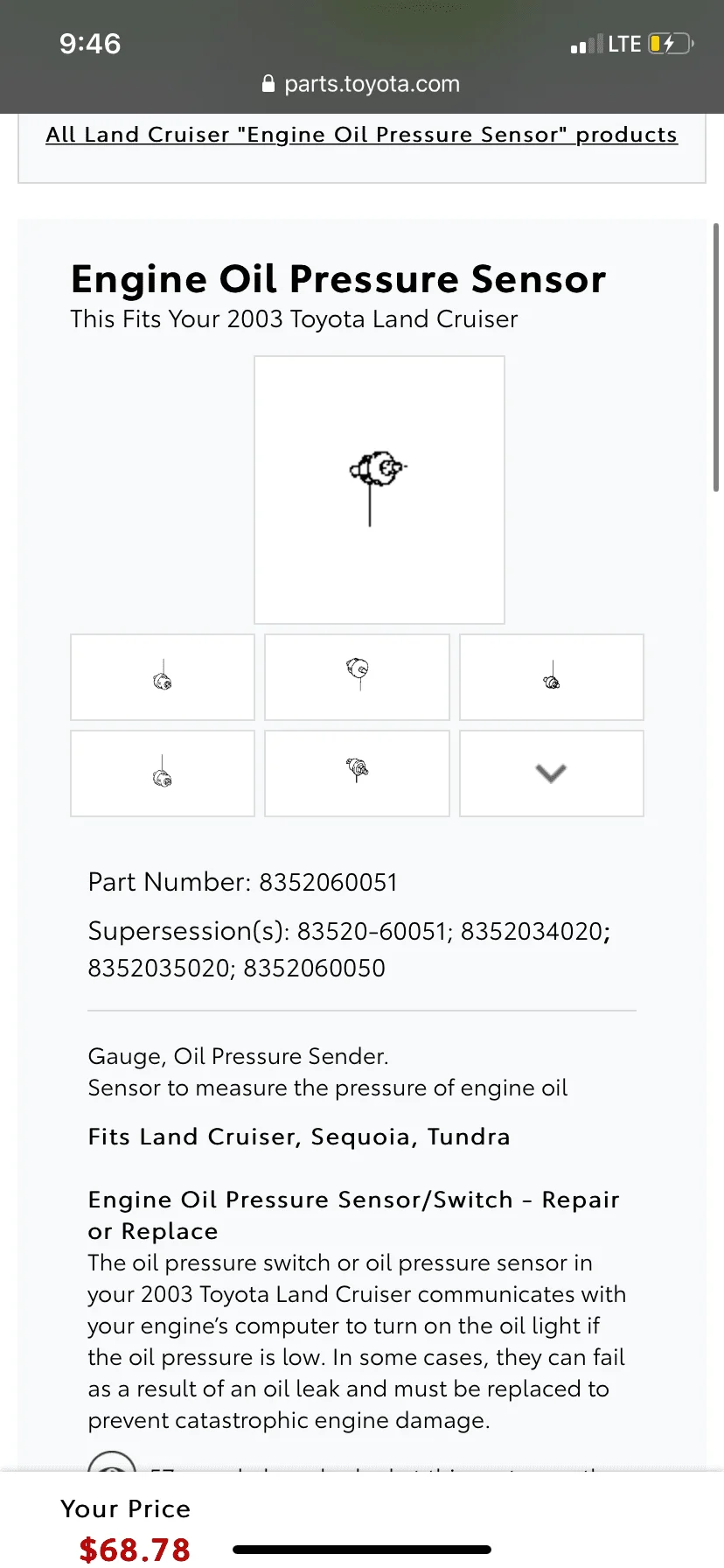

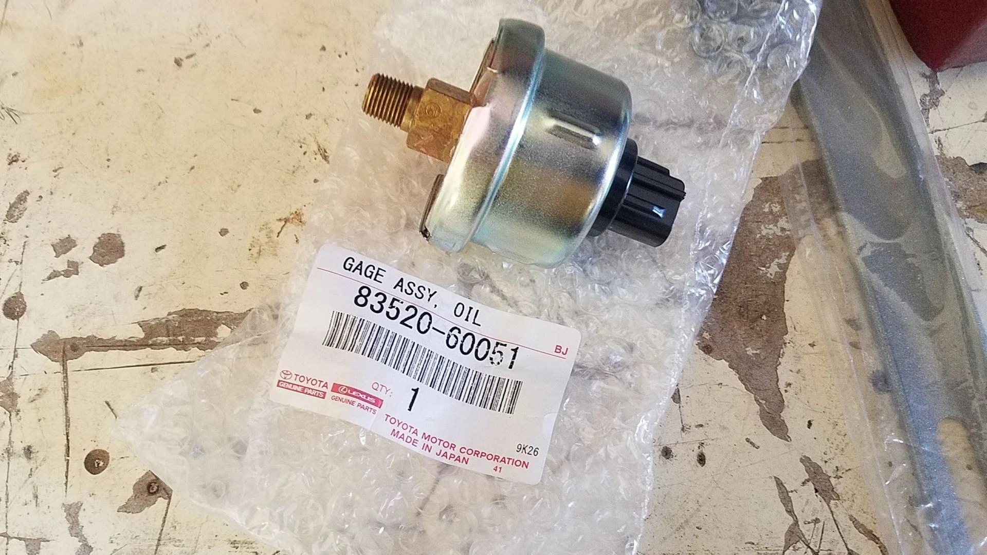

Start with replacing the oil pressure sending unit.
Matches the part number I posted so yes.👍

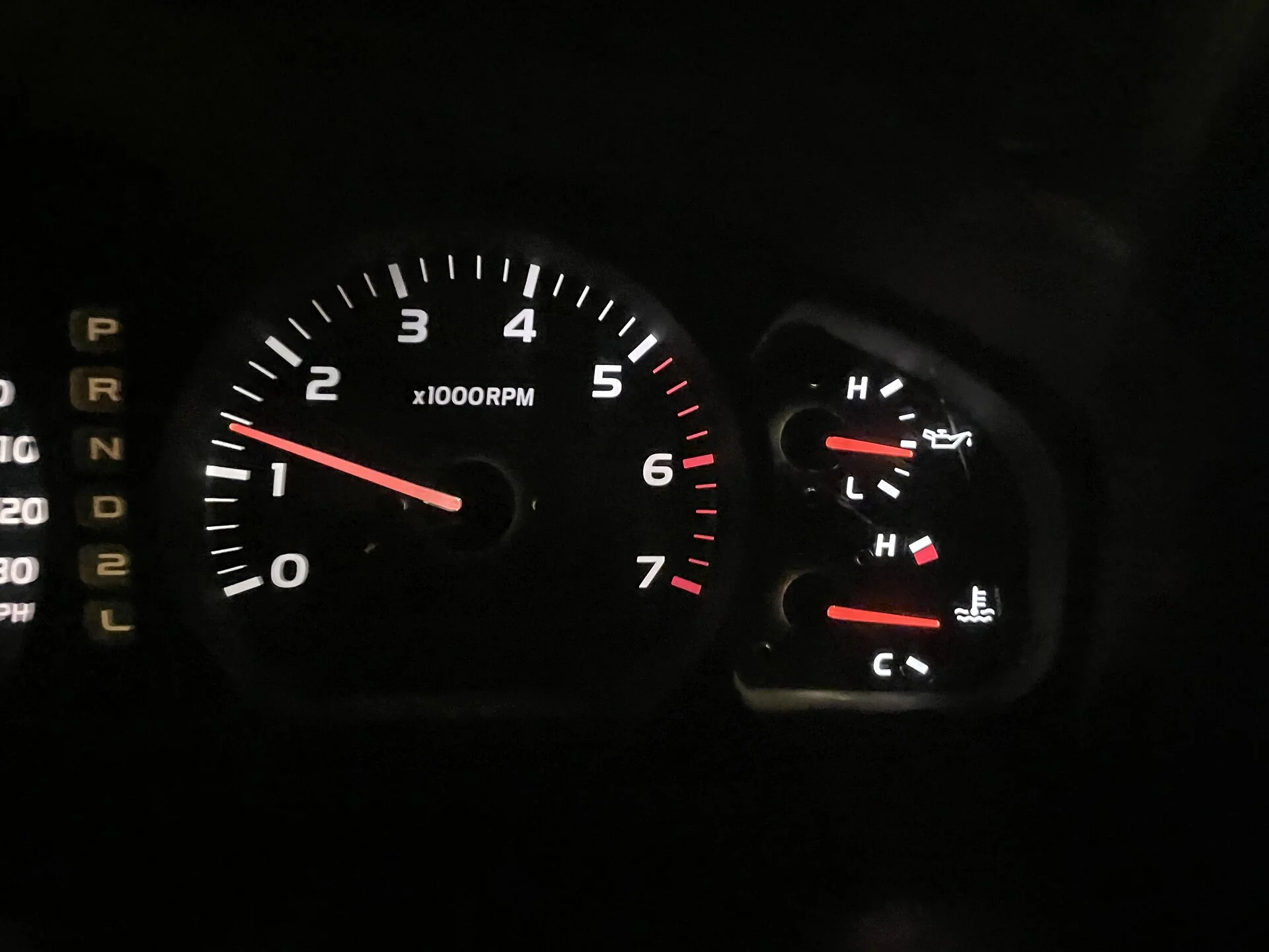

@JunkCrzr89 Thanks for the reminder. Mine always lives at 25%, bottom of “normal driving” range, whether driving or idling. Hasn’t moved in 60k miles. I’ve read a bit on here, and seems typical.
Same here. To the point where i get a little paranoid sometimes. I floor it every once in awhile to see it jump, and it does, so figure it's fine.

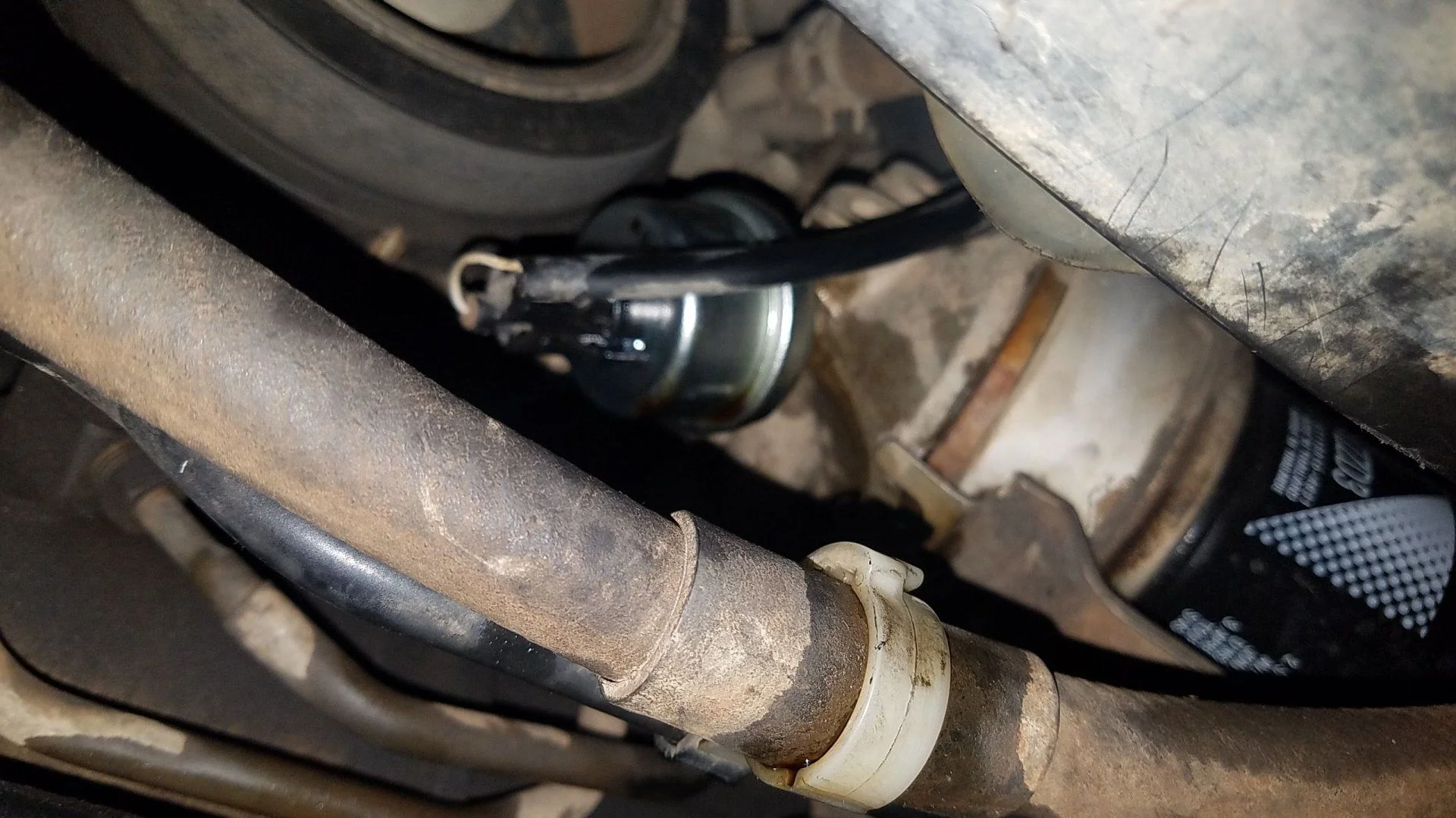

I looked under my 1998 Toyota Landcruiser and the oil sending unit was there but didn't have the wire connected to it. It looks missing? This is odd because I can't find the wire to connect to the sending unit. Can anyone post picture where the wire comes from?
