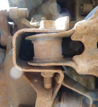

Check the front diff bushings (there are 3), especially the lower one on the driver's side and the pillow on the front of the diff cover.
I just replaced mine and it really made a big different in the behavior you describe above.
X 2 on the front diff bushings.

All diff bushes are in good soft condition. i ran it with front prop shaft removed still no difference. control arm bushes torqued with vehicle weight on wheels.
Perhaps I am misreading your meaning, but you are looking for overly complaint bushings, not too hard. It all needs to move, but any slop/looseness is what you are trying to eliminate.

My front diffs bushings looked OK, until I did test #2. Then, I was more aggressive in checking them than I had been previously. A pry bar moved the drivers bushing more than it should have - I previously just visually checked it and tried to move it by hand. I also took the bolt out of the pillow mount and an extension in the bolt sleeve could move without much force at all - again, looked fine before.
I don't mean to suggest you should focus on the diff - just sharing as an example of the process. Don't be afraid to poke around a little aggressively. The front suspension holds up thousands of pounds. You aren't going to hurt anything with some light persuasion.
