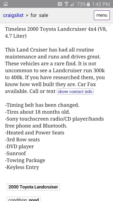

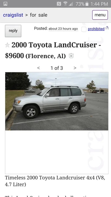

Fellows,
Anyone here own or have knowledge of this vehicle?
Thanks,
Justin
