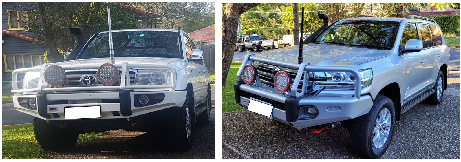

My Fyrlyts were "recovered" from my '07 UZJ100, and repurposed on the LX470.
Bar is ECB polished alloy, all lights (including fog lights) are LED. 'Leccy is coming on Friday to wire in a change-over relay to make the fogs DRLs.
5G Phone aerial is RFI, UHF aerial on "Z" bracket is Uniden.
