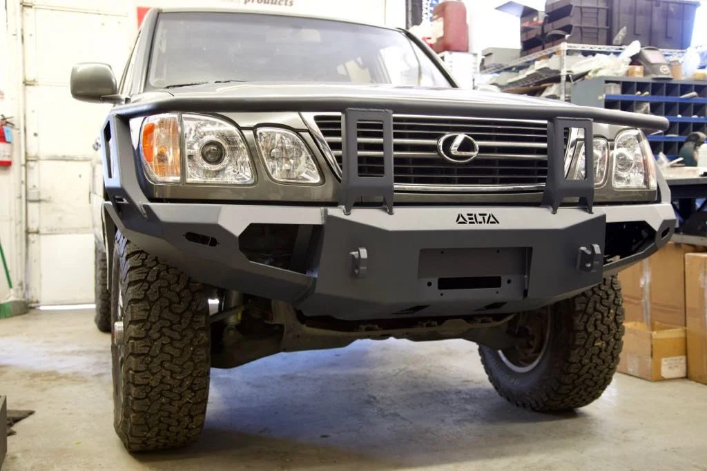

I only wish there were more pictures available for the different types mounted on an LX470. Protection is the key objective, but aesthetics are important to me also. Looking at Ironman right now.
