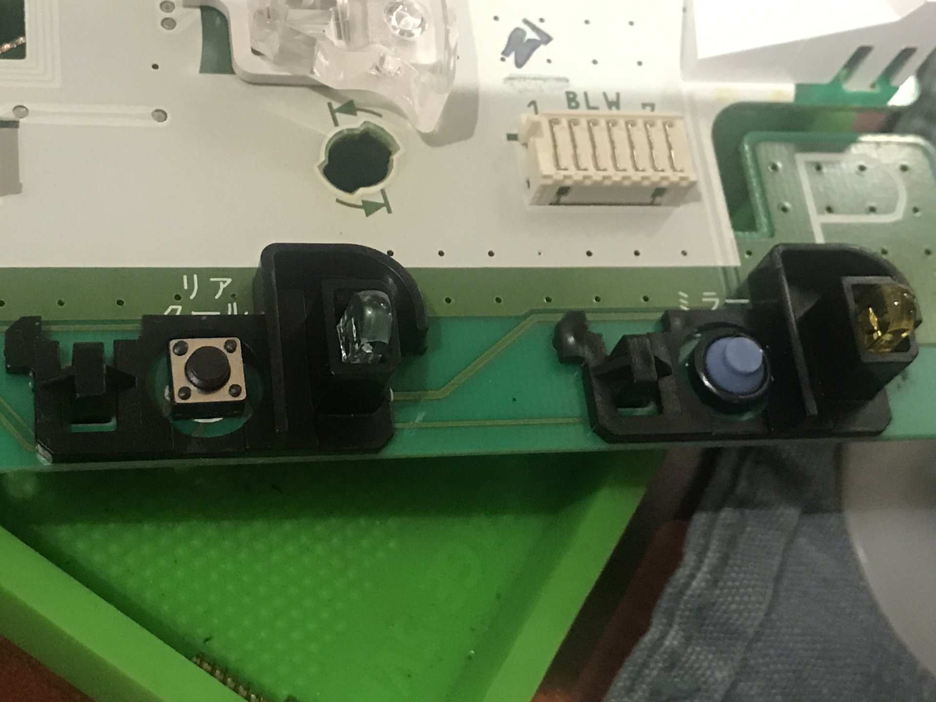

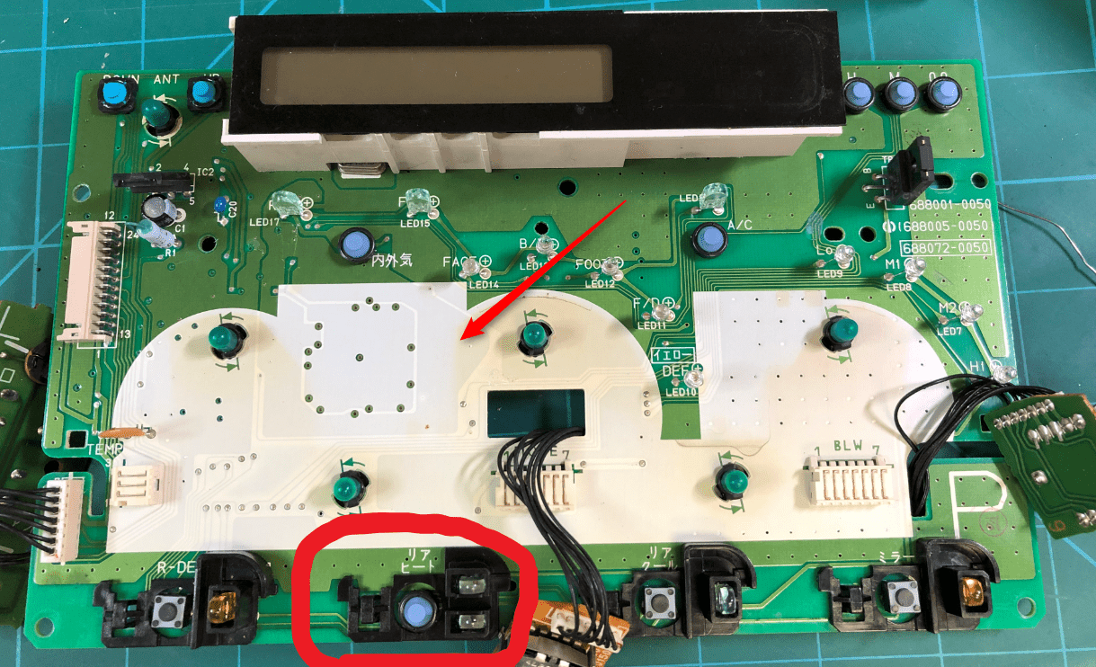

What does the button circled in red do? My 2001 LX470 has a blank there, like all the others I've seen. The button is on the circuit board, but not on the outer fascia (just a blank).
The Japanese text on the circuit board says "rear ____" something, according to my Google lens app. "rear cool" is the second from right switch... Ideas? Thoughts? Any Japanese translators available?
Circled red switch label says Rear Heat
