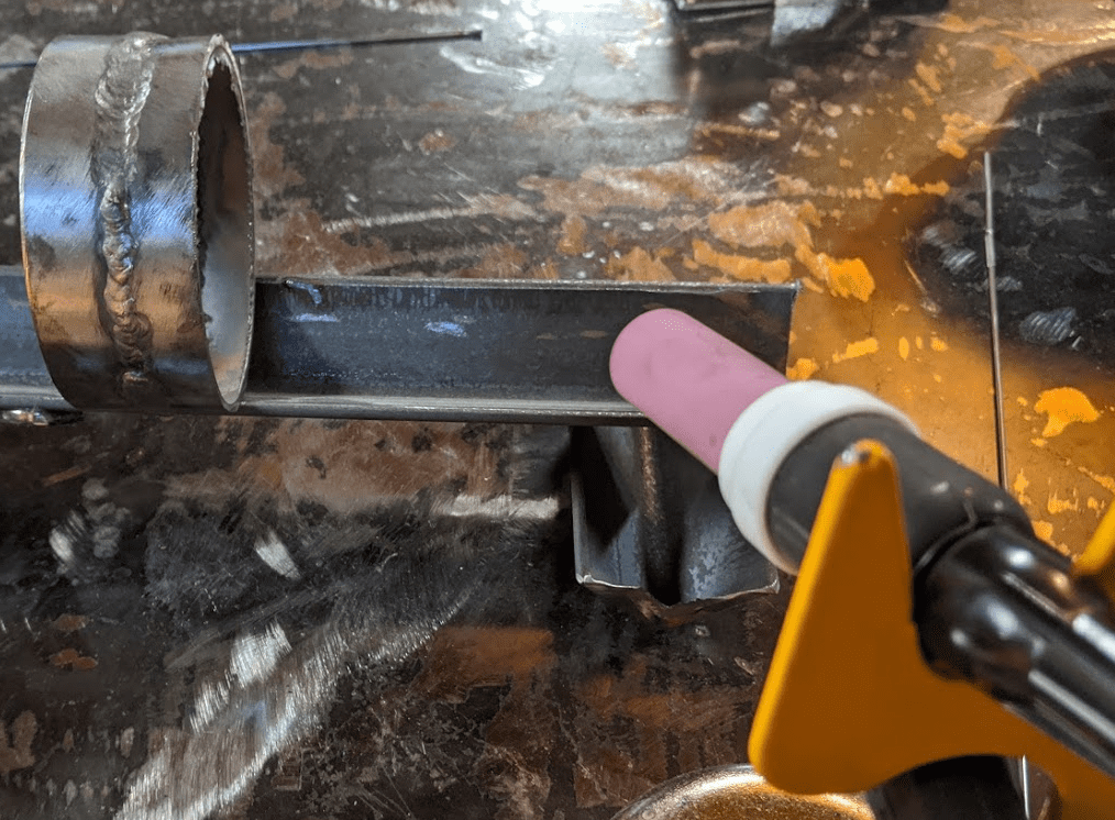

Still waiting on the machine shop for the engine. Trying not to get overly impatient. Only real update is I took inspiration from @lelandEOD and have been trying to learn tig for a stainless exhaust. Its all booger welds but Im pretty sure I can make something functional, and maybe make it look ok with more practice.

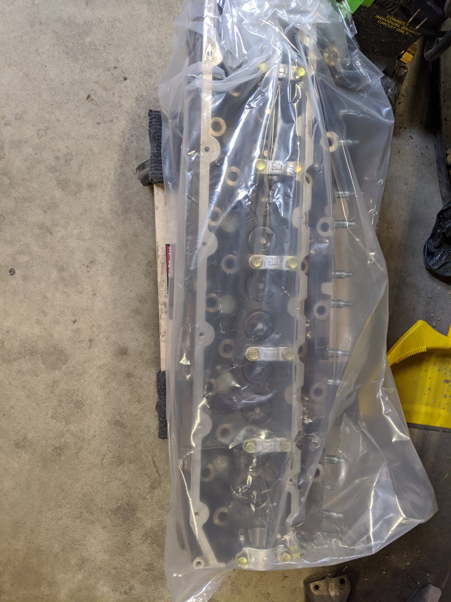

Are you rebuilding the head/adjusting the shims and valves or are you sending it out?
Ok I guess there's more. The head was rebuilt by the machinist and adjusted. Cam was left out for transport so I'll need to do that once I have timing set. As I recall, he replaced 3 guides and of course all the seals, while decking it and cutting new seats. I need to pore over the work order again and will be double checking what I can.
