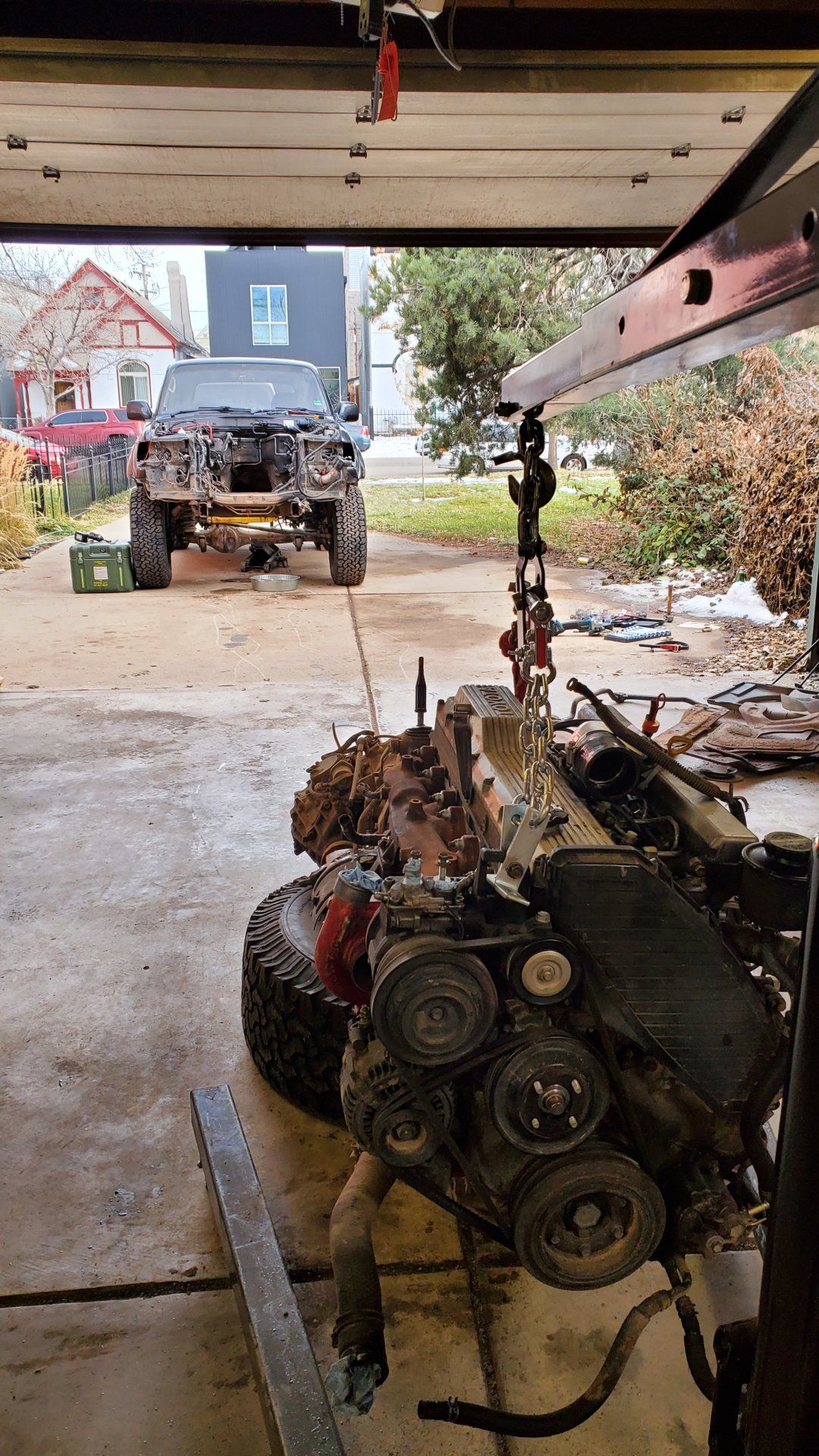

Started pulling the engine. I think we have it pretty much ready to come out, other than the half-dozen things Im sure are still attached to the top of the transmission and transfer case.
My time is pretty much non-existent until December, so the rest of the extraction will need to wait a few weeks.
I bet you will bang your knees on that winch about a 100 times, maybe more
Yep took it out as an entire stupidly heavy unit. I think it was the best way to get the engine out and now I have access to the tranny and TC. I think the actual removal (everything disconnected) took maybe 30 minutes with 4 guys total working on it. I may get the TC rebuilt, lots of slop and rattles.

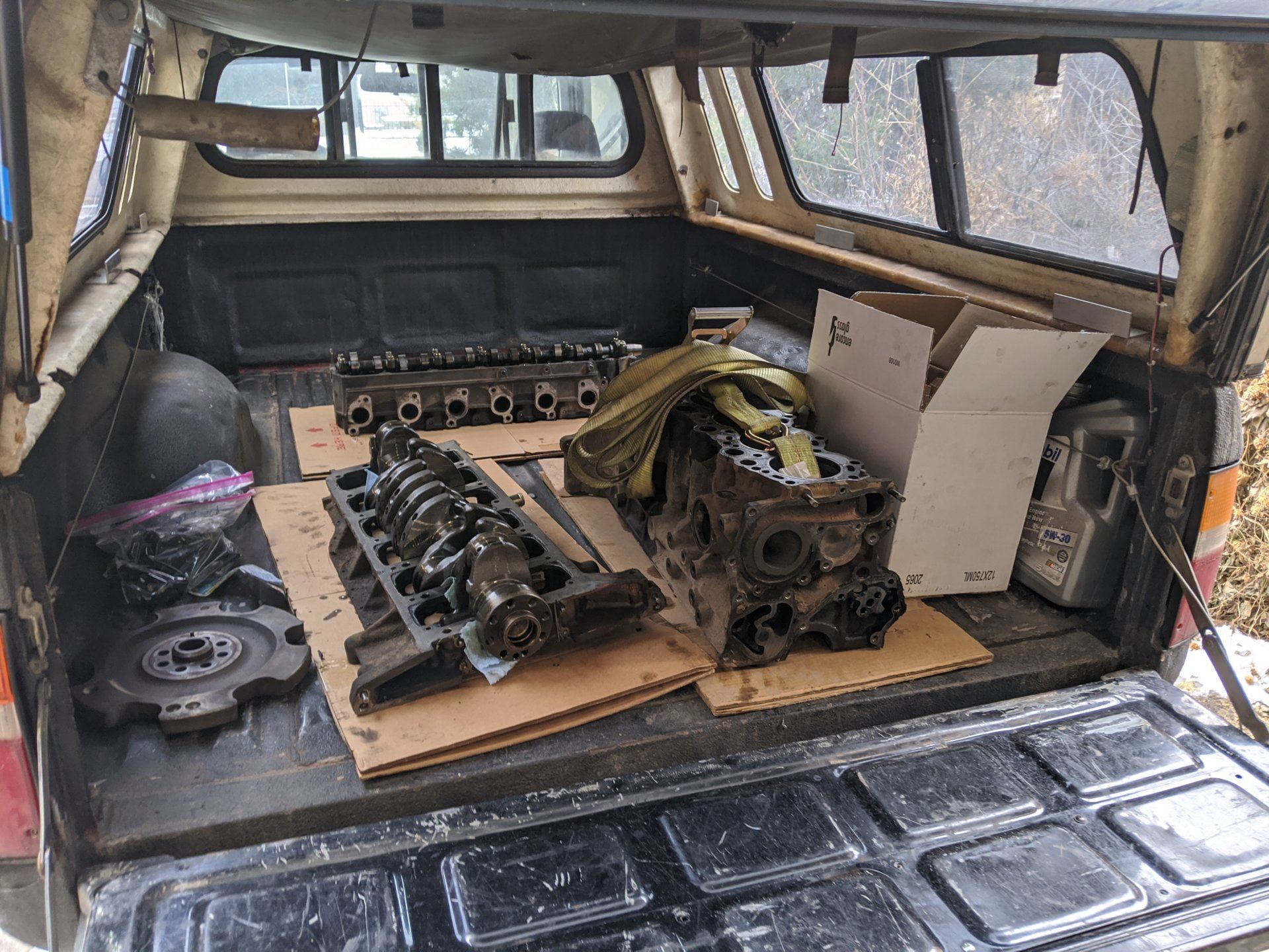

We got it mostly apart. No issues spotted so far, but I still need to give it a good look over when not in tear down mode.

Got word from the machinist. As I suspected, the engine itself is pretty much perfect, but a few valve seals and 3 guides were shot. So this is good news and bad news I guess. There is no smoking gun as far as low compression goes. I never got a great feeling of confidence that the test performed by the mechanic was accurate, so theres that. I think I'll take a look at the old rings when the block comes back and see what the gap looks like. Pretty certain the valve work will fix the smoking, but that also means I probably could have gotten by with a head rebuild. Still no regrets, great having an in-depth knowledge of the engine and its condition, and its forcing me to fix a lot of other issues.
Here's the work going in to it:
Rebuild head, machine to flatness, replace 3 guides, grind valves, cut seats
Ball hone cylinders (they are all well within spec and almost perfectly circular)
Reuse pistons (read an article somewhere that the original Toyota pistons are pressure cast, but new are not, so this is OK with me)
Big end of rod out of spec, machine but keep at std. bearing size (gave an explanation on how it works, sounds magical to me)
Polish crank
Balance
