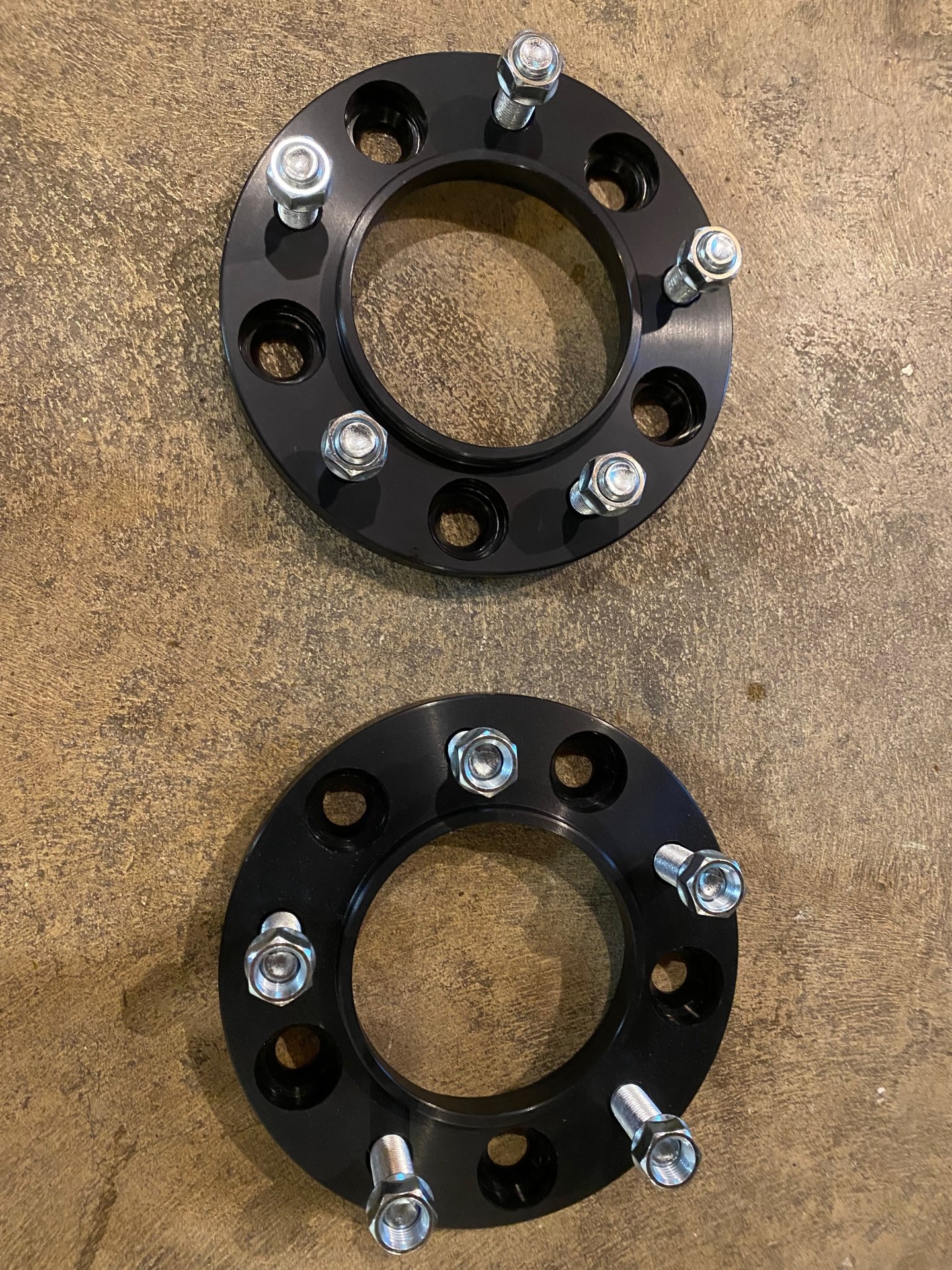

I actually have two of these for sale in classifieds section (for a 200 series, not four - just a pair). On OEM Toyota wheels there isn't enough space in the "pockets" or "voids" or whatever you want to call it for the wheel studs to fit - so you have to slightly shorten the factory studs. Like an 1/8" or less. With aftermarket wheels who knows.
If anyone wants to give them a try be my guest

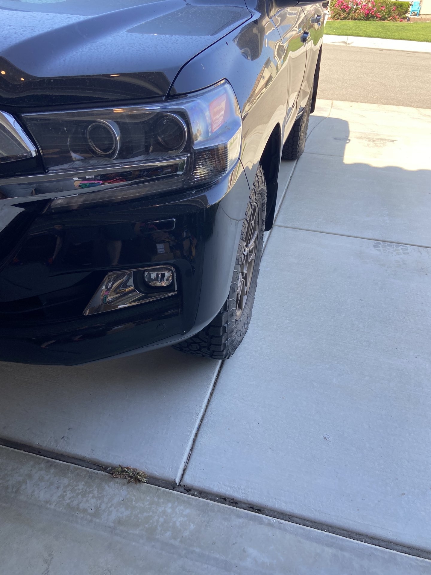

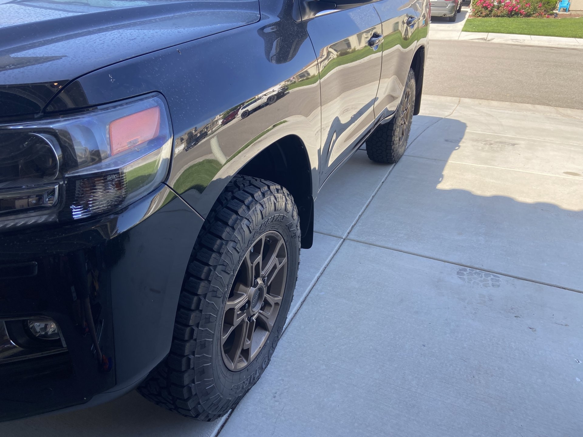

Yes they work! Have seen tons of questions about "what's the thinnest spacer you can run". Most claim it's 1.25". Well, installed my Bora 1" spacers today and they work perfectly. The rear axle seems to have a touch longer studs than the front axle, but given the recess in the BBS HE wheels zero issues with getting these on.
First photo is stock with 275/70R18 Toyo AT3s. Second is with the spacer installed on only the front wheel.
Thanks for sharing! Any chance you could share a side and 3/4 angle pic with everything mounted? Would love to see how offset + 33s looks. Thanks!!

Post 4 is the best I have right now. I'll take some more pics on Wednesday. Right now the truck is in the shop getting PPF and window tinting done.
