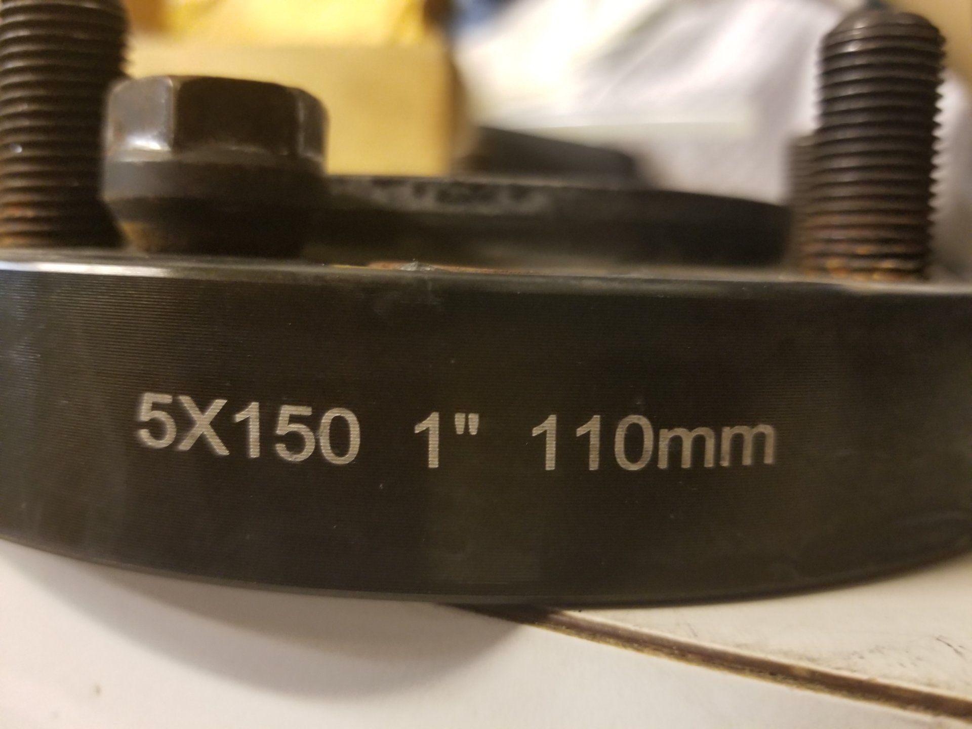

I might do it later. I actually don't have any issue with the spacers or the nuts holding them on, (edit: front lug nuts were protruding but so we're the studs) everything was as tight as could be. They are not cheap. The are hub centric. The bolt protrusion wasn't much maybe 1/8 inch at most and it wasn't that obvious to me that the wheels were not seated fully. Because the hub centric ring did protrude into the wheel hub. Once tightened there must have been some millimeter of space left that I couldn't see it through the wheel spokes at an angle. The wheels are stock LX 20 inch for 2013 model.

They are quality billet aluminum hub centric spacers. It's just that the OEM studs are too long and 2 sets of lug nuts were included one of which protrudes past the face of the spacers. Instructions said I needed to use them on the front only. I will post pictures later today.

I haven't taken the wheels off to take pictures yet since it's raining here. But here are some of the spacers and nuts. As you can see I just laid them on the spacer and they protrude just a bit. My 2013 wheels definitely don't have cut outs on the backside.
