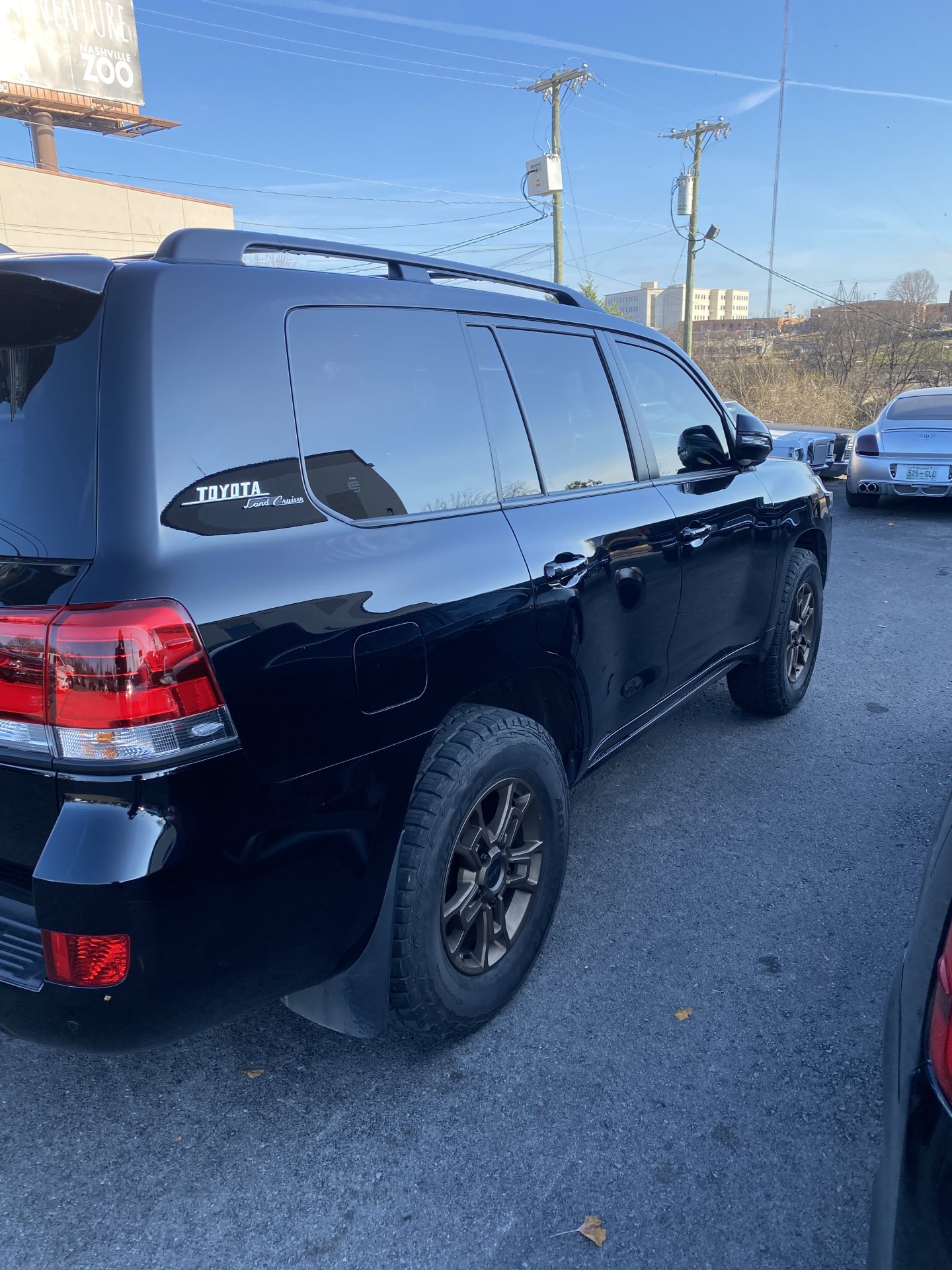

Would you mind posting a few pictures of your Cruiser? I'd like to see the stance of the wheels with the wheel spacers and OEM spring spacer.

I've got this exact setup on my truck. See pics at the beginning of this thread

Sure thing. Here are a few. I dropped it off today at my local shop to install an Ironman Foam Cell Pro kit - 1” comfort load front and back. Had a great stance before, I just wanted to tighten it up a bit especially when hitting interstate bumps at 70mph. Felt a little too wobbly. I’ll post more pics when I pick her up tomorrow.

Looks great. I like what you did with blacking out the chrome - very nice!
