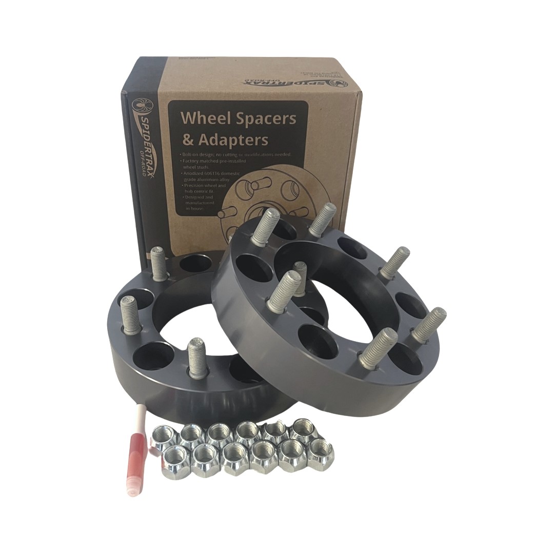

I recently bought these wheel spacer for my LX450 and the tire shop informed me that they don’t fully fit due to outer lip not being bored to same size as the rest. Can someone recommend something that should fit. Thanks
Spidertrax or Bora.
The ones you bought are hub centric. The raised lip around the bore of the spacer is meant to fit inside a wheel to center it. Those will not work on an 80. You need some that are lug centric and use the lug nuts to center the wheel.
While it's hard to screw up spacer production, there is variance in quality in some brands. Spidertrax is well known as one of the best quality. I would strongly recommend high quality spacers! These aren't something you want to have fail.
I bought my spidertrax spacers from Slee Offroad.
Last paragraph in Slee listing is important if using hub centric wheels.

I've had them for about 1,000 miles. I definitely used the locktite, I've heard too many stories of spacers coming loose on the highway. I re-torqued them after 200 miles and just kick my tires every now and then to ensure there isn't a loose spacer or wheel lug. I bought Spidertrax front and back.

You would be using a bolt on spacer for this application. Pretty much anything over 1/4 inch should be bolted on. Otherwise there may not be enough stud length for the lug nut to safely and securely grab and hold. So, yes, you can run a 1 inch spacer. You can run up to probably 3 inch spacers(safety may be a concern) on our landcruisers. But they will be bolt on spacers, thus you are actually bolting your wheel to the stud in the spacer and the spacer gets bolted to the hub with the original lugs.
No I get that. It would be a bolt on spacer. I just want the wheels to have just a lil more “poke” I like being able to glance out the window and see where I’m placing a tire. And currently the flares hide the whole tire. So will 1” ones work as far as stud length. Or has anyone used 1” instead of 1.25 or 1.5.
I think the only way to determine if it will be enough poke is to measure one inch out from your current tire placement. if your tire were pushed out one more inch, would that be enough for you to view in your mirror, or will you need more spacer?
