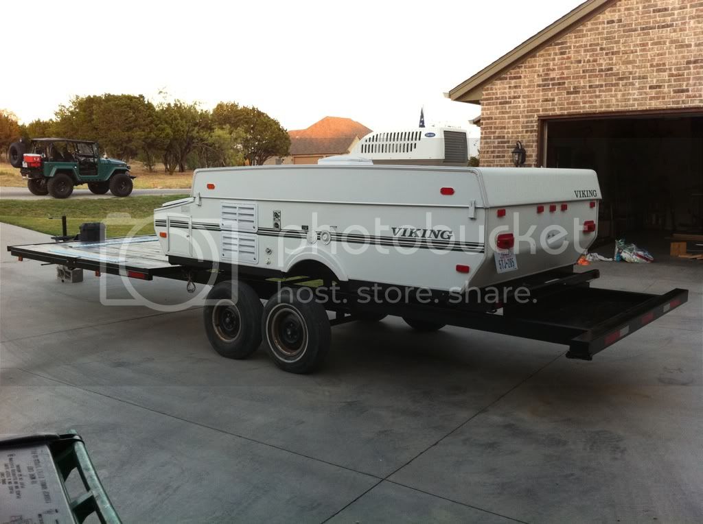

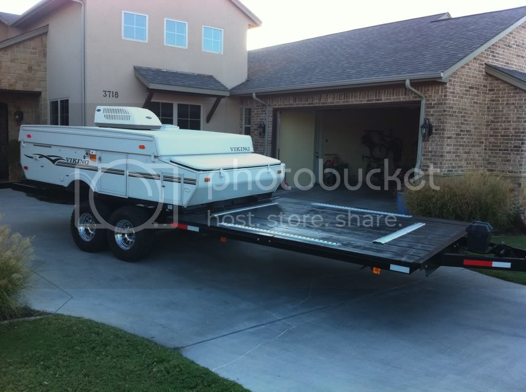

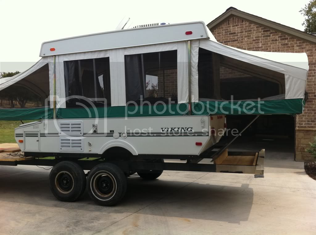

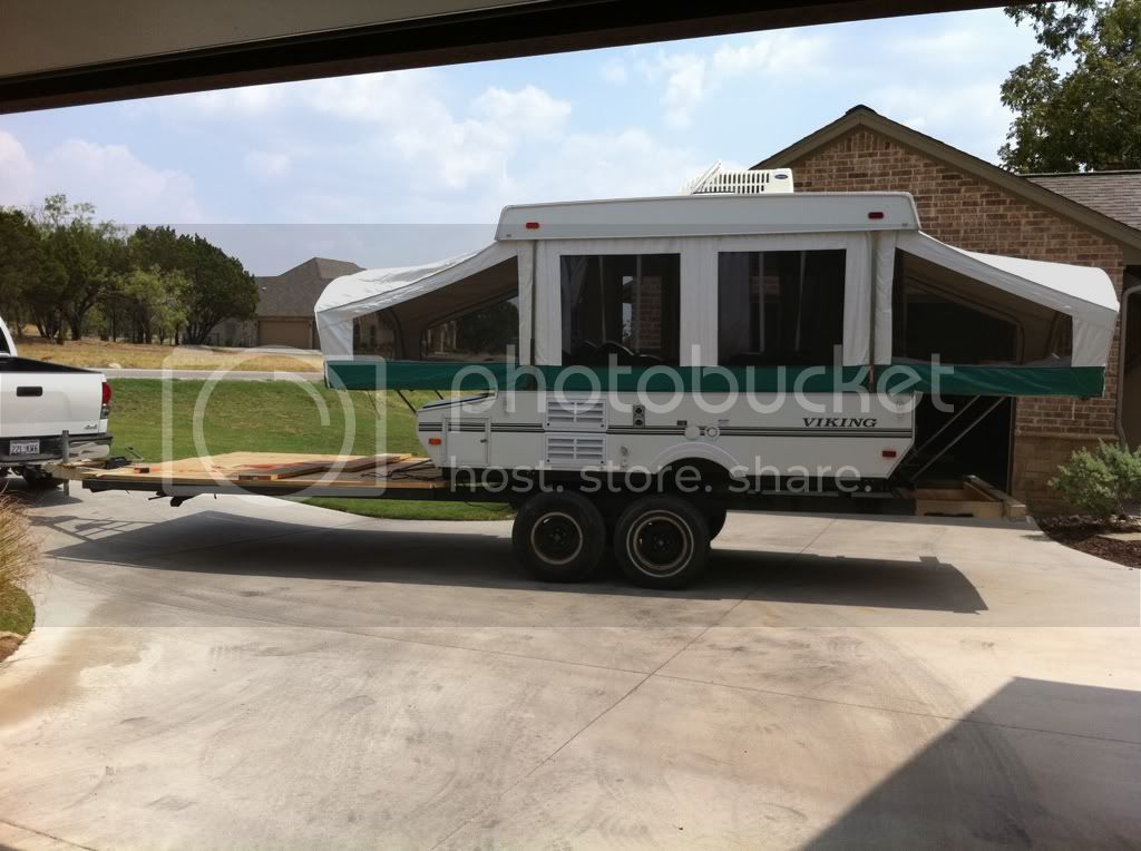

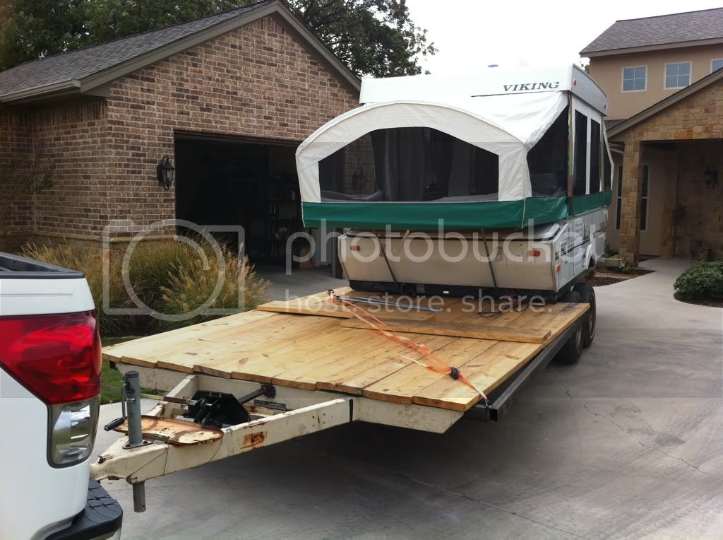

As a matter of fact yes. I haven't been doing a very good job of documenting this, but here are a few pics.
My plan is to take it to a shop and have them cutout diamond plate that will face both sides of the popup right above the horizontal "pinstripe" on the camper. The top of the diamond plate will sit right under where it says "Viking" and bottom will overlap the bottom of the camper. This will cover the wheel well and help balance the look. They will also make cutouts for all the lights, hose connectors, heater vent, etc.
I also went to discount tire yesterday and bought 4 new wheels. It will help clean up the look a bit.
My front deck is going to be 118"L x 102"W, which should give me room to haul a 4wheeler and a Polaris RZR.
Behind the popup I have a small recessed storage area for coolers, gas cans, and what ever else.
I have to finish attaching my floor and run my electrical and I should be good to go.

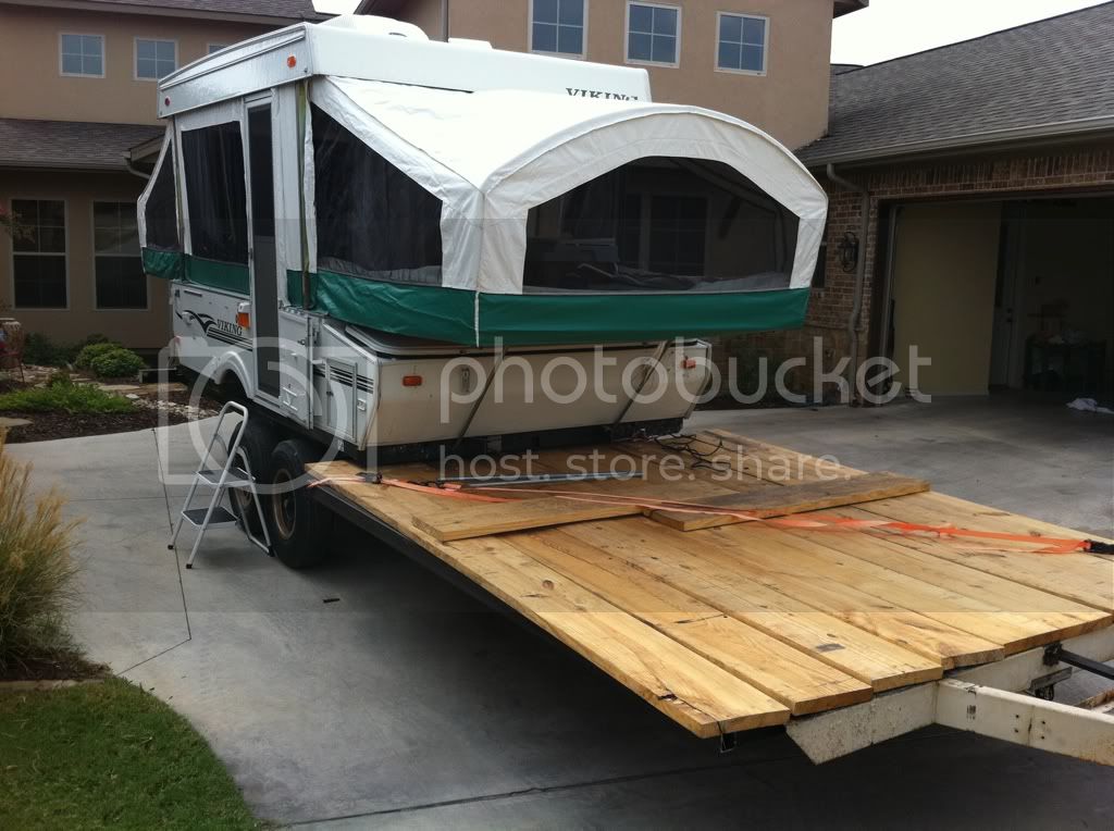

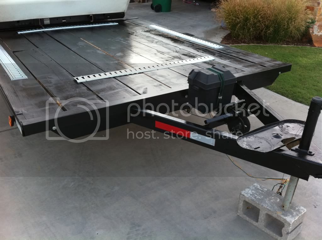

Here are a few more pictures from this weekend. I got the lights wired and hooked up. I still have to wire the brakes up and do a bit more welding but it is getting there. I bought new wheels which I hope to get mounted this week which will change the total look.

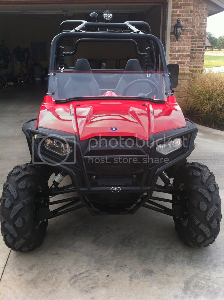

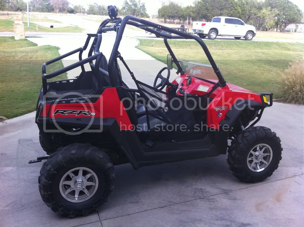

I know this screws up the plan, but the "4" is so damn awesome. It has many, many plusses over the "S" and really gives up nothing.

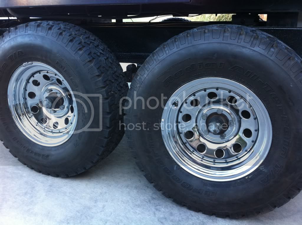

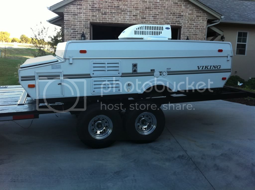

Picked up my new 31" BFG All Terrains and got them mounted on my new steel wheels, totally finishes the look of the trailer.

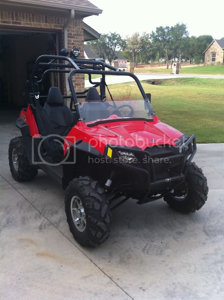

I also bought this small accessory a couple days ago for the front of the trailer! 2011 RZR S. Got it "used" and it had 4.5 hours on it and was bought 8/27/11, its not even broken in yet!
