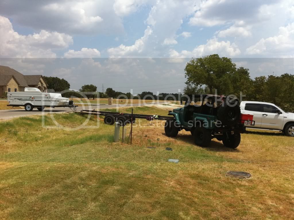

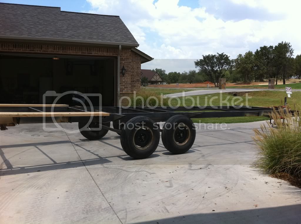

It is a 28' frame from a travel trailer. Pulls straight, both axles have brakes. I priced out two axles w/ brakes, and a coupler, and that was around $600 and that doesn't include tires, wheels, or any steel and my time to build it. It was a no brainer.

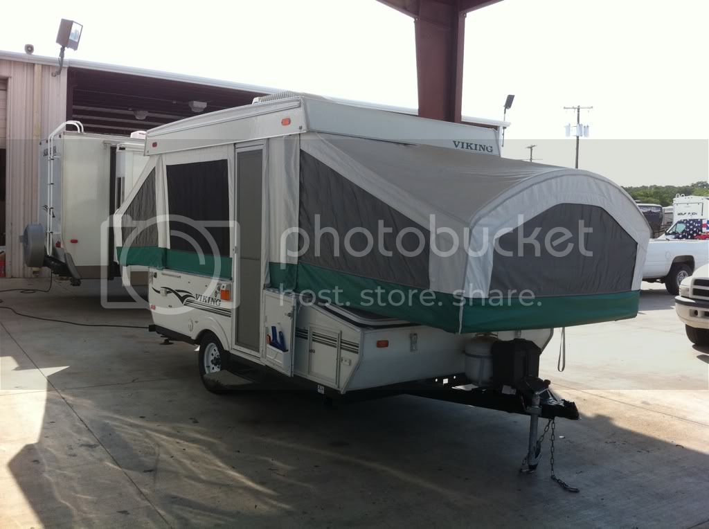

So, step two was to find the pop up portion. Stopped by a RV dealer and they had taken in on trade a 2004 Viking Pop, just what I was looking for.
So my plan (in a nutshell) now is to hoist up the pop up, cut the axle and tongue off of it and mount it on my flat bed trailer. I want it to look good and not like it was just thrown together, so it will take some pretty good modification to get it right and to get my tongue weight right.

build it first, leave the axles in place, then weigh the whole thing? unless you have easy access to big scales. 25 ft including the tongue?
25' does not include the tongue, that will be the deck of the trailer. I am estimating that the camper weighs 2500# and the flatbed trailer is about #1500 in the current state.

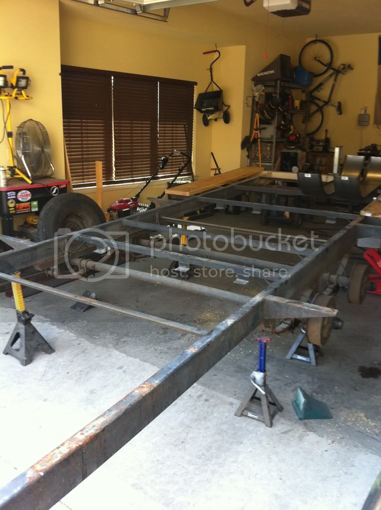

Here are some measurements I took this evening. Looks like I will not shorten the trailer at all. After the camper is mounted I may end up moving the axles forward some. Wish I was an engineer so i could figure my tongue weight from my measurements and from the weight of the camper.

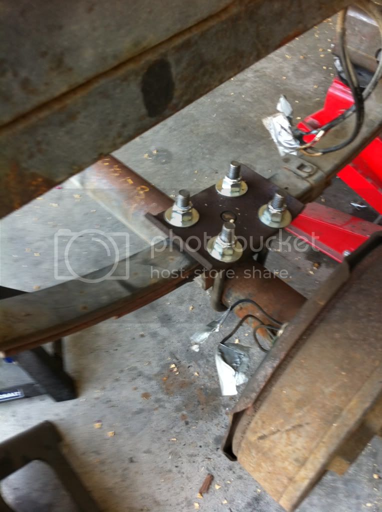

Decided to do a SOA to gain clearance and to allow me to get the popup closer to the flatbed trailer frame w/o having to worry about the flatbed tires coming into contact w/ the popup.
SOA complete

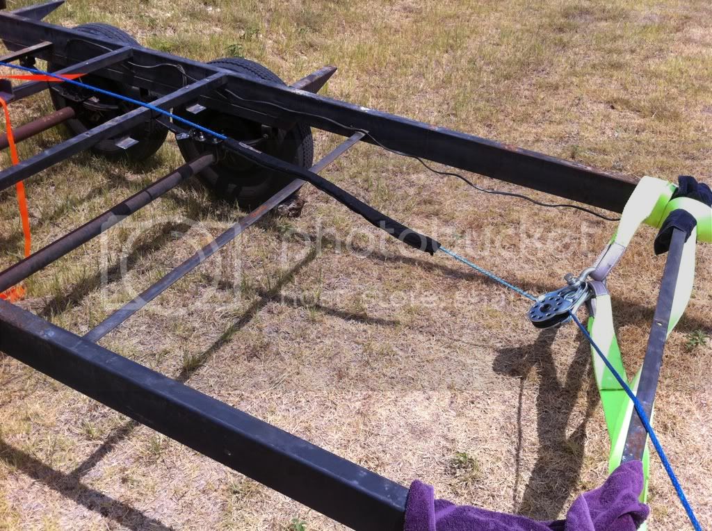

I then used the winch on my 40 and a ARB snatch block to pull the popup onto the flatbed. It was pretty getto, but it worked like a champ.
I now need to center the popup on the trailer and will probably move it forward about another foot or two for tongue weight and chop of the back of the trailer. I'm going to drop pull the axle off and chop the tongue off. From what I have read, it seems you TW needs to be 10-15% of your total trailer load. I'm estimating my Dry Weight will be around 3,300# w/ a TW of 400# and a loaded weight of around 5,500# w/ a TW of 700#. My 08 Tundra has a Payload Capacity of 1,515#, a standard tow capacity 10,100#, a GVWR total of 7,200# and a GCWR total of 16,000#.

if you just rotated the axle upside down to do the springover, your camber will be off. The axle has the bend in it so when loaded to capacity it straightens out some and gives the wheels and tires the correct camber. With the axles upside down when loaded the axles will continue to bend in the same direction and really wear the insides of your tires.
btw, those Tundra's are friggin sweet. The back seats feel like they have more room then the front. It'll be a nice setup once you get it dialed in.
Yeah, I realized this after I bolted it together. I went to tractor supply and bought 4 new perches.

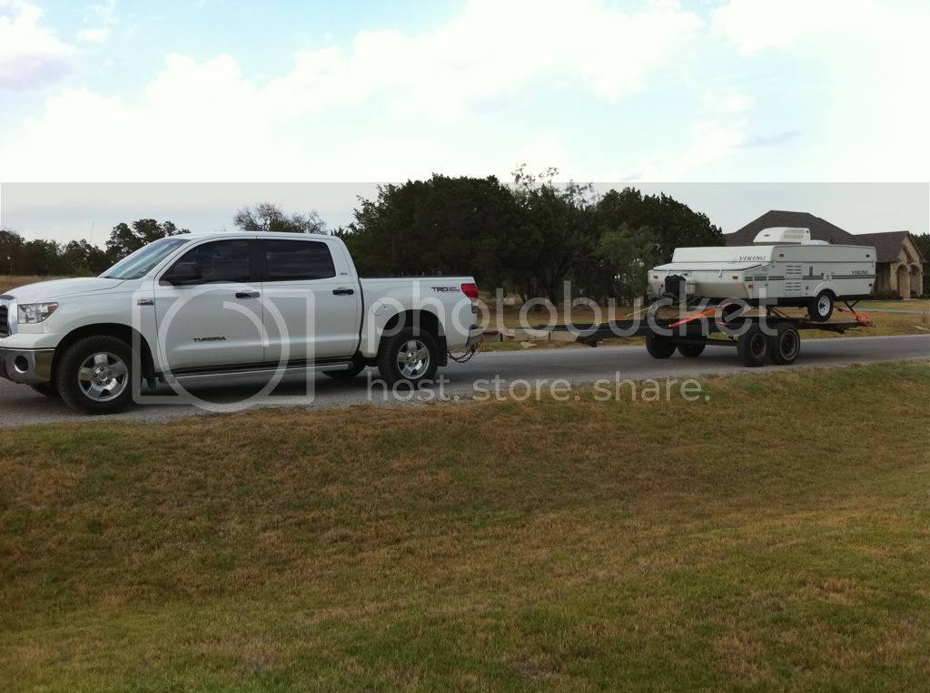

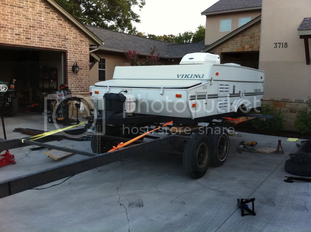

Got the camper lowered down now I need to position it for correct tongue weight. I will buy more steel this week and hopefully make some progress this weekend. The camper is resting on blocks right now to make it easier to move. Once it is finialized, it will be about 3 inches lower and welded permantly to the frame.
Nick

If I centered it, it would throw my tongue weight way off. I have it positioned now where the popup wheel well is over the front tire and my tongue weight is about right. Moving it up even more would put too much weight on the front of the trailer.
