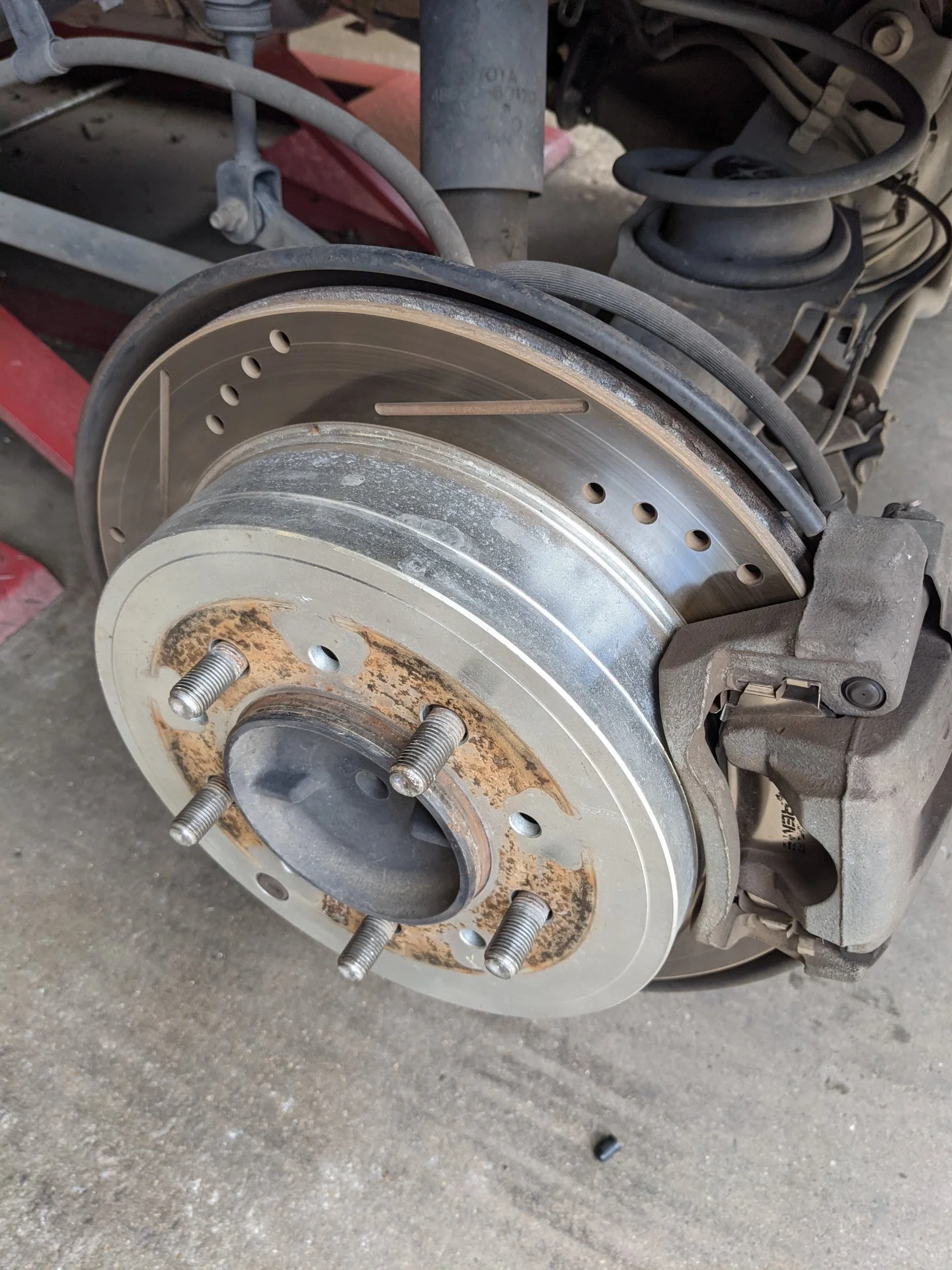

Took the truck in today to rotate and balance the tires. Here's a photo of the brakes and how they have held up so far.
Been a full year now and I'm at 203k miles. I've towed at least once a week on these and they're still going strong. No vibration or fading at all under heavy load braking yet. I'm a believer! Definitely going to install the same set again once I'm ready to do brakes again.
