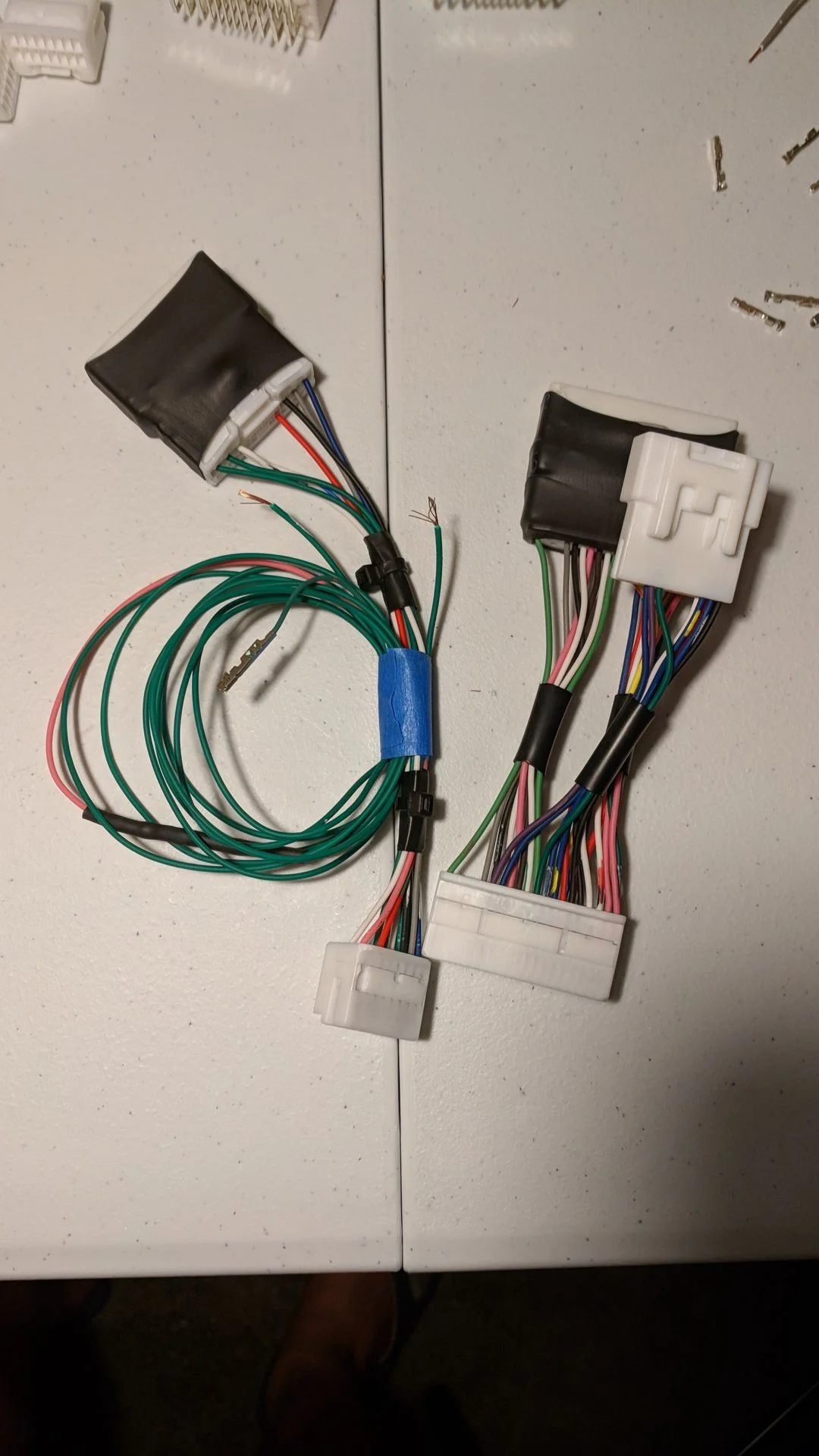

@jerryb I bought your wiring harness for my LX, and it worked perfectly. Now I need one for my '06 LC. I saw that you're no longer making the harnesses, and you mentioned having instructions on how to build your own. However, I haven't been able to find those instructions yet. Can you or anyone else point me in the right direction? I'd really appreciate the help!
Fingers crossed Carmarka comes through for you!
This is the jerryb parts list for the harness:
