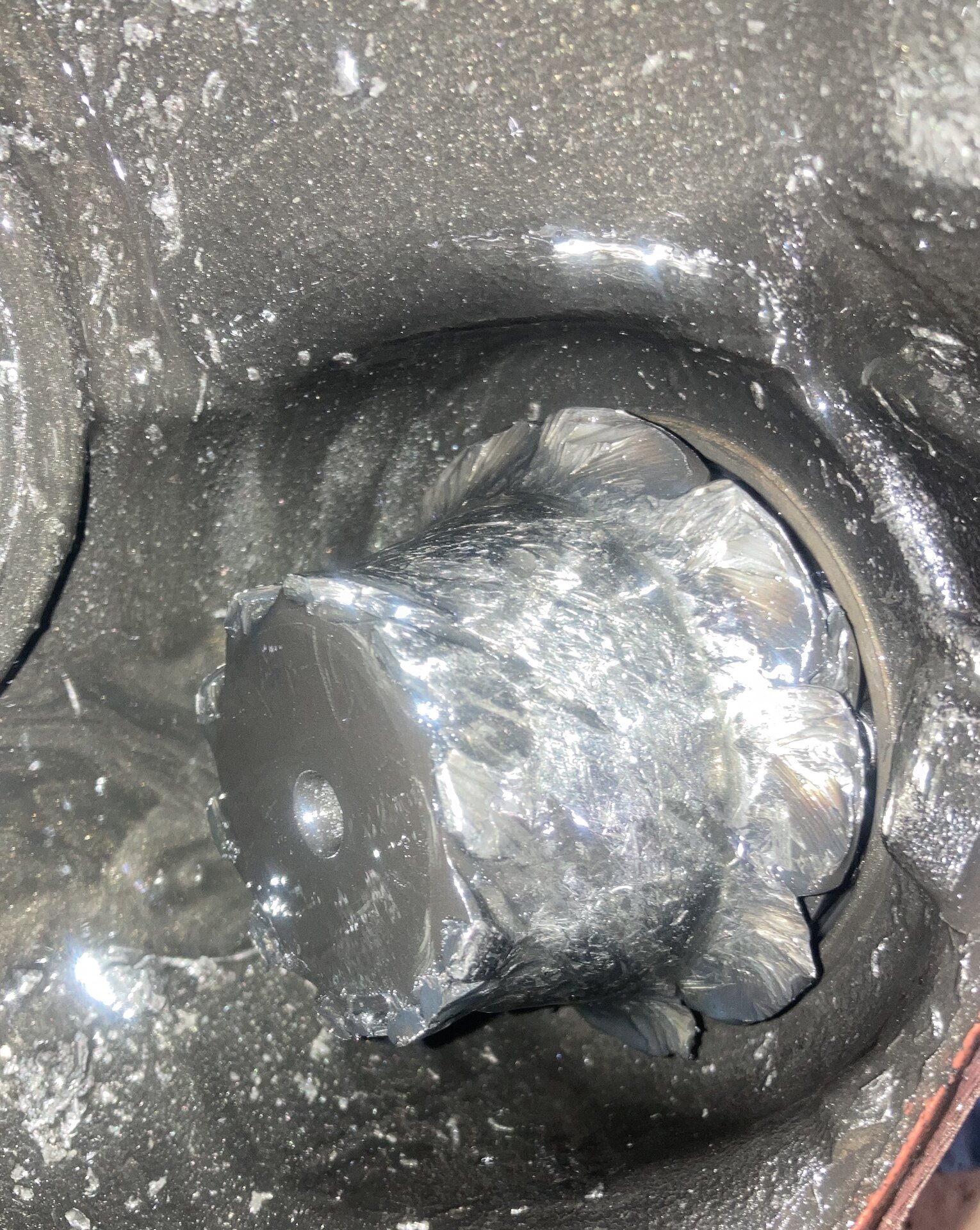

My Sequoia hasn’t wanted to run in 4wd since shortly after I bought it. PO stated he had used it a few days before I bought the truck and everything was “fine”. To be fair, it has a stupid amount of money poured into it (he had receipts for $11,500 USD for suspension, tires, wheels, PM etc etc.) Basically he baselined it, and put $10k into suspension and rubber and rims. I have receipts for a dif service not long before I bought it.

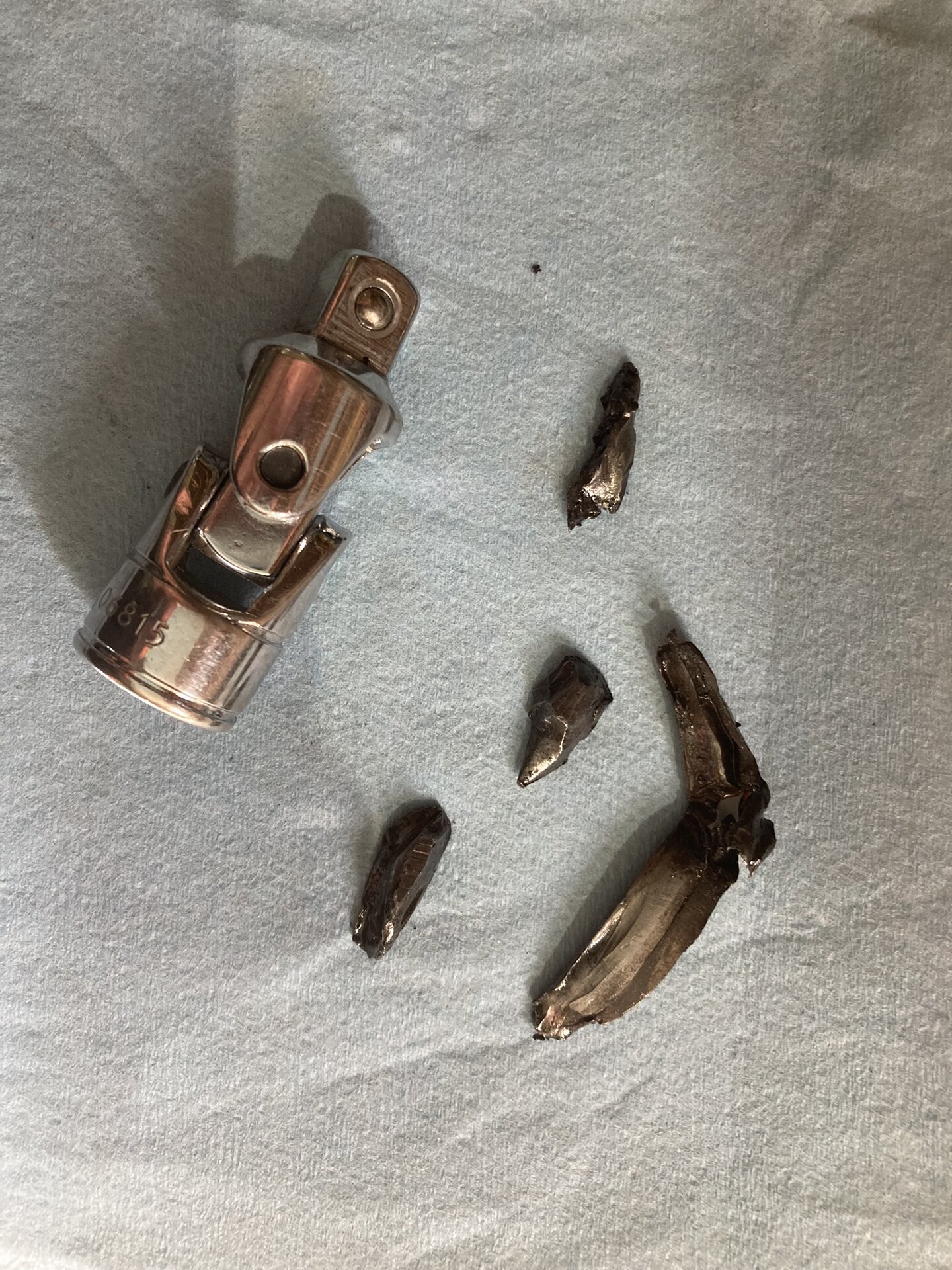

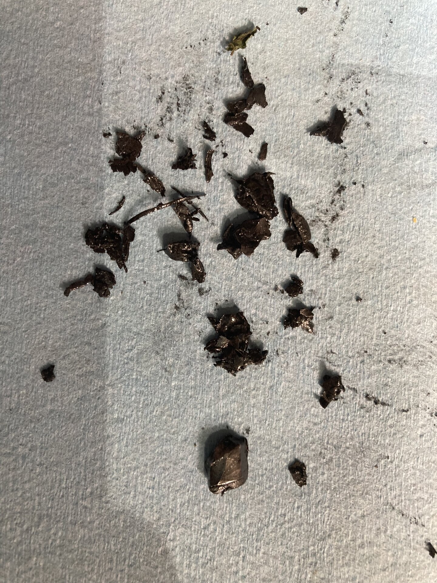

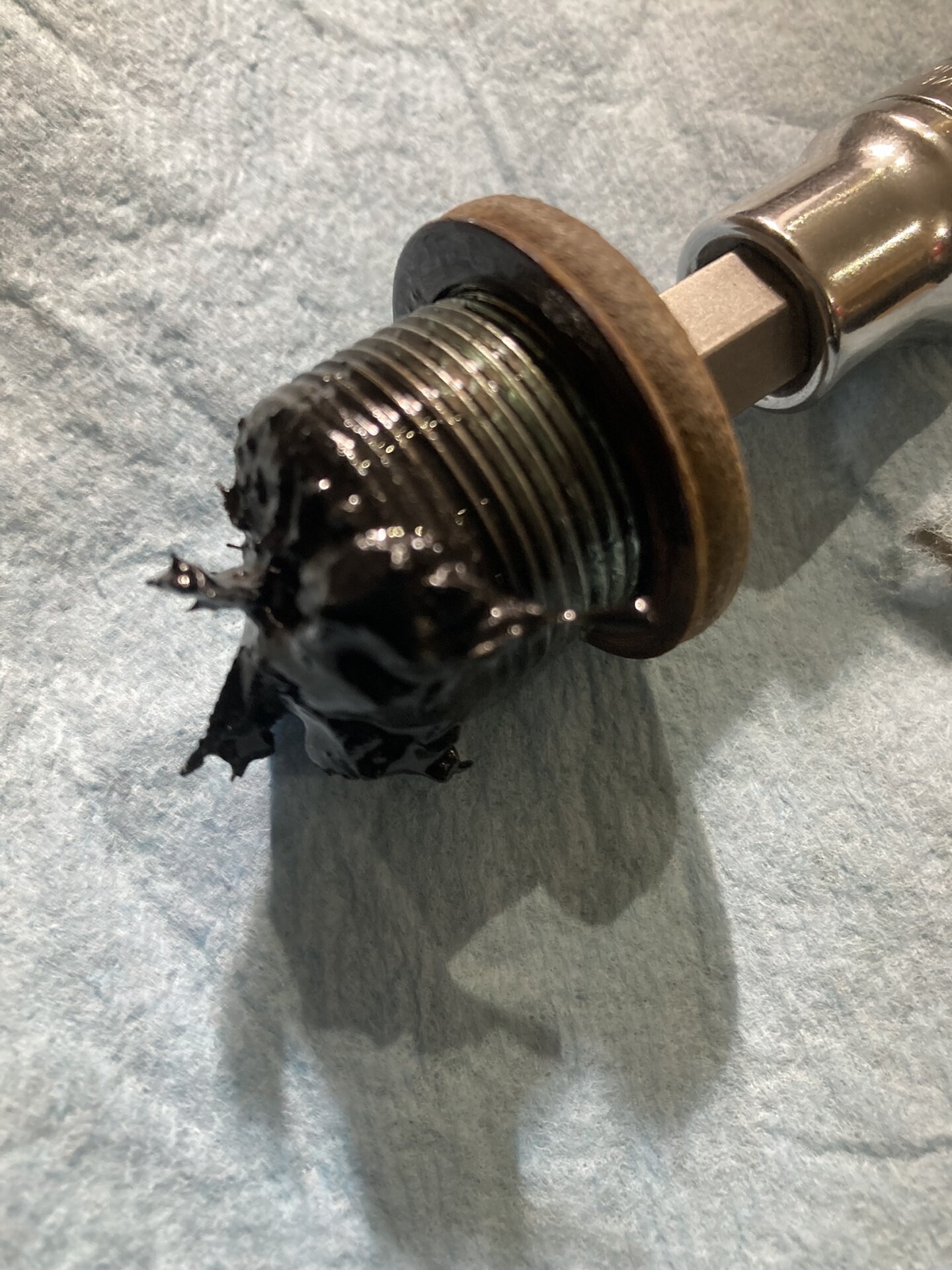

Fast forward a year, and I wanted to get the 4wd sorted. Had a mechanic friend here so took the opportunity to have me on the key and switches while he was reading output from connections on t-case and front dif. We got the actuators working, but still no 4wd. He said do an oil change and see if there is gunk preventing the collar from moving in t-case etc. I drained the front dif first, and found the below pictures. Perfectly normal, right?
So okay, maybe not perfect…
Any idea which other Toyotas from the era would use the same 4.10 front dif? I’m thinking Taco and 4Runner may, as well as Tundra? I’d like to just swap the 3rd if I can…

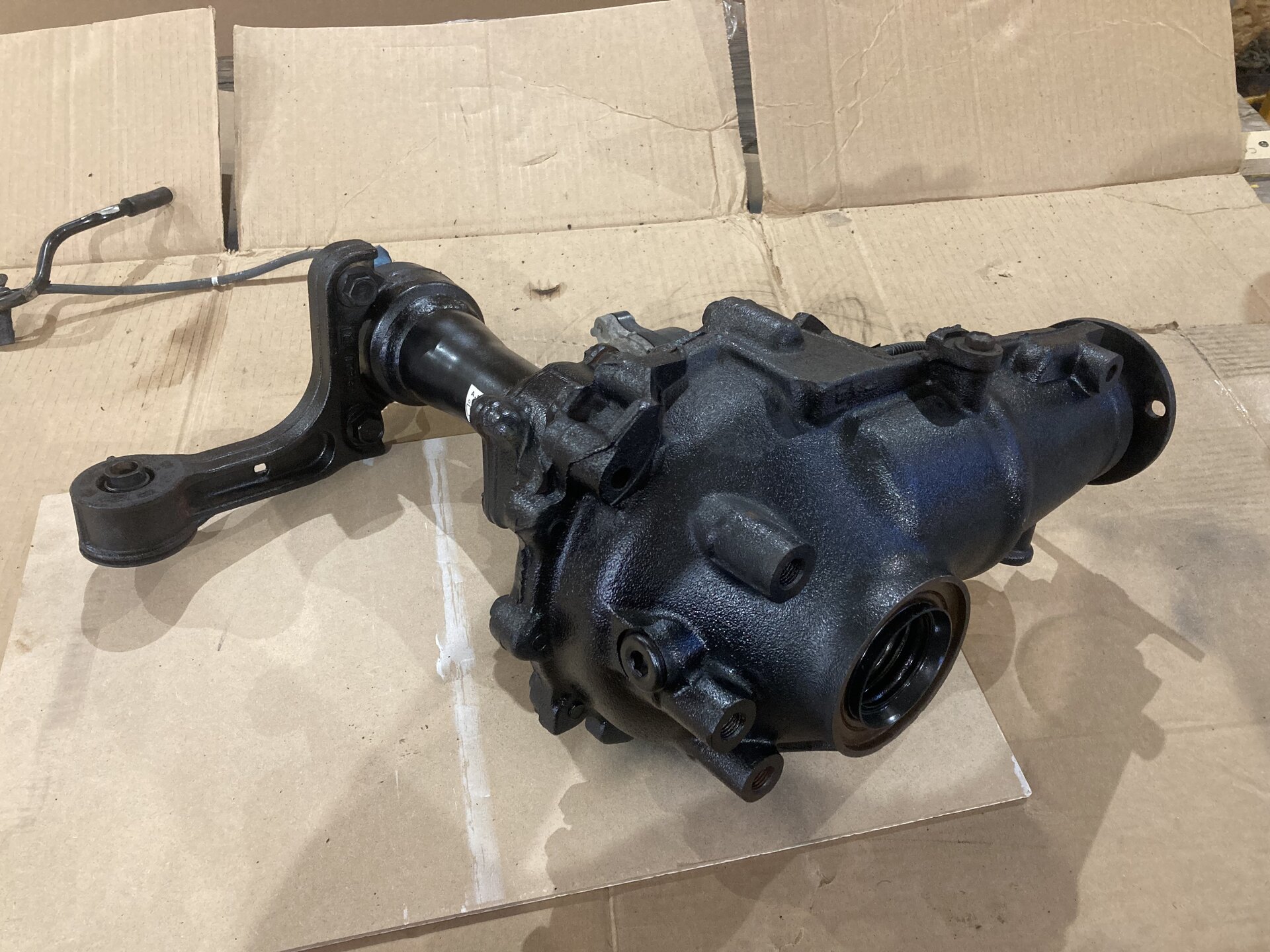

Since everyone likes a follow up, here it is. I ended up getting the full front dif including add actuator from a big parts warehouse. It is a used unit, but when it arrived the gear oil left in it was clean. I rotated the yoke and both sides moved smoothly, and watched ring gear rotate through the drain plug hole. All the teeth looked great, with a normal wear pattern. So I gave it a couple of flushes and swishes, splashed some paint on, and threw it in. Well, threw is a bit of a stretch with the 110* heat here, but it’s now in, and my 4wd functions perfectly!

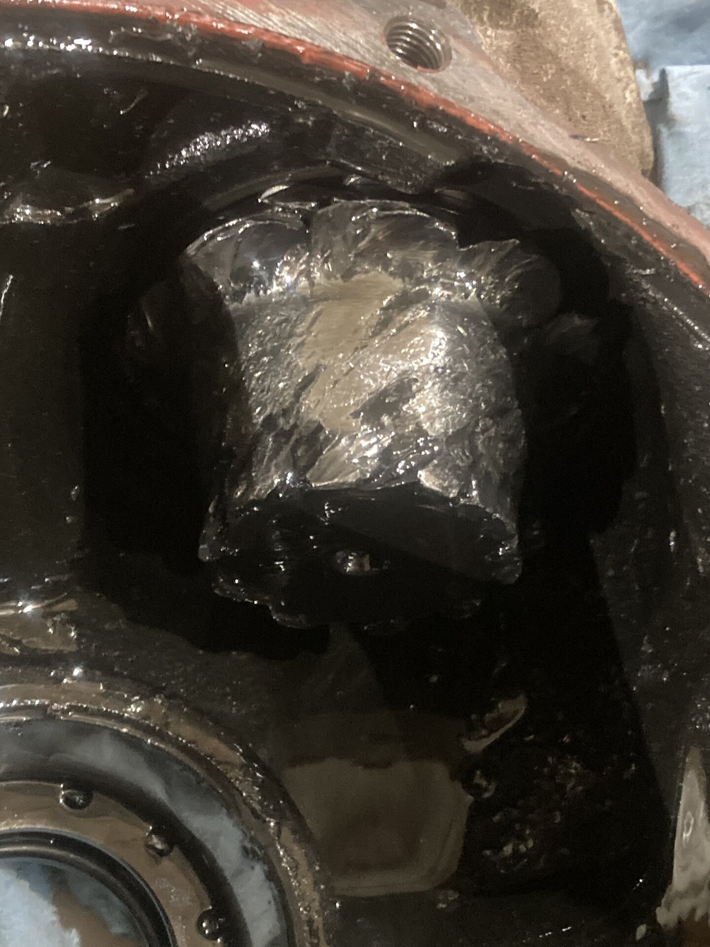

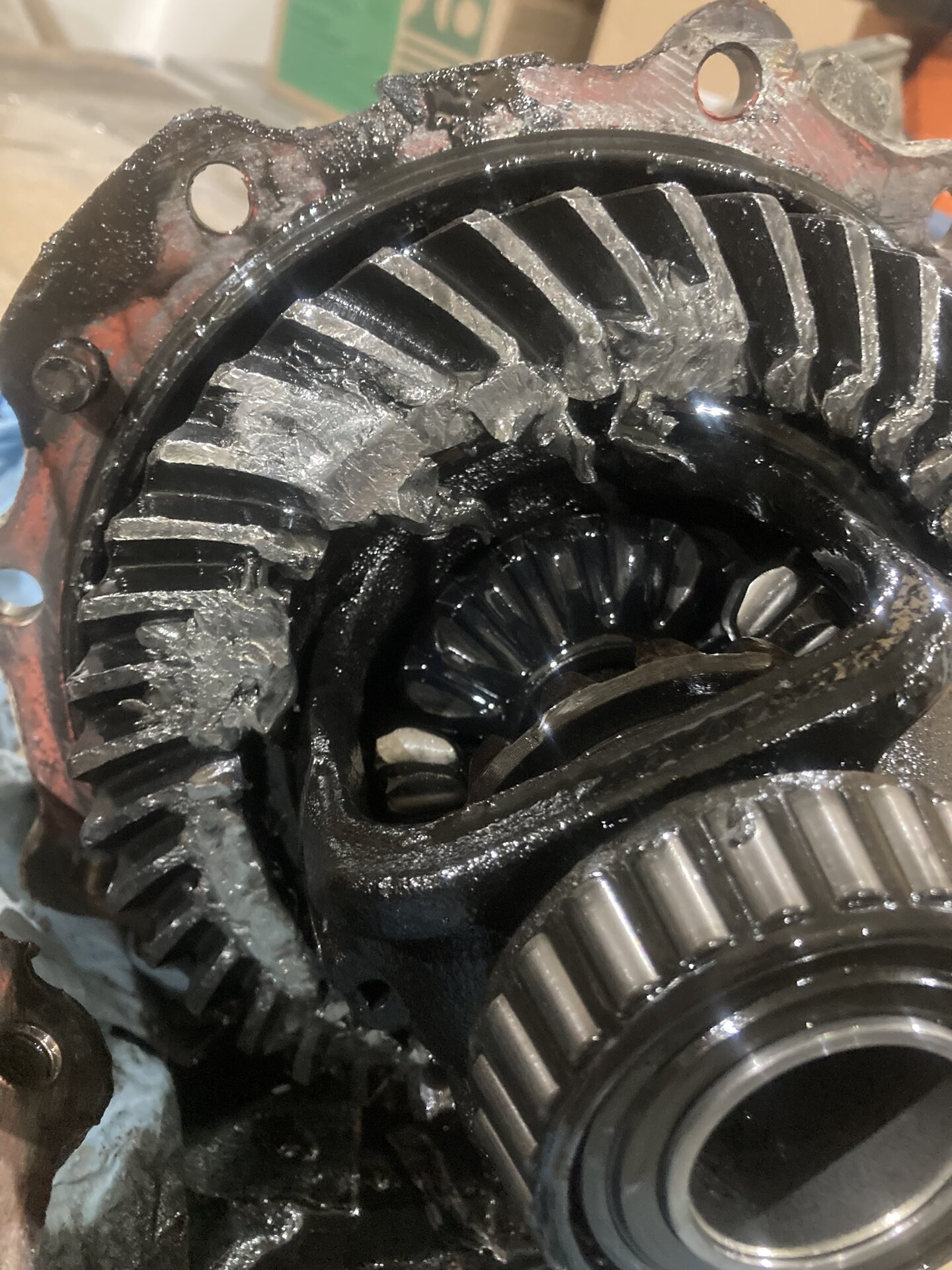

Pics below of the tidied up used one, and the internals of the one I took out that apparently “worked fine just last week”.
Now I’m not the type of guy to get too upset about small repairs, but I do REALLY hate being blatantly lied to. The guy who sold me the truck was trying to get on at a major city fire dept where a friend of mine is a capt. I figured he wouldn’t outright lie to someone who could give a good reference in his new career. Apparently this guy is not honest at all, so I’m glad I didn’t put my neck out and recommend him. There is no room for lying d-bags in my life…

I've never seen such internals THAT bad.

You bet. Piece of cake. It works perfectly now. I kept the actuator off the dead dif and now have a spare.
