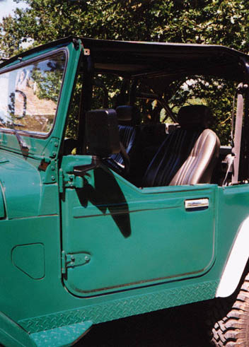

How about making tube doors in this shape? I've always been a fan of how Jack makes his half doors. I think it could be done easy enough in 1.5" tubing, and then using a door mechanism similar to the best top half doors.
I have to half doors for my FJ40, they are a steel frame with black netting in them, made by Deist. I have never seen another pair, but they sure look simple to build.
