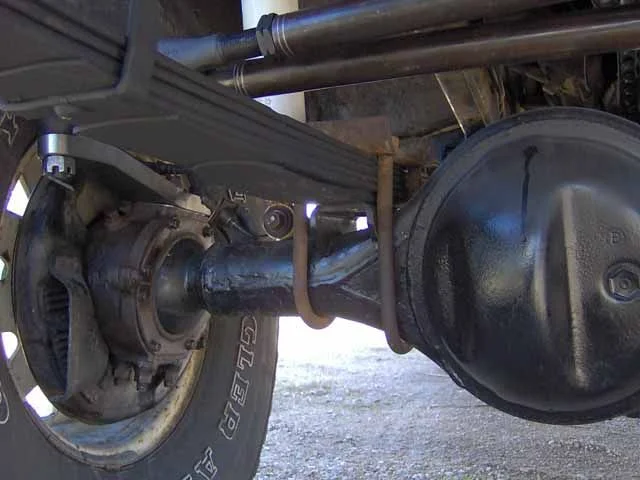

Basically, since the article ran in the Mar / April issue of trails I can post up about how I put a 62 axle under the front of my 55. It is the same process for 40 series guys so this is why I thought I'd post up in this section of the forum..
The purpose of the 60 axle is it has beefier components and it is about 2.75" wider, about perfect for most trucks with bigger tires and or lift. Seems to work well for both SUA and SOA trucks but is much easier to install in a SOA truck IMO. If I was sprung under, I would just do wheel spacers I think... But it handles / works much better than spacers IMO (which I have also run)...
In the rear, it is no big deal to put 60 axles under, simply weld on spring perches to the correct width, a hair narrower because 60's have a wider frame in the rear. No major mods needed.
FJ62's have 4.10, fine splined gears, and 60's have 3.73s. 3.73s are great for highway but are very fast. I installed a FJ62 axle which has some small advantages over the FJ60 axle in addition to the gearing...
In the front it is much more complicated because, when Toyota extended the width of axles for the new 60 series, they did it by adding on one side only, the long side. This, in effect, moves the pumkin farther to the passenger side when putting under a 40/55. You will notice the spring perch is already in the side of the pumpkin quite a bit SOA or SUA, so there is little room to work with to make it even narrower. But that said it has been done. It is ugly but I suppose it could work...

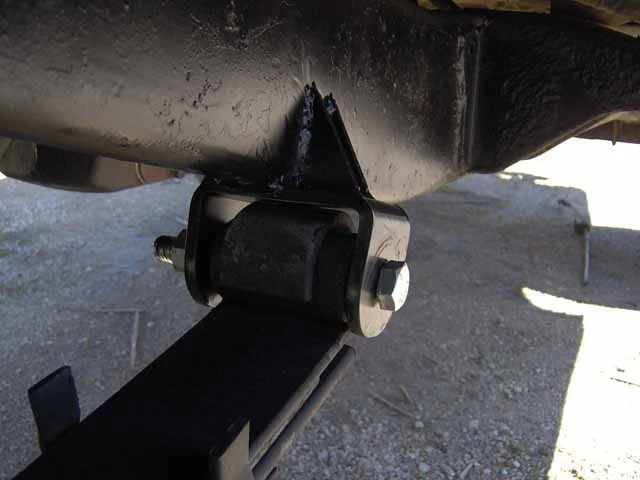

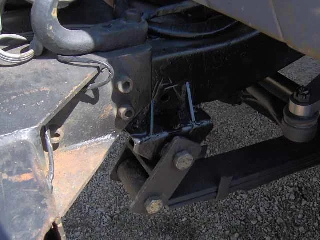

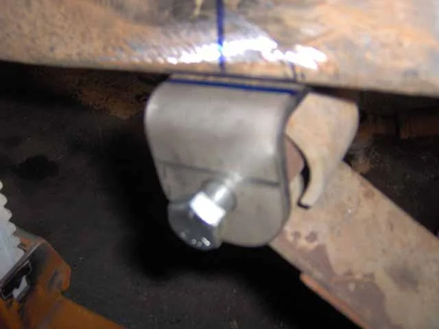

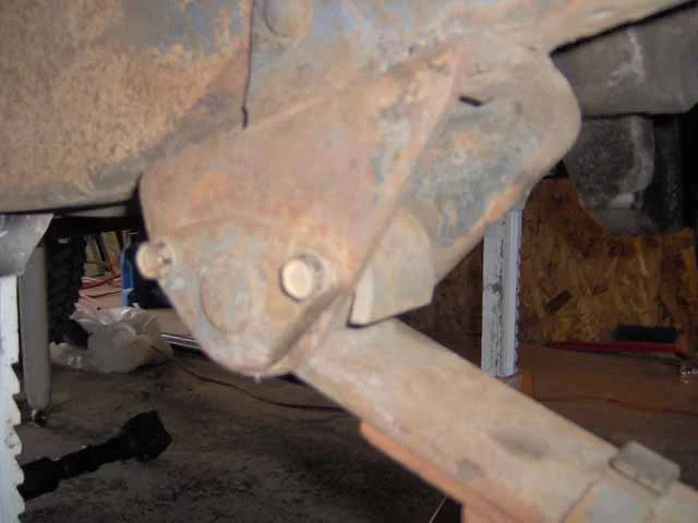

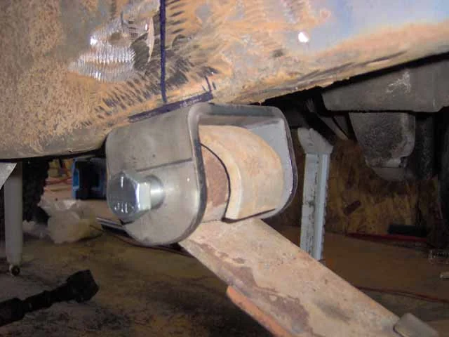

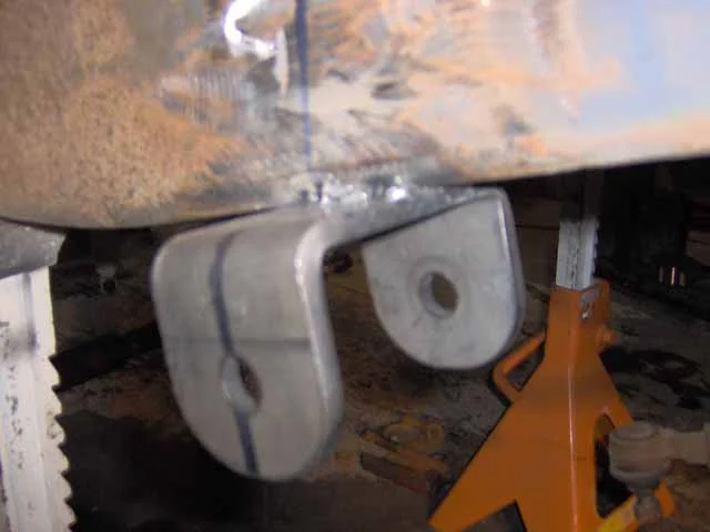

My technique was to use a proffitt's cruisers spring hanger from their weld-on shackle reversal kit. Very beefy and I put this in the rear of the spring. In the front, I moved the factory shackle hanger out about 1.3" wider and inward about 1/2" to get a better shackle angle.

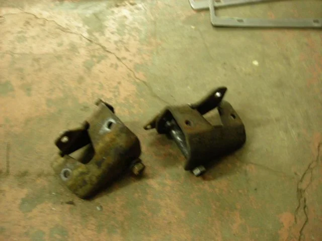

First I cut off the rear hangers:

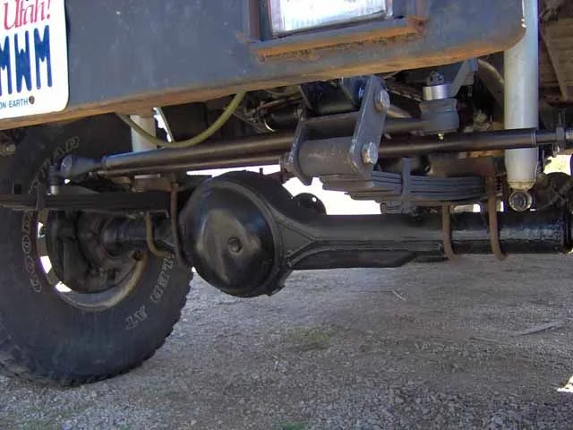

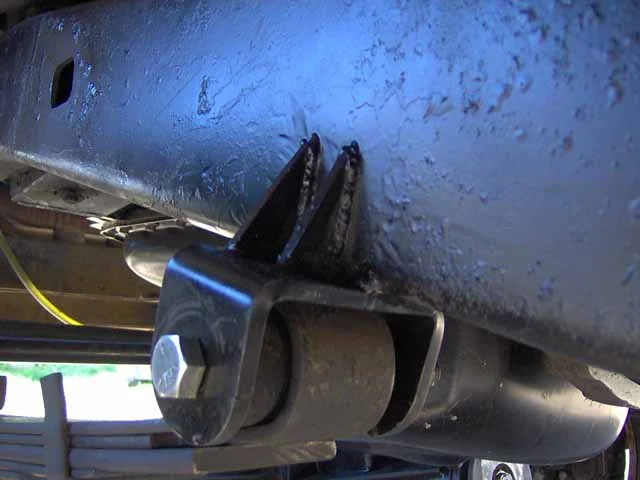

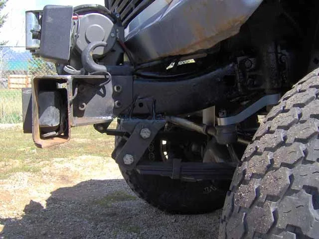

Then I gussetted everything. Places where metal was thin from grinding (suchas the front hanger) I beefed up with a little extra metal / welding. It has held up awesome and should for the life of the rig ( I just sold it about a month ago). I then took it to get an alignment after doing the job and it tracks straight as an arrow...
