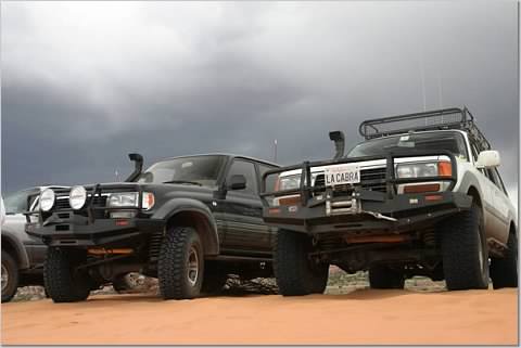

As she looked new to me
47b5ce29b3127cce942887a3b21700000016108BZsmrlm4bq
After lift and front bumper
47b5ce29b3127cce9428879e331a00000026108BZsmrlm4bq
After snorkel, side markers, and rear bumper

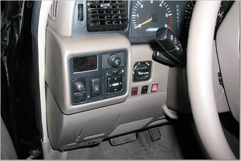

Dash switches, V1 radar detector, etc
switches from left to right (horn air/reg) lightforce lights, strobe lights, dome light, ebrake for functions on navi

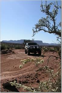

47b6db00b3127cce893d2a953cfc00000016108BZsmrlm4bq
Lockhart bason trail going to CM

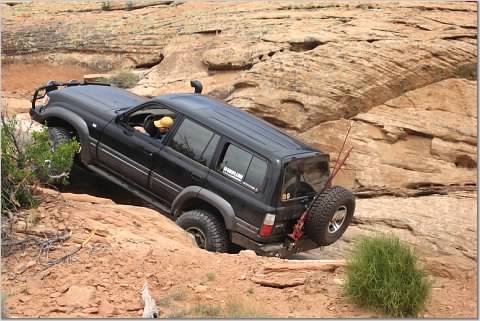

47b6db00b3127cce893d4a993cc000000016108BZsmrlm4bq
47b6db00b3127cce893d4a84bded00000016108BZsmrlm4bq
47b6db00b3127cce893d4aa8bdc100000026108BZsmrlm4bq

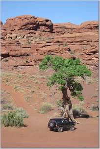

Behind the rocks
47b6db00b3127cce893d4a8d3cd400000016108BZsmrlm4bq
Dad and his cruise on the left
47b6db00b3127cce893d4a94bdfd00000016108BZsmrlm4bq
47b6db31b3127cce88a308cfed9f00000016108BZsmrlm4bq
47b6db00b3127cce893d4a96bdff00000026108BZsmrlm4bq

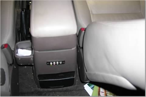

Here are a few photos that were requested and that I forgot.

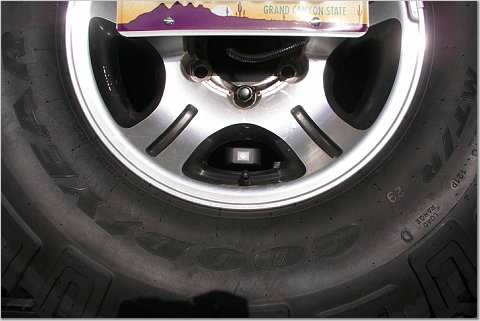

This is a picture of the location of the rear camara, very stealth
47b6db03b3127cce8923bbce153400000016108BZsmrlm4bq
this is the custom mount for the rear JL components
47b6db03b3127cce8923b952949900000016108BZsmrlm4bq
The Amps are located in the passenger side rear panel and consist of a JL 500/1 and 300/4, as you can see it's a bit tight.
47b6db03b3127cce8923b89755f400000016108BZsmrlm4bq
Here are a couple of pics of the rear subs. They are 2 JL 10w3v3 subs in the tailgate being fed by the 500/1 amp. I like the setup, and could think of were I would put them else were but it does make the talegate heavy, and the height the setup makes making a drawer system a little harder. But they sound GREAT!! and are very much out of the way. To make this possible 1.25" was added to the depth of the tailgate. Also in these pics you can see the start of a drawer system that I threw together in an afternoon before we headed to moab. In the current for it worked great for the trip but needs to get finished. Also because the sides havent been made in slid backwards on Hummer hill and dented the sub grills.
47b6db03b3127cce8923b860d43300000016108BZsmrlm4bq
Showing added depth
47b6db03b3127cce8923b825554600000016108BZsmrlm4bq
