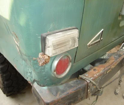

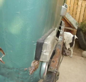

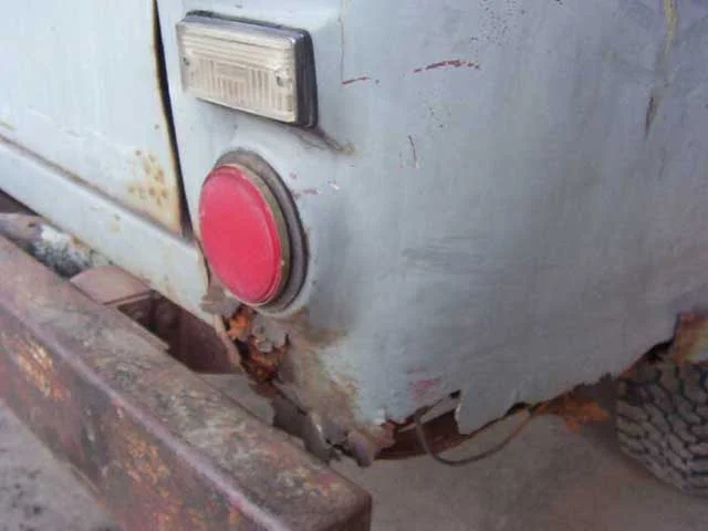

Any pics of the reverse lights?
sorry i didin'tget pics up sooner...this is what you need to find
Pablo - the tailgates lost the indent/recess (where the TOYOTA is stamped) that coincides with the early tail-lights ....after 77. Just compared a 71 and a 78 at my homestead and this appears to be the most significant difference structurally. If you dig up Buckethead's thread, the PO of his pig transplanted a 78 into a 71 with no dilemma - however, because there is no recessed upper section on the 78-80 tailgate, it will not line up with the depth of the early rear lights(cosmetic only) Long story short - from what I have gathered - all may be interchanged and functional - just differing visually. I may stand to be corrected :grinpimp:

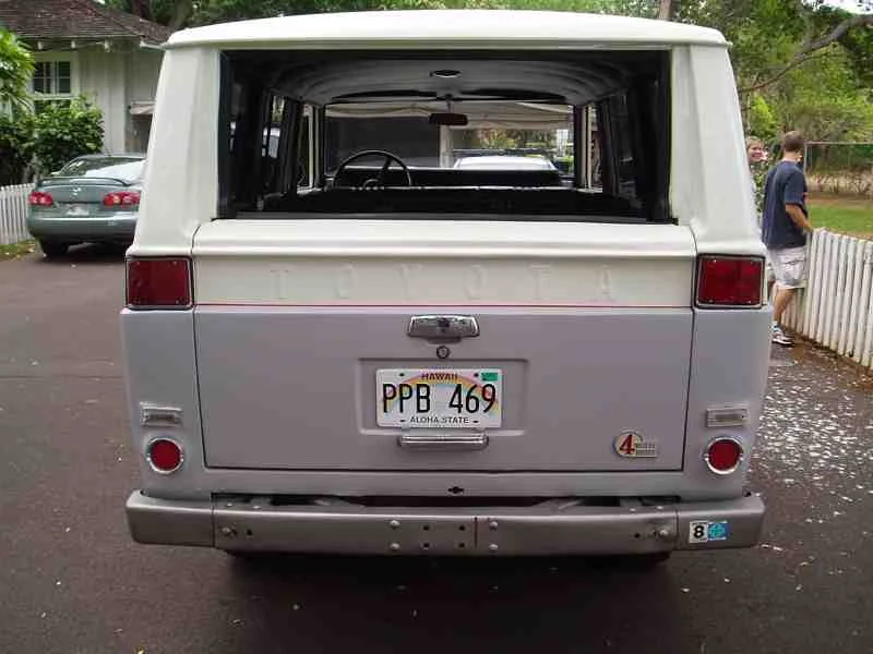

Tail Lights
Here's my 12/71 rear end.
