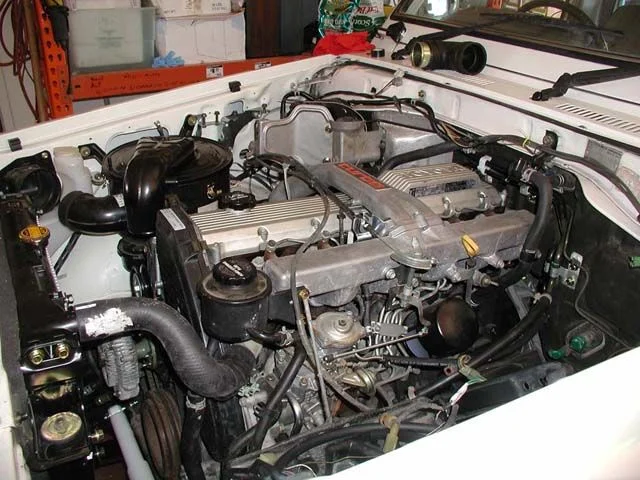

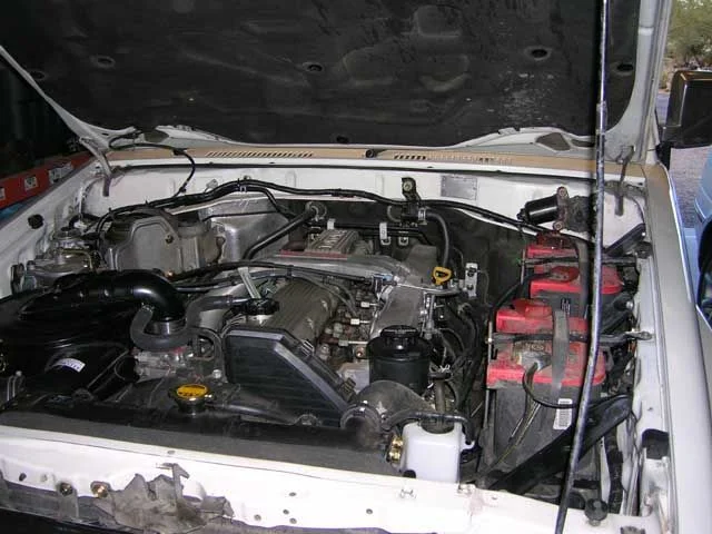

Received your pics, Rick. Here you go. 1HD-T installed. :beer:
