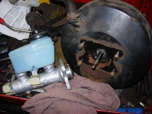

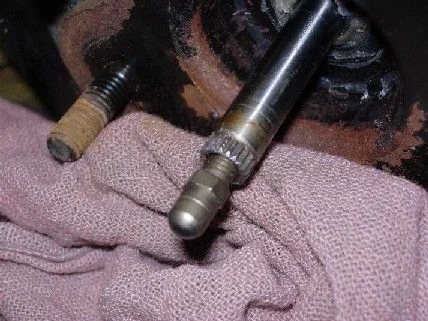

Alan-
Is this piece similar to what you are having troubles with adjusting?
This is a 1987 booster that I had at the shop, with a disc brake master cylinder from JTO...

Steve, yes! That is exactly the piece we had trouble adjusting. Thank you for going to the trouble of taking pics!
