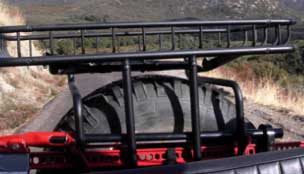

anyway, as seen here at the rack, it is an Outland brand "Trail Rack" meant for Yeeps that is mounted to my Con-Ferr swing away rear rack (that was a modification effort in itself). I mounted these up under the Trail Rack between it and the spare tire. So, still 100% access to rack, tools, tire.

I like the way that rack sits, how much weight does it hold?
they claim 200 pounds! here is a picture of the actual rack (not on my rig mind you).

Great looking cruiser, can you send me some more pics of the rack (chadtrs@nc.rr.com) I have the same rear tire carrier and would love to put that rack on mine. Did you fab up the mounting poles? Any other cool mods you have going?

here are a few images of it so you can see 1 aspect of how I mounted it. I used the stock rack, on then on the Con-Ferr I drilled holes to match those from the Outland and just bolted her on. pretty straight forward.
