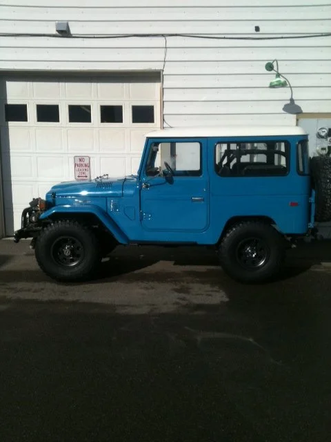

so i basically have this system installed. it is the downey one though. it runs horrible. from what i have read on here, i need a custom prom burned to make it run right. i am looking for some one with a burner who can sell me one or burn mine for me. any ideas?
here is a pic of my rig
oops. wrong orientation.
