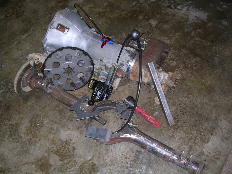

this is my pile
with a bit of luck, this could be a productive weekend....

Looks like you forgot one shifter for the t-case. I am also amazed you spent for the bing alum AN fittings and not cheaper JIC steel stuff. :)
Lomax 4:1 kit for the t-case is shipping next week, twinsticks and the rebuild kit shipped this week. Still waiting for Novak to get off their dead useless ass and get their <bling> super short 32-spline rear output made....latest phone call said Jan 15....course, it was released in the rags Oct 2003 and hasnt been produced yet.
Tom Woods left me a voice mail and email this evening, gotta ring up tomorrow and discuss...believe Cruiser joints in the rear and 1310's in front (like I have now), small diameter front shaft, just gotta get new flanges on the t-case.
bolts for the flexplate (d'oh) and the fan/cooler for the tranny ordered tonite.
upper link plate and tabs are on the housing, just need to triple check angles prior to burnin 'em in hard...and see if my change for the leaf shackle will work or not.....
Tranny plan is clearanced for a driveshaft, linkage stuff for the AC cable is on.
beer is next....:beer:
I had to look twice at the birf to see what it was. It looked like you left one of your sex toys in the middle of the pile. :D

All I did for the trans pan was take my 4-1/2" angle grinder with a sanding disc and grind off the lip until it was flush with the alum casting. Nothin fancy...real test will be when it's installed in the rig, see how the d-shaft will align up.
