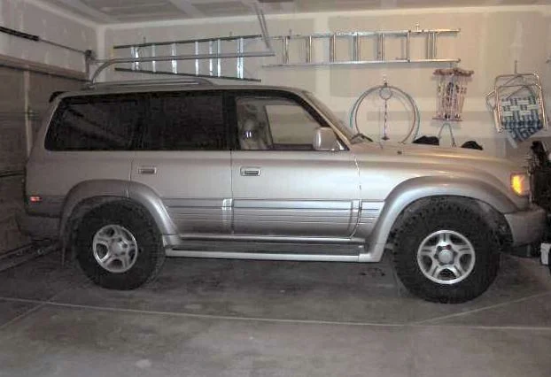

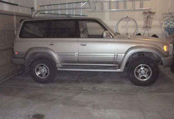

Here are some before and after pics of the lift. I am running 285's
As far as the dip stick thing, Cruiser Dan cleared it up when I was ordering the front axle parts kit just now. He stated that you can take a piece of metal or wire and stick it in the access hole on the top to see the level AND consistency of the grease. If its runny (Which mine was) then birf greese and axle fluid has probably mixed and it needs a rebuild
