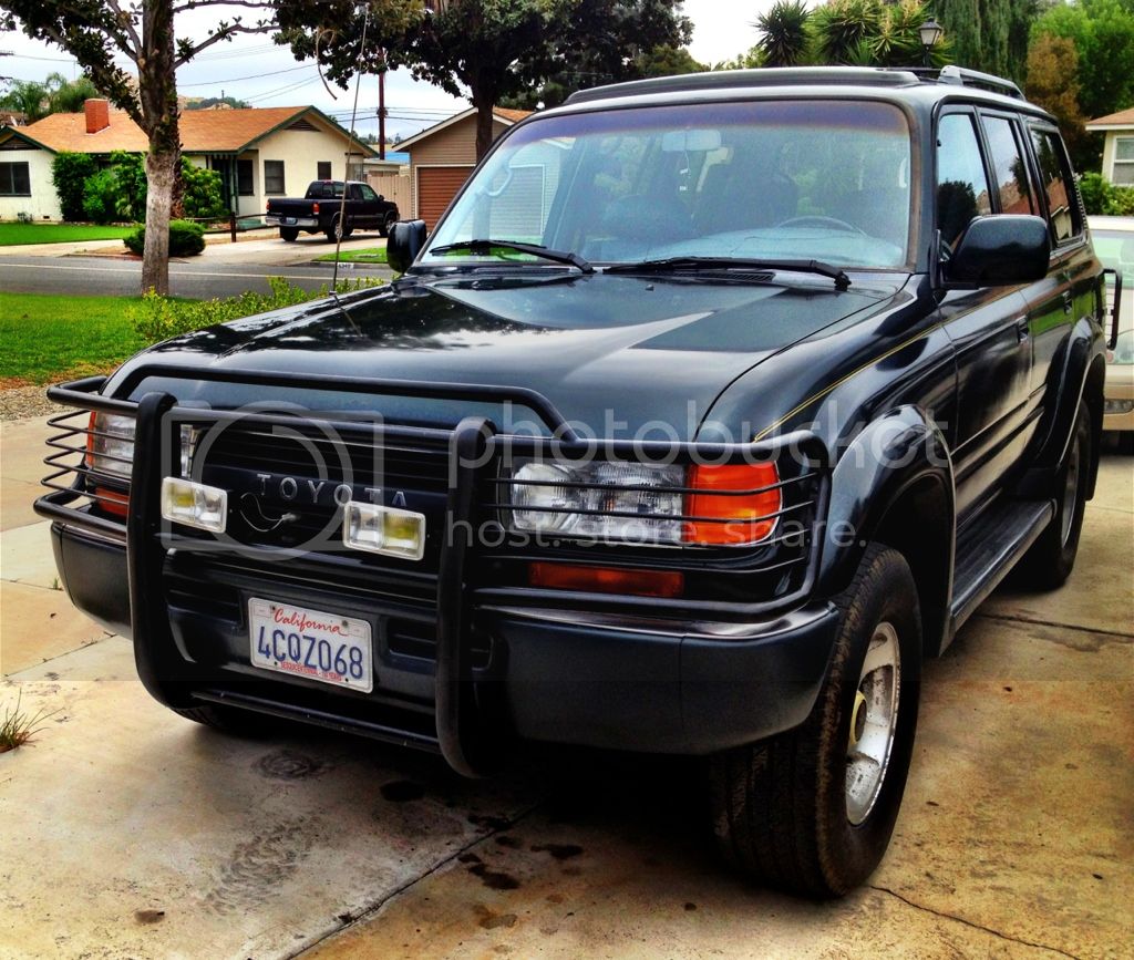

So I picked up this fairly clean 94 from a couple kids who had no clue what a land cruiser is. Every inch was covered in some kind of Armor All type product. It made me greasy every time I touched it. And the smell. I still can't get rid of the smell. May have to pull the carpet soon. You can smell it from a foot away.

This is when I brought it home. The gas door wouldn't open, the handle on the tailgate was broken, the driver's side wiper didn't work, etc. When I was test driving it I wanted to see if all 3 lockers worked. I put it in low range and the center diff lock worked but the front and rear lockers didn't. No big deal, probably just dirty. Tried to shift it back into high range and nothing.
Ruh Roh. :whoops:
So I did what any upstanding citizen does when he breaks a car during a test drive. I low balled them. Got their $4500 cruiser for $2900. It was given to them and they seemed like they just wanted cash to get more meth.

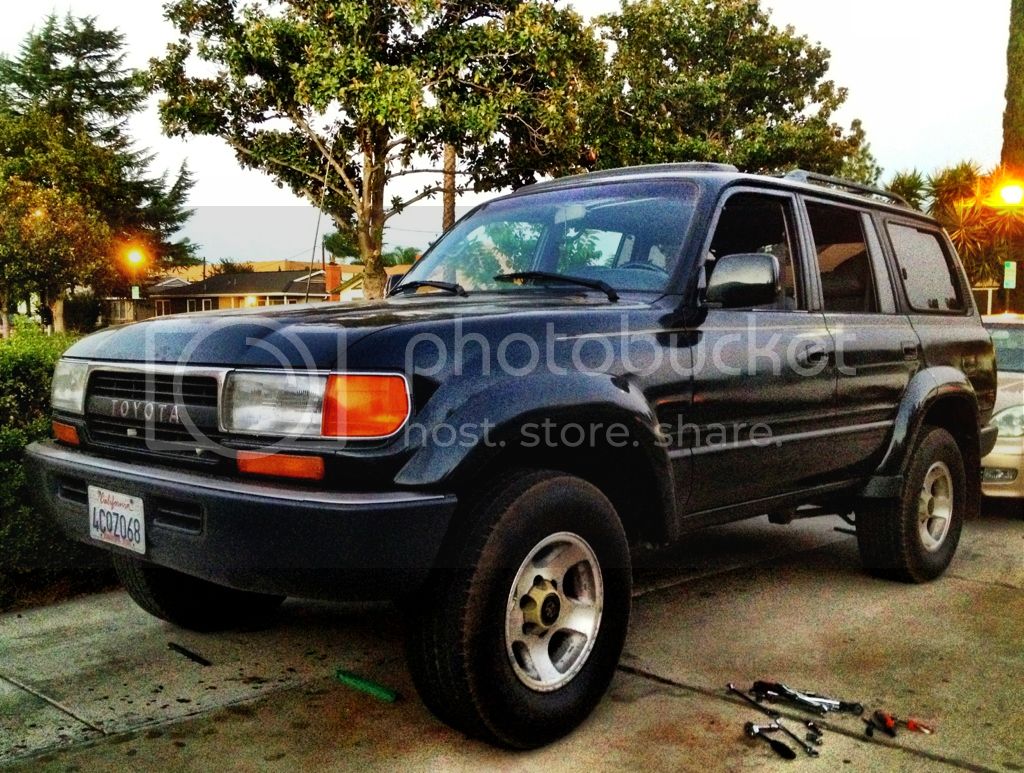

So first things first, get rid of the "armor":
http://i680.photobucket.com/albums/...-BC8F-362883E4A114-45185-00001AC15683F405.jpg
There, that's better. I took it to a dirt field and drove around like a fool for half an hour trying to get the center diff to unlock. No luck. The rear diff lock fixed itself when I was doing figure 8s.

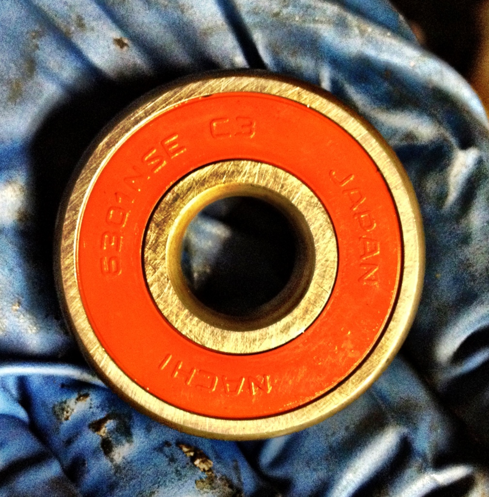

New Koyo bearing for the AC idler pulley from eBay.

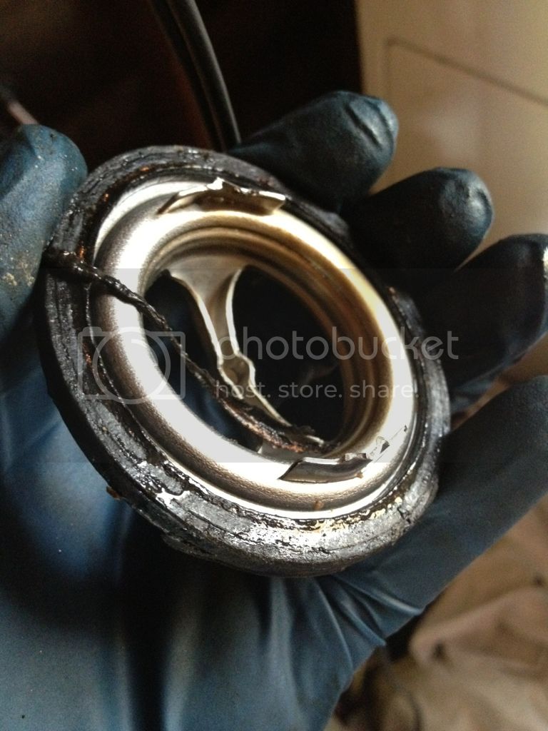

Dug in and found this gem:
http://i680.photobucket.com/albums/...-91E0-059A5272F1FF-45185-00001AC112DD7DCD.jpg
Neat, huh?

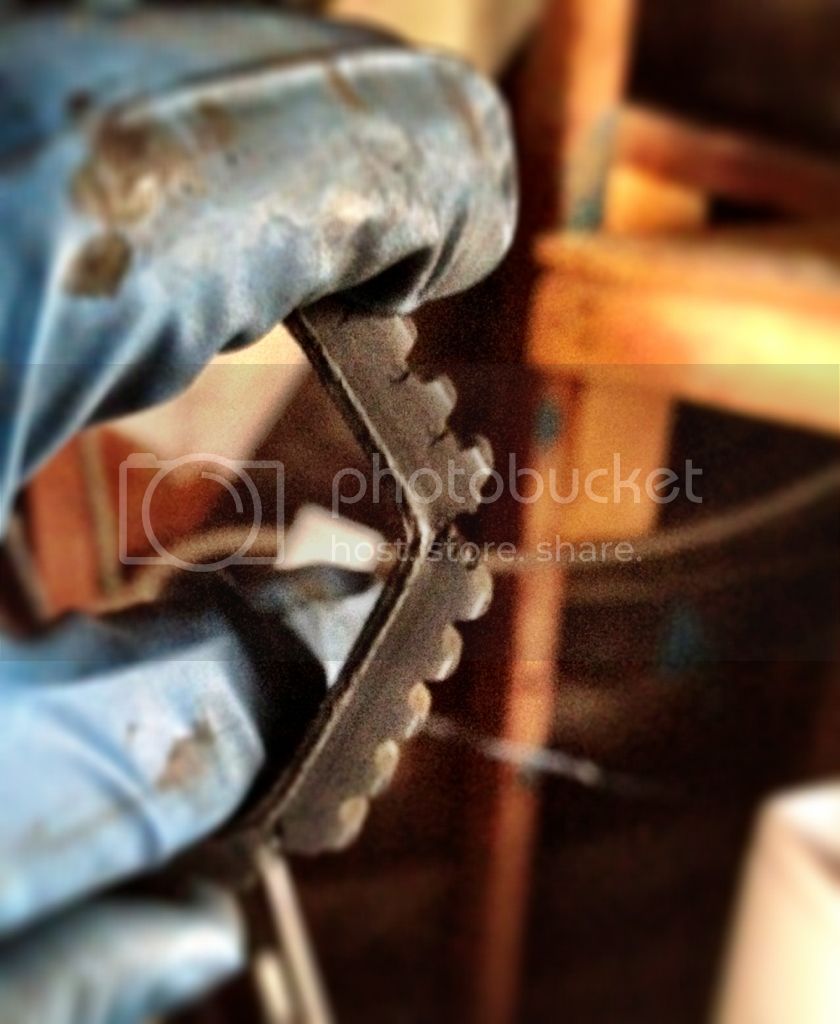

Fine Korean belts:
http://i680.photobucket.com/albums/...-9392-C5890EF561C0-45185-00001AC1C4BC6ED8.jpg

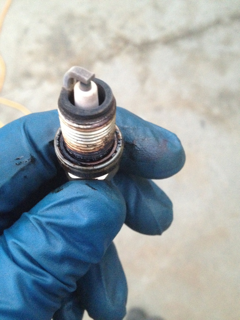

1st five spark plugs were unremarkable Densos:
http://i680.photobucket.com/albums/...-B219-157EDA25F649-45185-00001AC1A15FEB5B.jpg

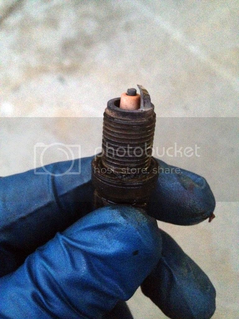

#6 was an NGK and probably original:
http://i680.photobucket.com/albums/...-AD6F-60B9EFD160A4-45185-00001AC1B1FAE810.jpg
I guess that explains the slight miss at idle.

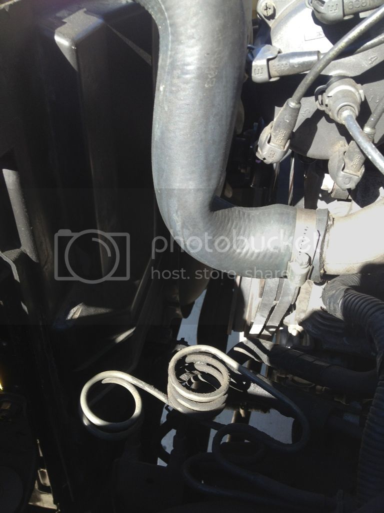

Gotta love the amazing fit of aftermarket hoses:
http://i680.photobucket.com/albums/...-935A-B8D4FC961856-45185-00001AC1A899B1C0.jpg
