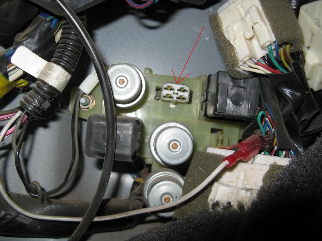

Wanted power to my windows and sunroof without the need of the key on.
3 step process once the drivers side kick panel is removed.
Step 1 - Remove the relay (noted by arrow) just pull
Step 2 - Make spade jumper
Step 3 - Install jumper as pictured
Now windows and sun roof work without key on
I tested for a phantom load and measure less then 1 watt = no problem

Will this be essentially the same (location/appearance/etc.) on a '91? (I'm assuming you have something newer, because it seems everyone else does :-) )

Any plans to make this switchable with a dash on-off switch? I spoze it's no different than having manual wind-up windows that work all the time ;)
Awesome. Done. One of the most useful mods ever.
