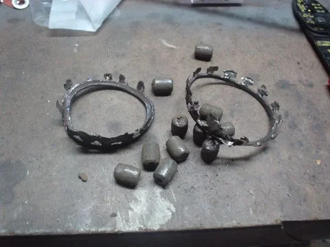

Well I finally got the thing torn completely apart and most everythin looks okay.
The one thing that was interesting was when I was trying to press the bearings and gears off the rear output shaft I had some trouble. I was thinking that my 12 ton press wasn't enough or that there was an unseen spring clip. Turned out that the rear out put shaft bearing (or what was left of it) was seized to the shaft. Since I am using the Man-E-Fre parking break kit ($ouch$) I was not too concerned about injuring the shaft, only getting the gears off.
I put heat on it and tapped it with a hammer and sprayed it with blaster and nothing. So I started grinding the bearing as I figured it must be seized.
Finally it did what I expected - POW! The bearing gave way and the thing came apart. Took forever to get to that.
Here is more carnage:

Next I pressed out the idler shaft (it is garbage as there is one in the rebuild kit) and removed all the other seals and a seized broken bolt from the case.
