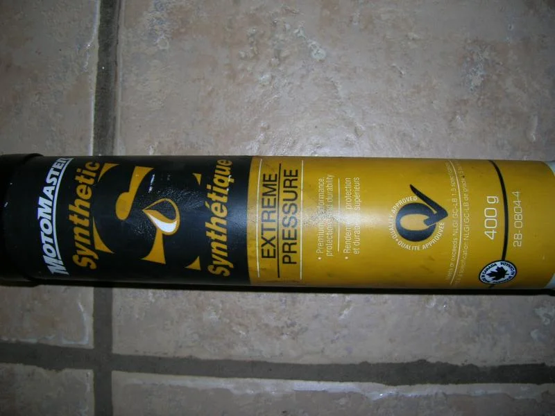

I recently re-built my Warn M12000 and used this grease. The Synthetic wasn't too much more $$ than dyno. I think the grease that was in it prior to the re-build was from 1986! (Not much left and pretty sticky).
Motomaster is likely only available in Canada and is your 'name-brand substitute', I certainly don't claim its better than the Shell varieties, but for me, easily accessible.

AJAE,
I would assume that it shouldn't be brand specific as long as it meets or exceeds the standards for that type of grease/application. In this case being high pressure grease.
