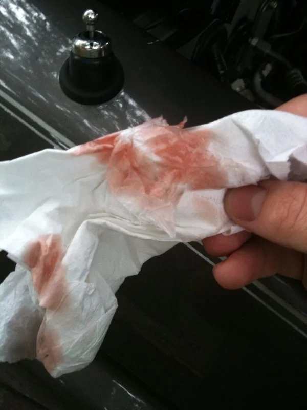

i've checked the tranny fluid a few times since i purchased in january, and it looks normal (also looked okay according to my mech who pulled the dipstick before i left). i checked it after driving a 150 miles on the way here, and it looked alright. check out the attached which i snapped just now (it shows a little cleaner in the pic than what it really looks like). if there's any gear oil in there, i imagine it is a very small amount.

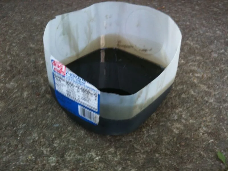

the oil was not foamy. see pic. this was drained after sitting overnight - the fluid was cold.

i will change out the oil today - heading back home tomorrow.

the tranny flid will not hurt the transfer
It cost me around $600 to have a dealer replace this seal. Mine failed in the middle of a long distance move and failed badly dumping lots of fluid on the ground - although I am sure it failed gently for a long time first. My first indication was the rear seal of the transfercase giving after the transmission dumped several quarts of ATF into it. This is what will happen if you ignore this for too long. I would get it fixed, or fix it quickly yourself.
