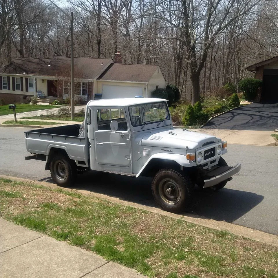

The reason they cut your bib is because they used a 70 series PS box, and the arm is to the rear. If you use a 60 series box then the arm will be at the front. The advantage is twofold.
1. The 60 box is mounted further rear behind the bib, allowing you to run a full bib.
B. The arm faces forwards, giving more clearance.
There's too much happening back there at present. Two links, the arm, the diff housing. It's too messy. Swap the box if you can.
