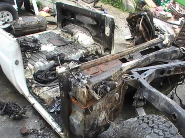

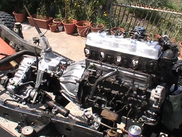

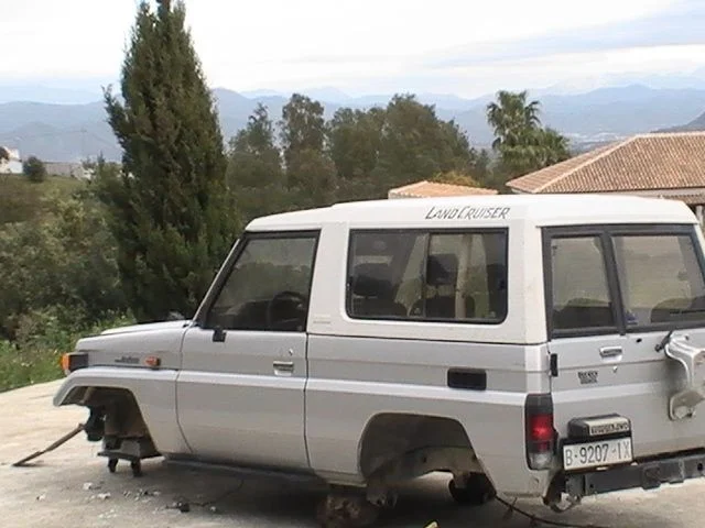

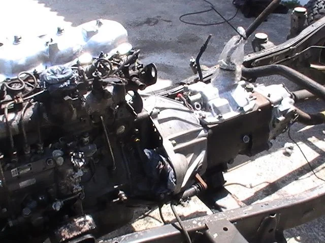

This is the project im bussy with the coming time,combining a new clean 12v body with a 24v engine and shassis;
the last picture is the burned body.

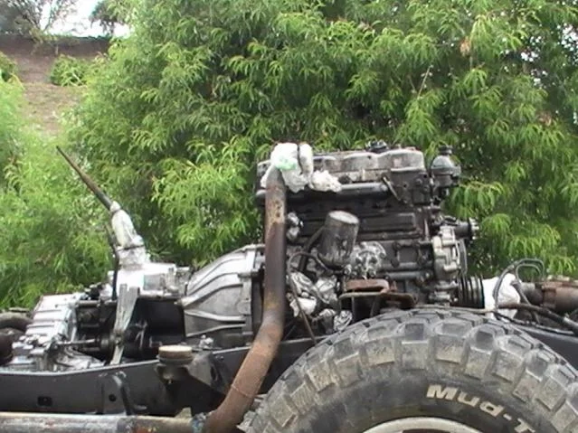

The 24v alternator is also burnt so i think the most easy way to get this 12v-24v combination alive is;
to just use a 12v starter and alternator on the engine ?
Am i right ?
(tips and advise more then welcome!:wrench:!)

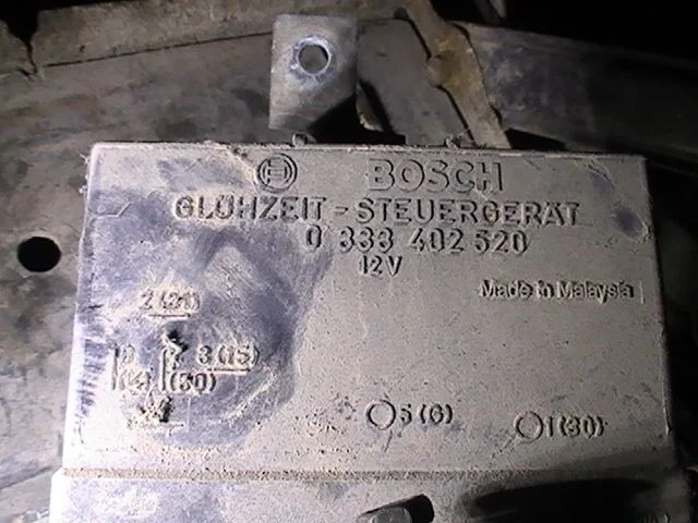

Depending on your glow system (manual glow or super glow) you'll have to replace the glow controller for manual glow or the timer unit (and or glow screen) for super glow.
If you have an EDIC system (engine shut off with the key) you'll have to replace that unit too.
Just saying,
Rudi

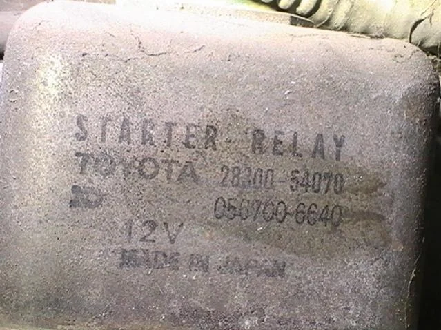

If you put 2 batteries in series you'll have 24V.
That's good for the engine but now you have to change all the 12V parts. Lightbulbs, heaterfan, etc, etc, all the other electrical stuff.
Why not transfer all the 12V stuff from the old engine to the new engine?
Rudi

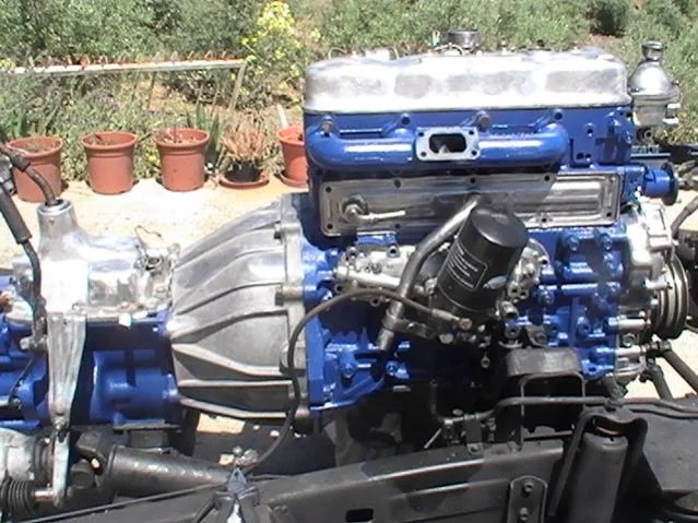

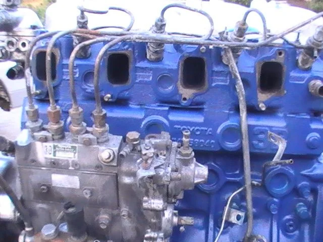

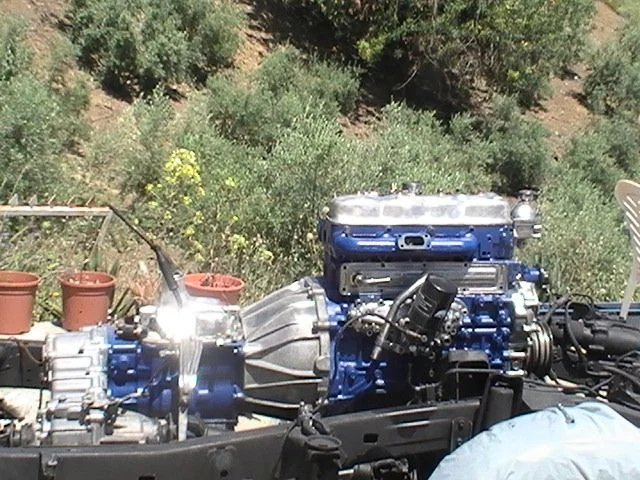

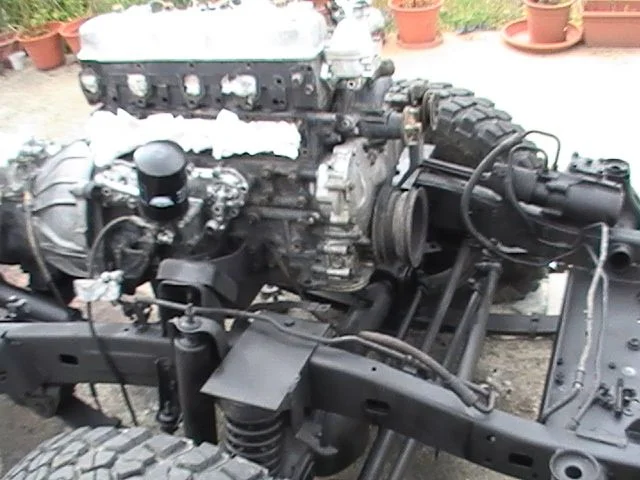

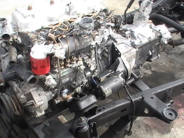

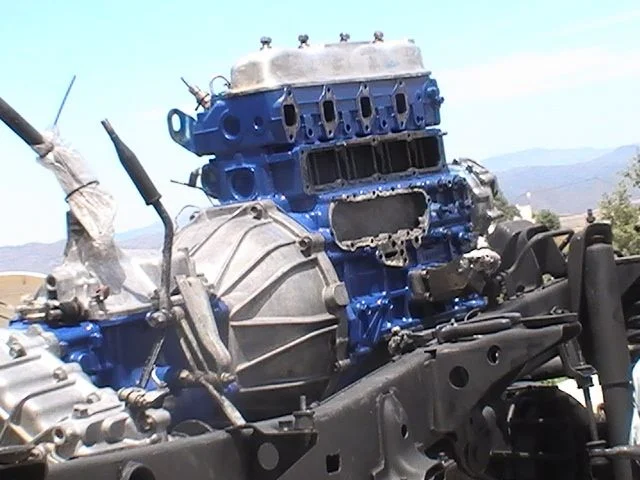

So the 12V shopping list is;
Starter, Alternator (with vacuum pump?), Glow plugs and EDIC system.
Am I missing something?
Rudi

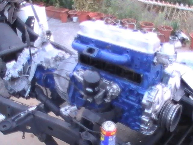

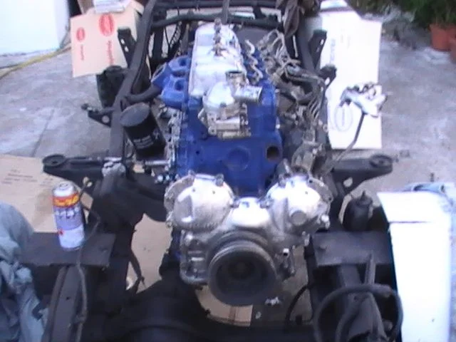

Got a 12v starter motor(valeo) and gonna mount a terrano II 12v alternator with vacuum pump

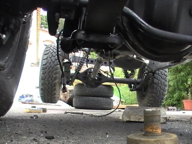

Also put antioxidant paint on the chassis which i cleaned with Industrial degreaser and hobby pressure wascher

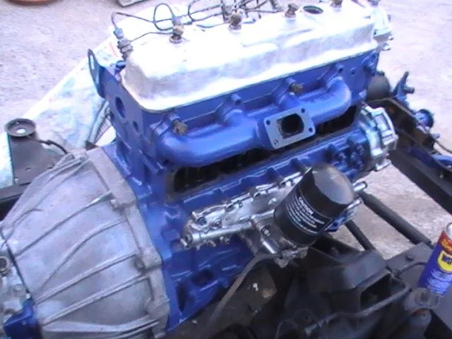

picture update;
