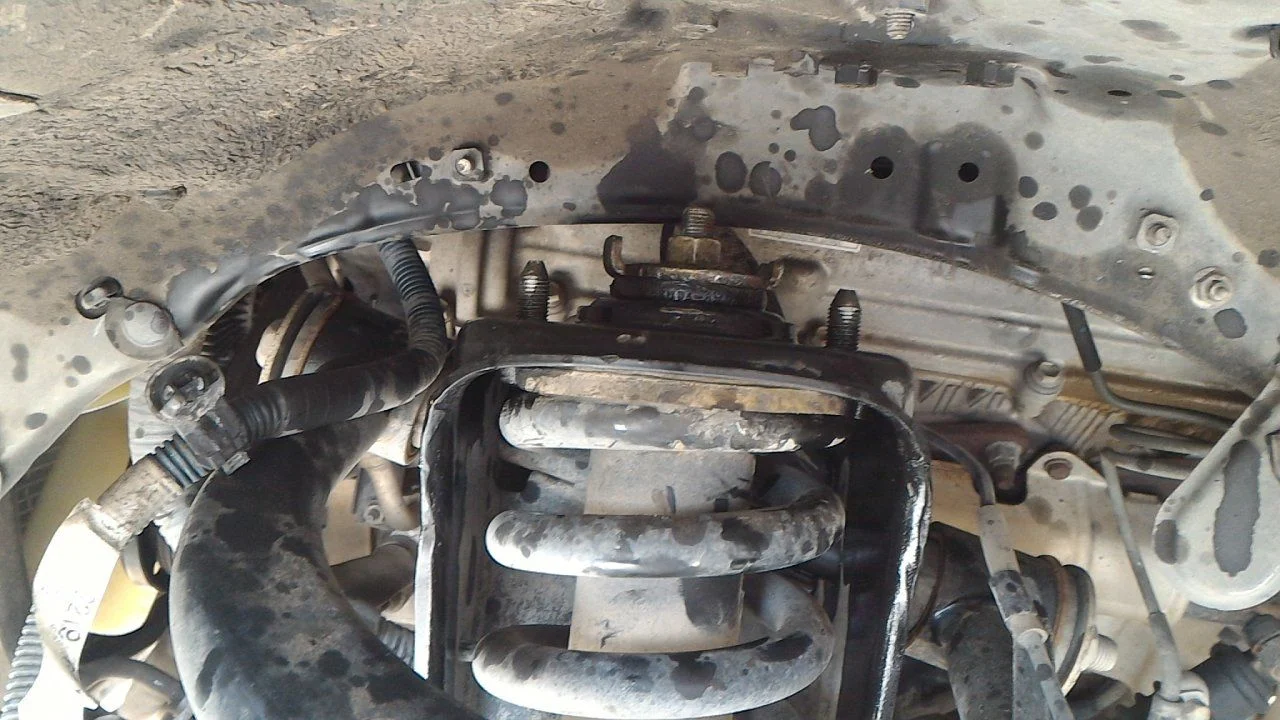

trying to install lift now. the front coil over is stuck from the top. any idea on how to break it free?
Mine were stuck also. I tried everything I could think of. I am sure there are other ways to do it but I drilled a small hole in the fender over one of the studs, placed a punch on top of the stud and hit it with a hammer. It came out pretty easy.trying to install lift now. the front coil over is stuck from the top. any idea on how to break it free?
