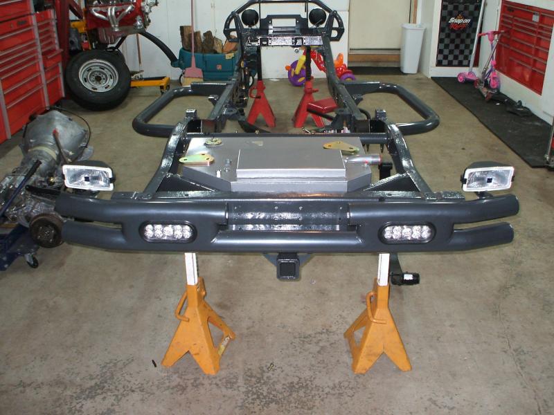

frame pictures
this is what the frame looked liked after the powderkoting was done. i also receased the rear and front lights in the bumpers and powderkoted them also.

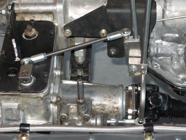

more drivetrain
here are some more pictures of the drivetrain. i put an aa twin stick shifter in. also transfer case saver. everything is steel braided lines. russell fittings, alumiun rad. trans cooler.

i know i have to lower the sticks for shifting or else they might end up somewhere i dont like

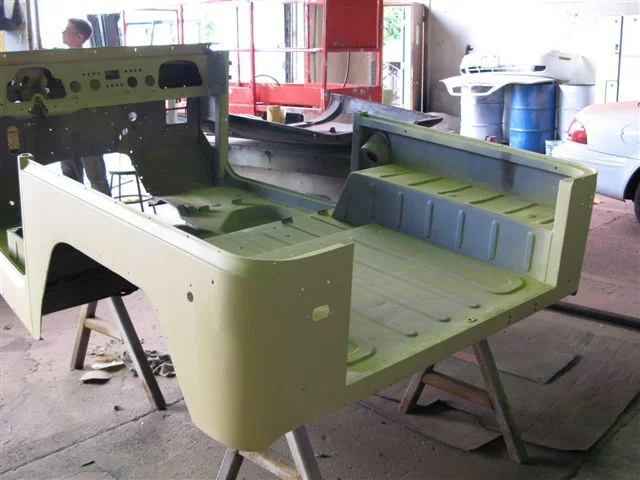

body and paint

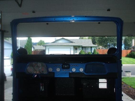

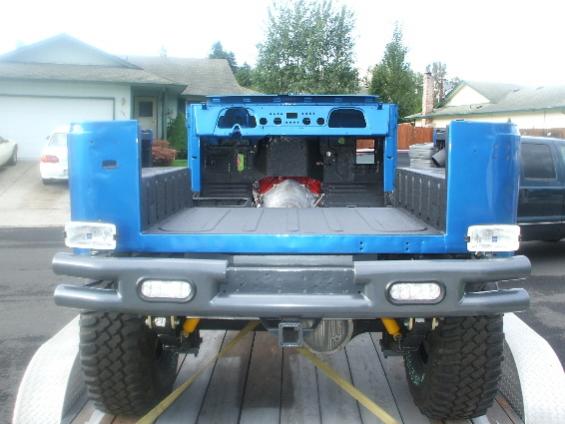

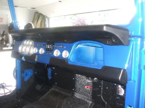

here are some pictures of the body and paint after i shoot it blue. the paint is from a toyota tacome blue. its speedway blue met. i lined the inside and the underneath. also i welded up the dash and put my own holes in for switches. auto meter guages. this body is not the black one it is another one i had

cool blue
now after paint. i painted it speedway blue met from toyota. also lined inside and underneath.

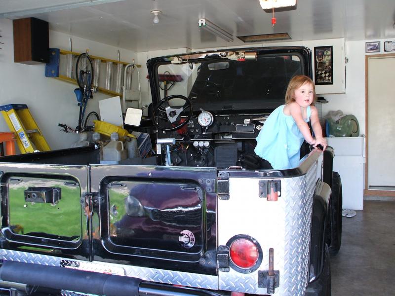

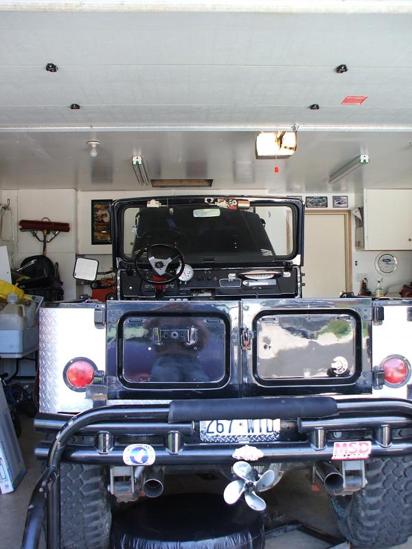

a few more pictures. i thought i would take it out for a drive. it needed some air
here are some of the rear with plate. yes it does look like too much but i wanted the tailgate with storage. i will fix it by putting a swing gate on it with the spare tire and gas cans that should hide some so it wont like like alot
