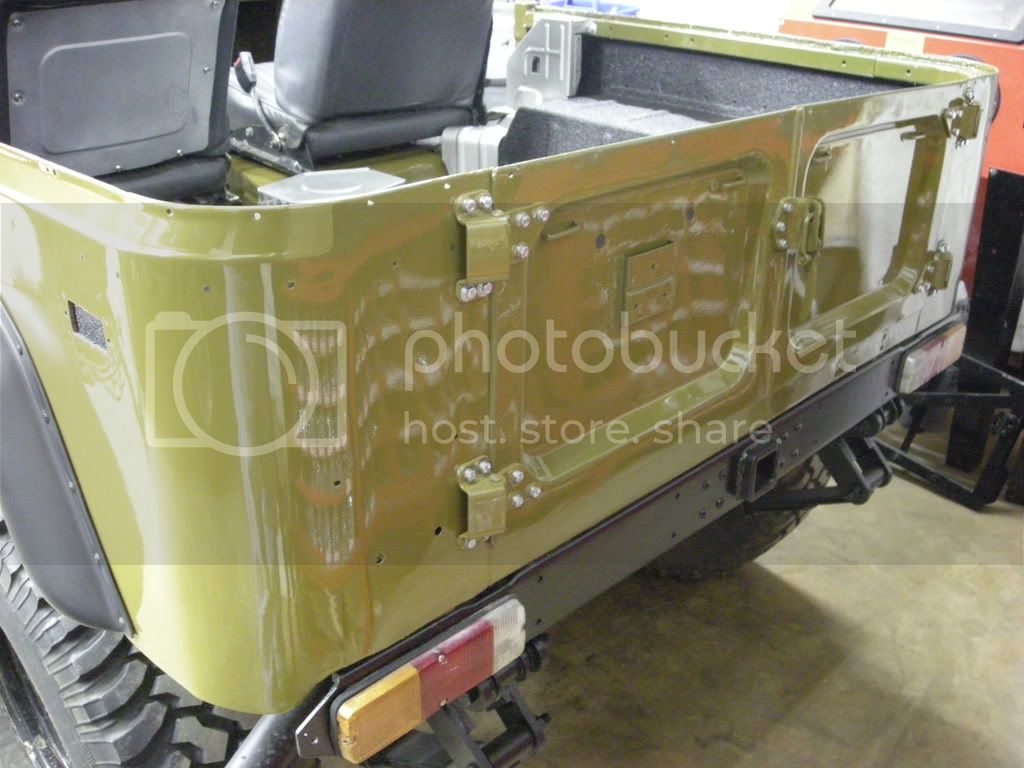

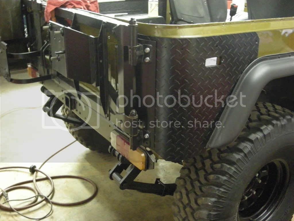

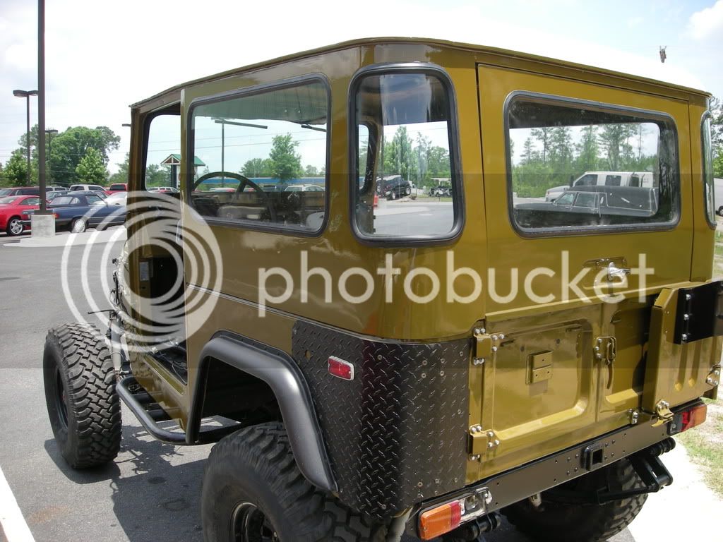

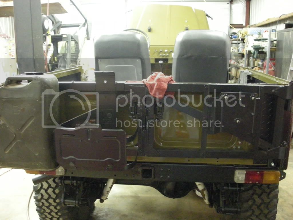

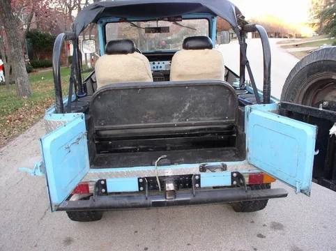

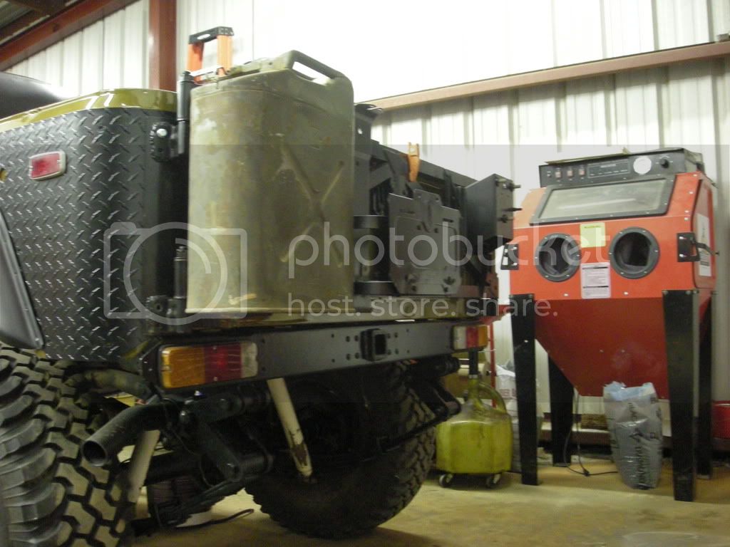

All I plan on towing is a snowmobile or 2. I probably shouldn't be to concerned with this anyway. The bumper will be similiar to this. Main tube is 3.5x3.5 square, .25 wall. Opinions?
