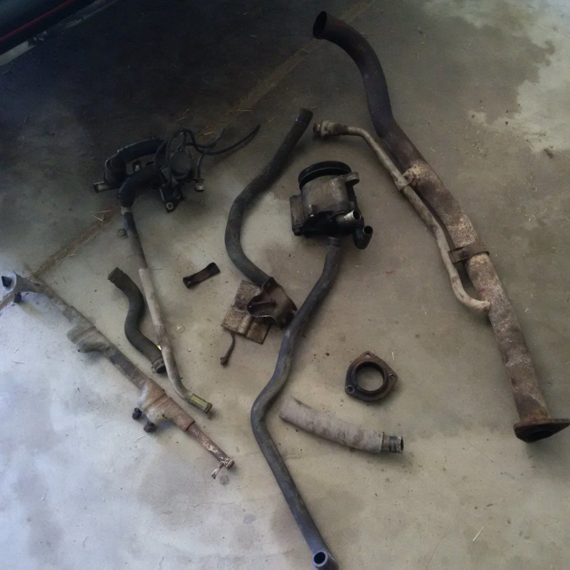

If you rip out the Smog stuff do not damage it. People will pay you money for that. aka. Kalifornians.
You will still need to retain VCV's and also the BVSV's on the thermostat housing. Plus a few others. Look up "My Desmog Thread" and have a good read.
