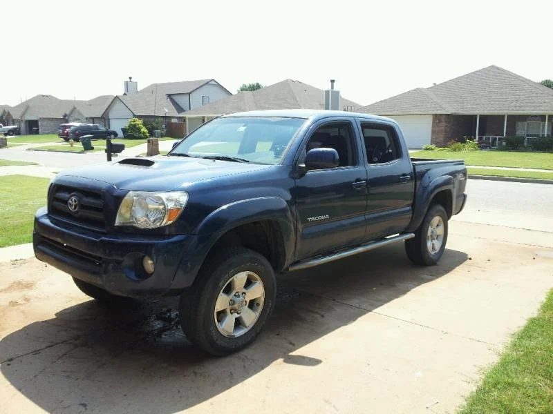

So, I picked up that 2006 Double Cab TRD Sport in November. Haven't done much to it other than catching up on maintance and fixing the little used car issues. I've been having issues with the rear bottoming out pretty hard even on bumps on the street. I thought shocks at first so I replaced them, and those that came off seemed fine, and I even replaced them with the correct TRD Bilsteins. Only thing I can think of is tired springs. Because it is the sport it only has a three leaf pack, well actually only two and then the overload. The truck sits pretty level and it really should have a rake to it, which also makes me think tired rear springs. So I ordered this...
http://m.summitracing.com/parts/fip-2407
And since I had a little money left over after paying uncle sam way more thousands of dollars than I really expected, I got this.
http://m.summitracing.com/parts/exp-65205

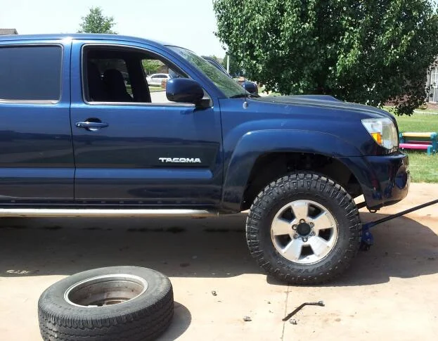

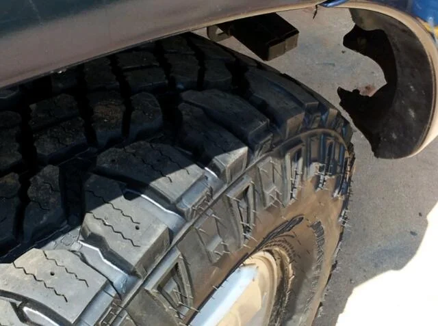

I know it's just a cheesy strut spacer leveling lift, but it will put the truck at a level that I can fit the size tire I want when I replace them in a couple months rather than stick with stock size. And believe me, these tires definately need to go. They probably have a couple thousand road miles left, but even a little mud and they are worthless (photo from taking Elliot out to shoot his BB gun last weekend). And then I can spend my time and money on sliders and bumpers, then come back around once all that is set and have a better idea what I want for a real lift (the bags will likely remain). Just can't decide what I'm going to o for tires. I like the tall skinny 255/85R16 but have 17" rims and only BFG makes a tire in the equivalent 17" size. iThe parts show up today. Just in case anyone was looking for something to do Thursday and Friday night.
