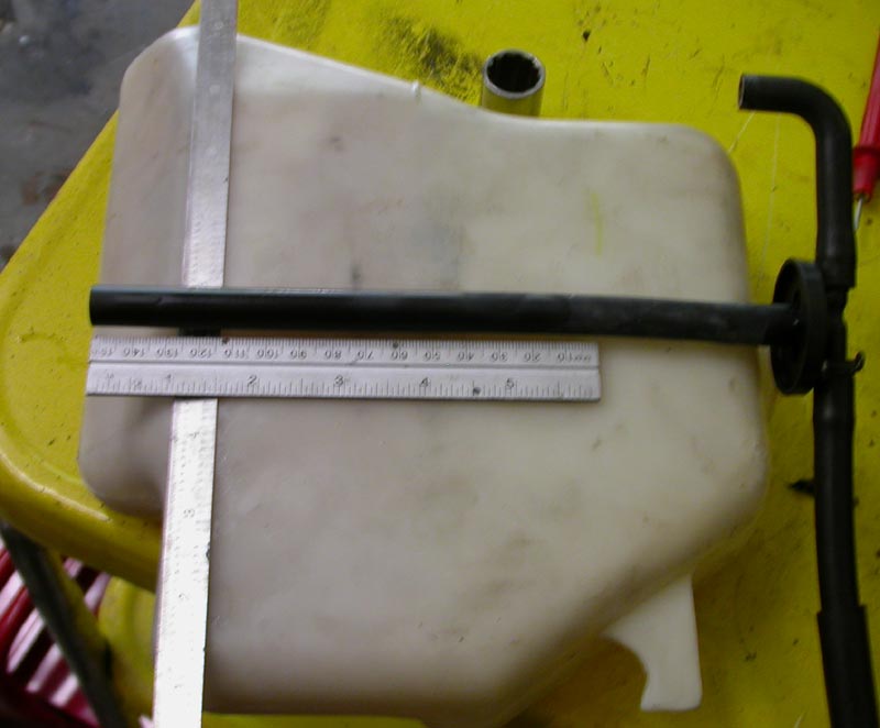

After pulling out the overflow and pouring off the coolant I looked in and found a thick mud like deposit at the bottom maybe 1/8-1/4" thick. I stirred it up with a screwdriver, it was not solid or particularly stuck together more just settled, it acts like river silt or wet clay. last time I found just small amounts in a few places like settled right in front of the thermostat and alike and it was grayish green in color, my 80 came with a mix of red and green coolant, this time the sludge is an earthy beige to brown. Color from the red coolant? or is it a different material this time?

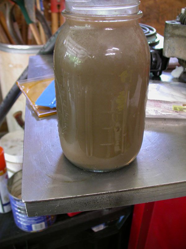

Well anyway I put some water in the overflow and shook it up and the stuff came out like chocolate milk, I have it settling in a mason jar overnight.

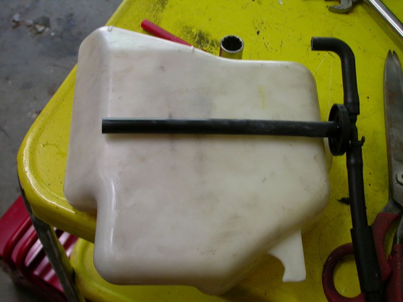

I have always had some sludge in the radiator cap between the two seals, even if I cleaned it off it came back, I think I know why now the tube in the overflow gets its fluid from the very bottom where all this silt was, every time the engine cools it sucks up a load of this crap, so I cut about 1" off the tube to make it level with the low line, now anything that settles in the overflow will stay there not bothering the water pump or radiator, only downside is that if the level gets very low the radiator is more likely to suck air and will not have access to the last inch of fluid in the overflow bottle but that should not be a problem as I keep a good eye on it.
I am going to have a good size sample of this stuff I need to find a way to test it. Unfortunately I am a light weight in chemistry. going to re read Rich’s separation process. There is a lot of larger black sand like bits in it also,
pics
Original tube
Trimmed tube
Jar full of settling funk

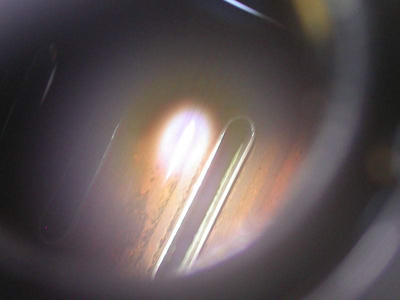

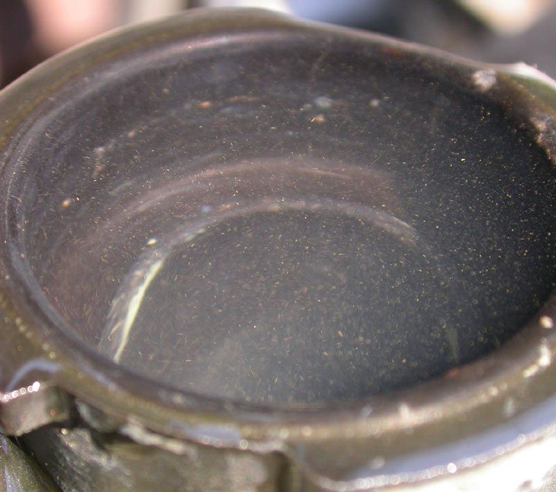

1, directly after the first drain, notice the black patches, it does not show well but that is the black grit/sand settles together in low spots
2, after flush for comparison, black sand gone (or at least moved to somewhere else)
3, even after a long hose backflush and a drain and fill with water this particulate is still circulating

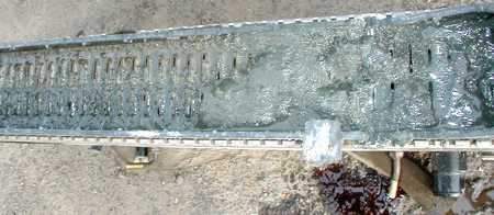

anybody remembers that photo that Christo (IIRC) posted of the cutup radiator chock full of the stuff a year or 2 ago? I can' t imagine that this much material would come out of the HG. Heck, there must have been more there than the entire mass of the HG....

Eric, here is that radiator pic, agreed hard to picture the HG makign that much of this stuff.
Yep, that's a lot of sludge - too much for the HG. I noted that the parts of the HG that close off holes were turning into mush that's grey in color and slick in consistency like the grey clay I've also seen a thin layer of in my 93 over the years. So, back to it being a precipitate caused by mixing the green/red from a previous owner, I guess.

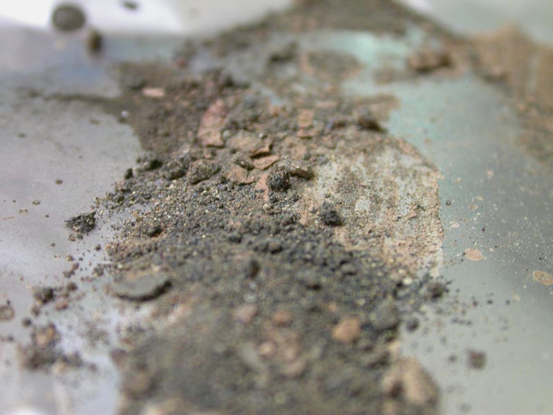

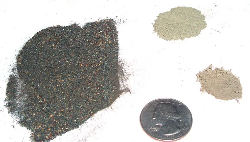

Well I have collected about a shot glass full of dried “stuff”, riddle time,
Got a small pile of mainly largest sand sized black bits, a small pile of almost pure fine gray stuff and a big pile of the fine black and fine gray mixed together.
The black stuff is heavier, it always settles to the bottom of a column of water first, The black does not shrink as it dries, carbon fiber is pretty light I do not think the black is HG material, maybe I need to grind up up a section of head gasket and see if it sinks in water.
also noticed that the gray as it dries it shrinks and cracks up like a dry lake bed.
So far all I have tired to do with it is burn it, something flashes out of it almost immediately (coolant?) as it warms up but the majority of it is stable up to high temperature, it does not melt, burn, discolor or stick together when heated. So it is not plastic, organic or hydrocarbon based.
So what else can I do to this stuff to figure out what it is?
