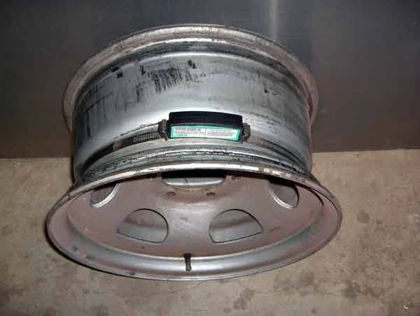

Don't know if this will help or not, but here is a product that I used called Smartire. The sensors mounted to the wheel and sent information to a display I had on the console. It gave tire pressure and temperature information. There were pros and cons to the system. IIRC, I ran 285 BFGMT’s then at 60 psi. In the cold the tires would start off at approx. 53-54 psi, then increase in pressure as they warmed up.
Bill
Edit to replace picture.
Bill
That looks pretty sweet! I imagine changing the batts would be a 'con'. Any others you remember?
-Spike

Quote:
-Spike
Some cons.
The batteries in the tire senders were sealed so had to be sent back to the company for replacement. They were supposed to last six or seven years.
Each tire sender had its own frequency or way to identify itself. If I rotated the tires I had to make notes where each tire was so I would know the tire location of which pressure and temperature the receiver was showing. Each wheel had to be marked with a number to identify it.
In order to preserve the battery in the tire sending units, the units shut down when not moving. So until the wheels turned several times, there was no pressure or temperature reading.
The tire sender units came with a counterweight that offset the weight of the senders. It made it more difficult to balance the tires depending on where the sender units ended up being placedin the wheel.
Care had to be taken when mounting/dismounting the tires as the sender units stick out from the wheels and the tire easily would catch on them, possibly ruining the sender.
Money. IIRC, I paid $600 or $700 for the RV (recreational vehicle) package to get six sending units because I carried two spare tires and wheels.
I have no idea how much these things are now or if changes have been made to them. It was nice to have a warning light and audible signal if a tire was going low or getting hot and to monitor the tire temperature and pressures without having to physically check them. These things would also be great for pulling a trailer as the trailer tires could give a warning and/or be monitored from the towing vehicle. HTH
Bill
