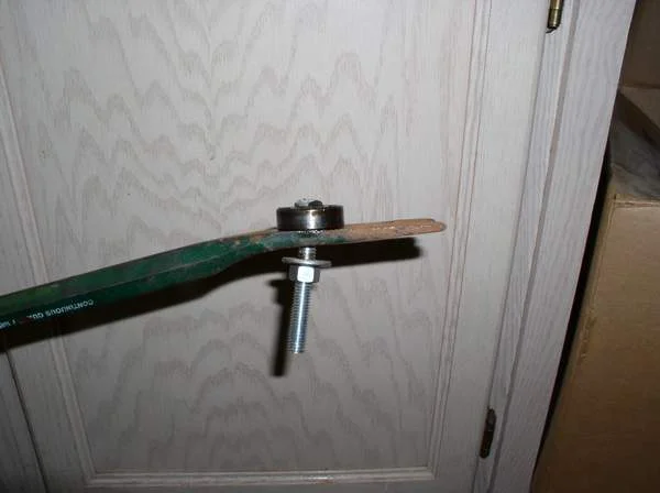

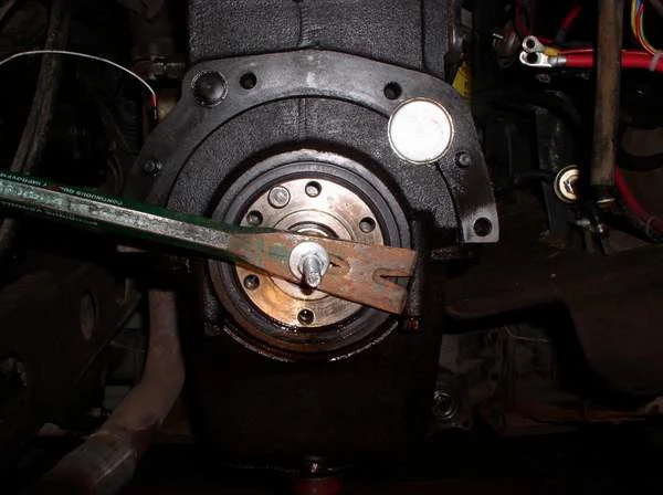

"Leveraging" off the .39 cent carriage bolt idea....
Instead of a socket, use the hole in a crowbar / prybar. It rests perfectly on the raised flywheel alignment ring on the crank.
Tighten, Leverage it out. Took 5 minutes to make the bolt, and 15 sec to pull the bearing.
Yesterday - it wouldn't budge.
PS. Shoot some PB Blaster in there first. That probably helped too.
