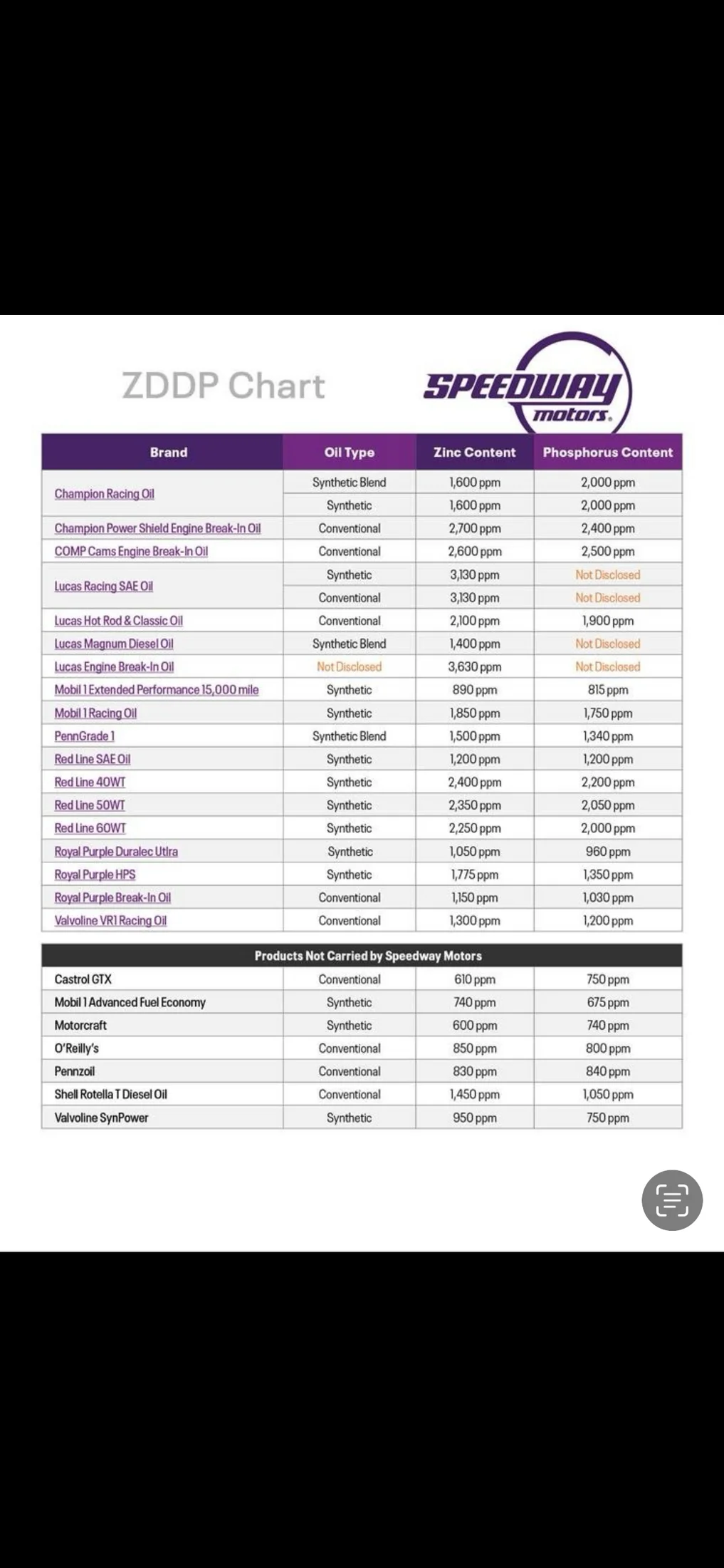

Valvoline VR1 and Mobil 1 15w50 are easily found and the highest in zinc you can find.
Brad Penn makes some excellent oils for these motors that are high in zinc, but they’re not on the shelf anywhere.

I don’t know if you really need to add much more zinc to it, but I guess you could calculate how much additional to put in for a target of something like 1900 ppm?

any clue how much to add if I used shell rotella?
Dont use the additive, use an oil that has been formulated to have the higher zinc level built in that you want. That ensures the zinc will work properly with the oils wear pack chemistry.
When you add a zinc additive to X brand oil you have no idea if they have compatible chemistry. There have been tests that show accelerated wear when the additive disrupts the oils chemistry or vice versa. Sometimes they wont mix correctly and will make each other less effective.
Not all zinc has the same chemistry as well, so you are performing an experiment with your engine....
Also todays oil wear packs are more advanced than they used to be and contain other things that are 'better' than zinc now and provide the same benefit as zinc but in a different form. Theres a lot of science behind this and you can go pretty deep trying to understand it all, or just buy an oil with what you want in it already.
