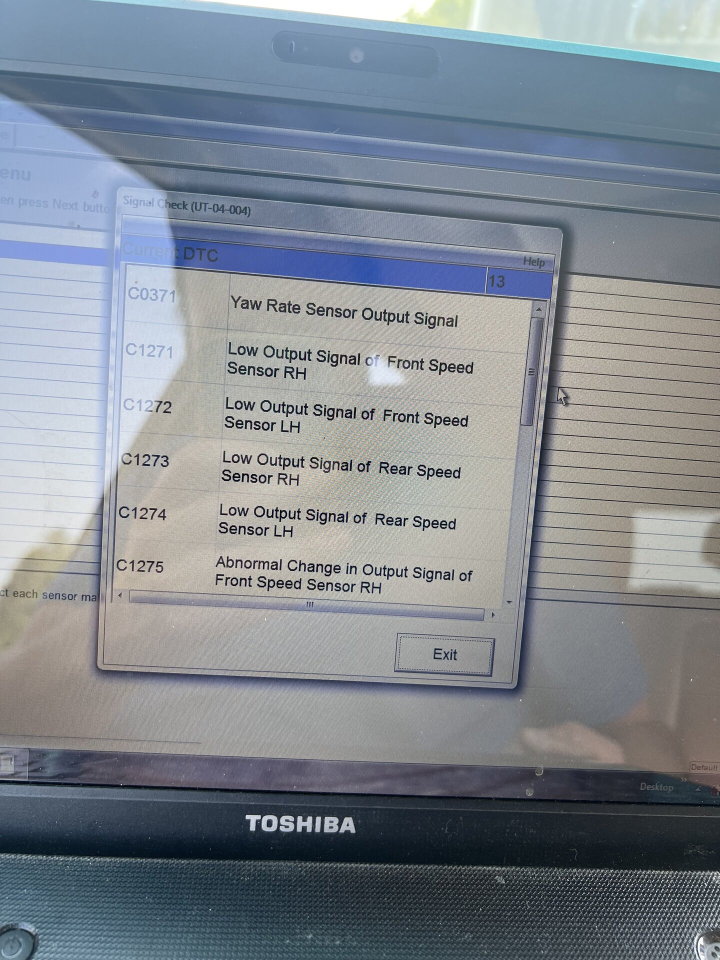

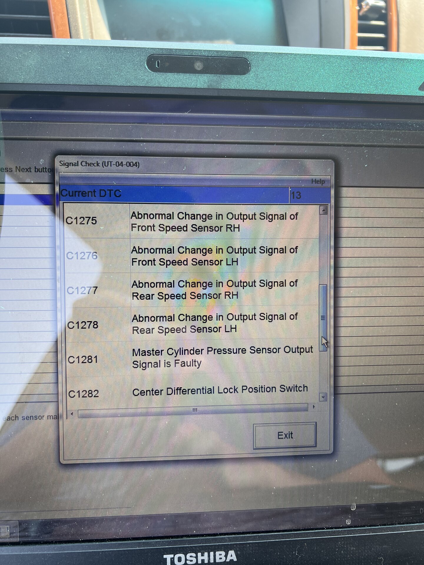

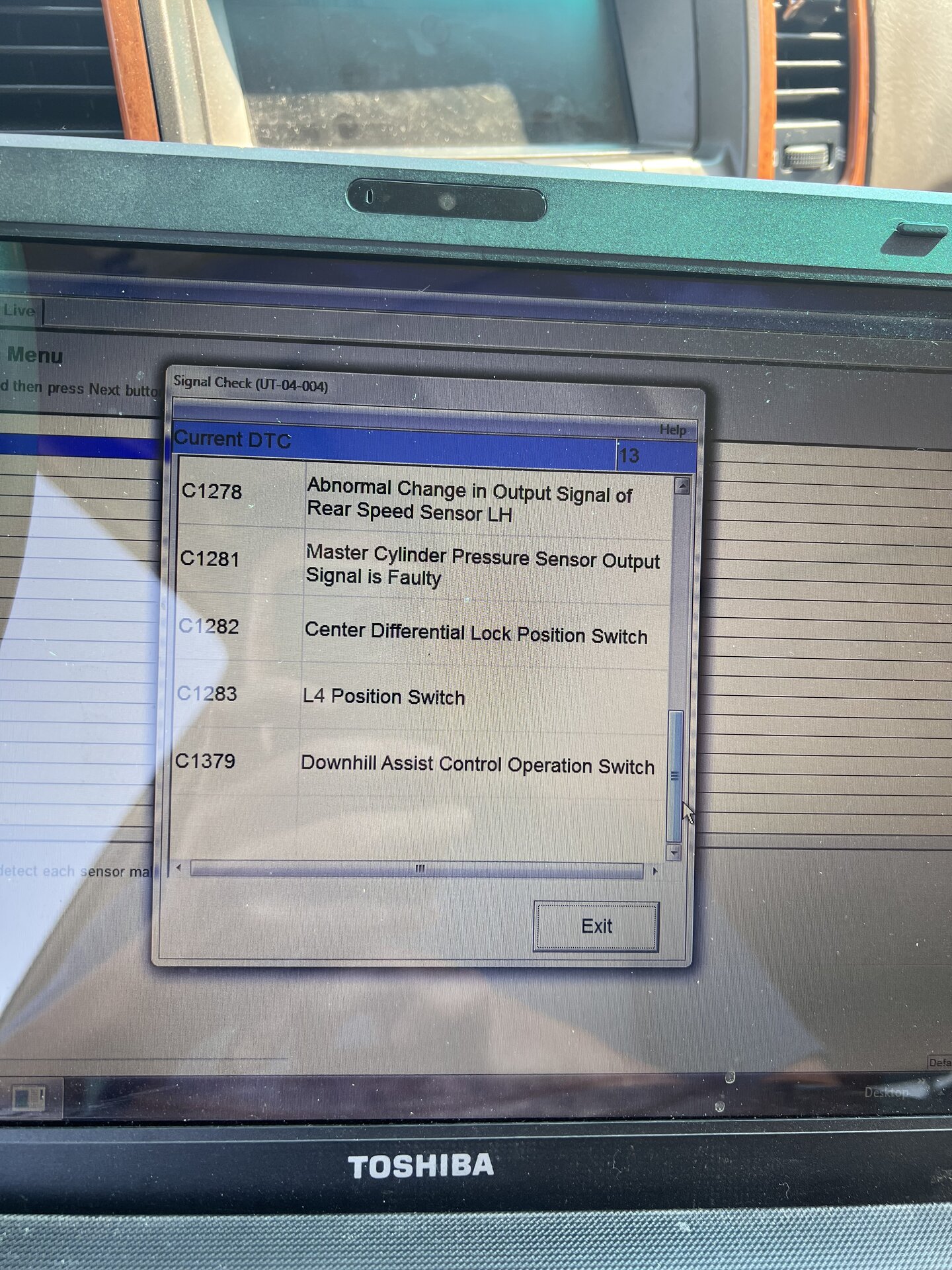

When I do the signal check this is what I’m getting
With that many errors, it's not zero point problem. You might have water intrusion problem and cause the VSC wiring to get intermittent signal.
I think all of that goes to driver side kick panel. It's a very big multi connector junction box.
I highly doubt it’s due to water intrusion, I never had a single issue with the vehicle until the new steering was installed 2 months ago. I can get the vsc to kick on during driving on specific roads and off ramps, every time. It’s when the car has some body roll and is turning. Hence a yaw rate issue
