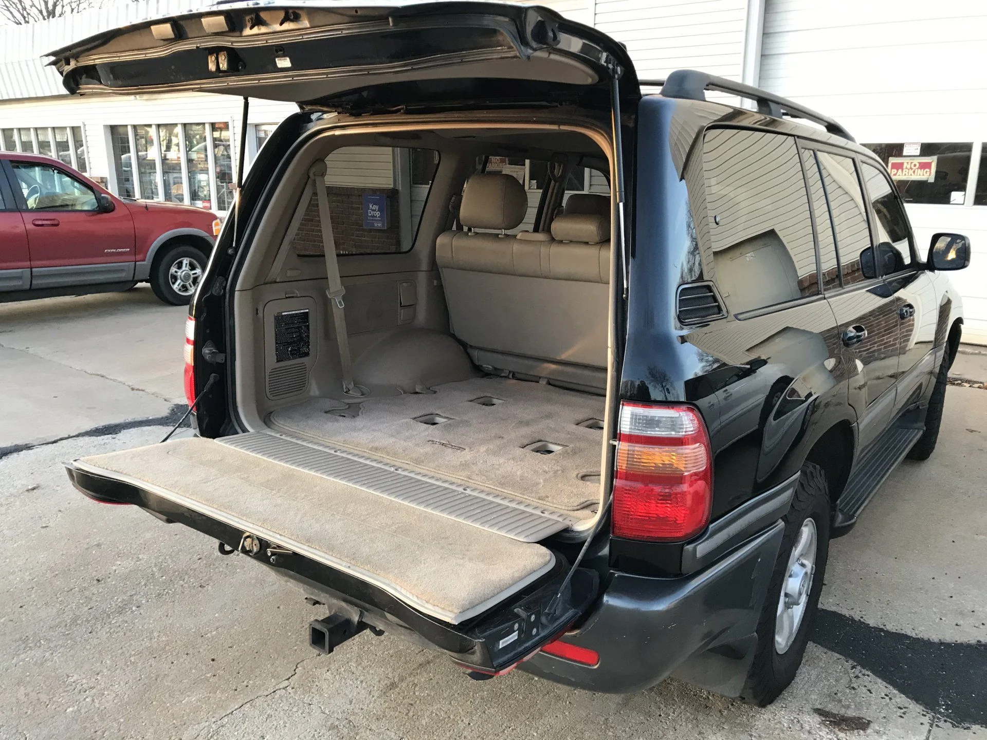

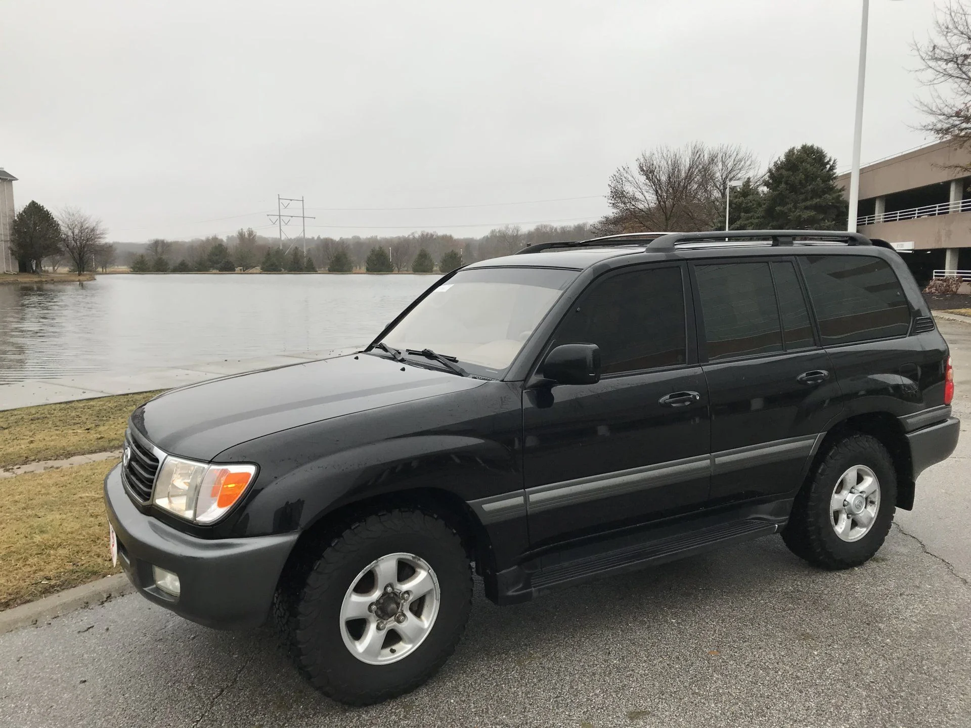

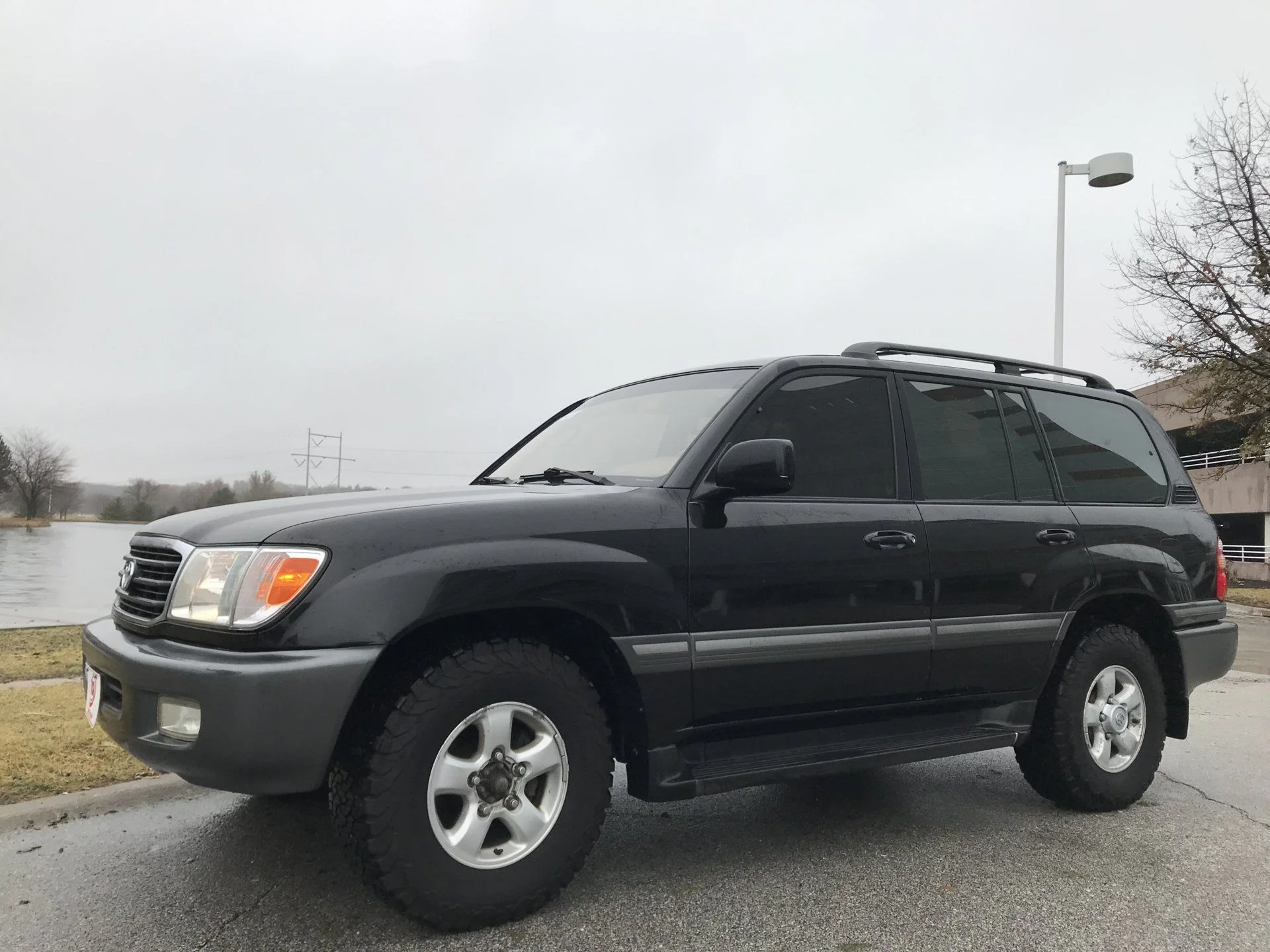

Hello, I finally managed to find my very first build project Land Cruiser. It’s a 1999 Toyota Land Cruiser and I need some help with where to begin. Would i love to have the $ to have it trailered to the fellas at TLC/IKON? Yes, but I don’t have that sort of bankroll. So, help me figure out what order all these upgrades and or repairs need to take place? Thanks in advance.

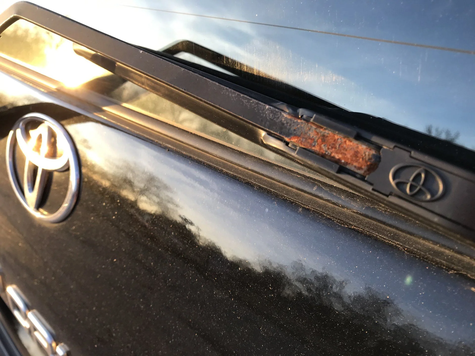

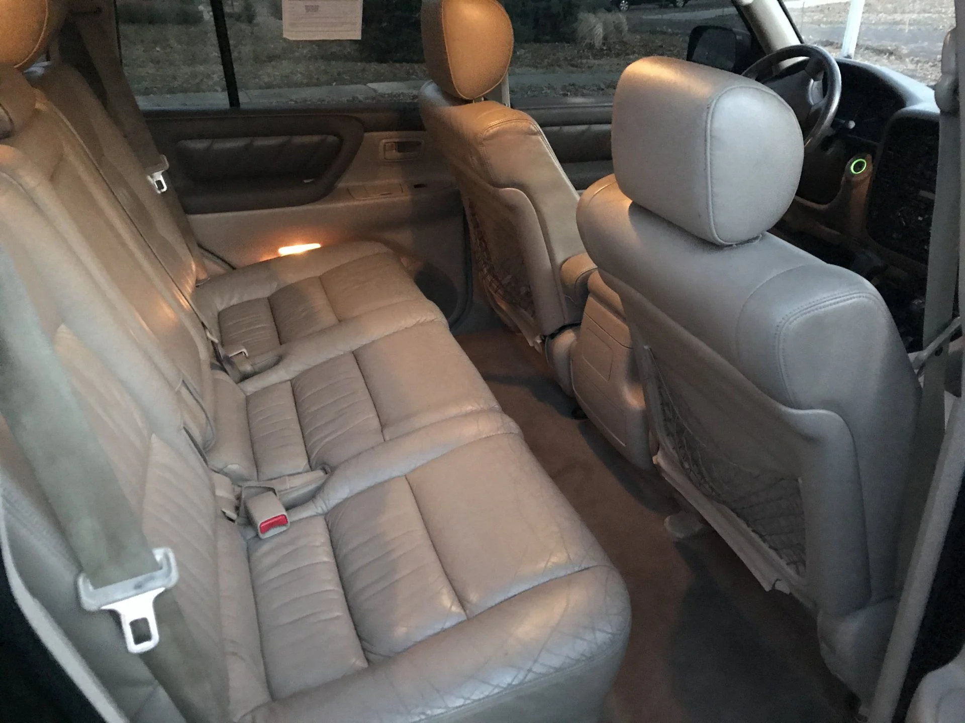

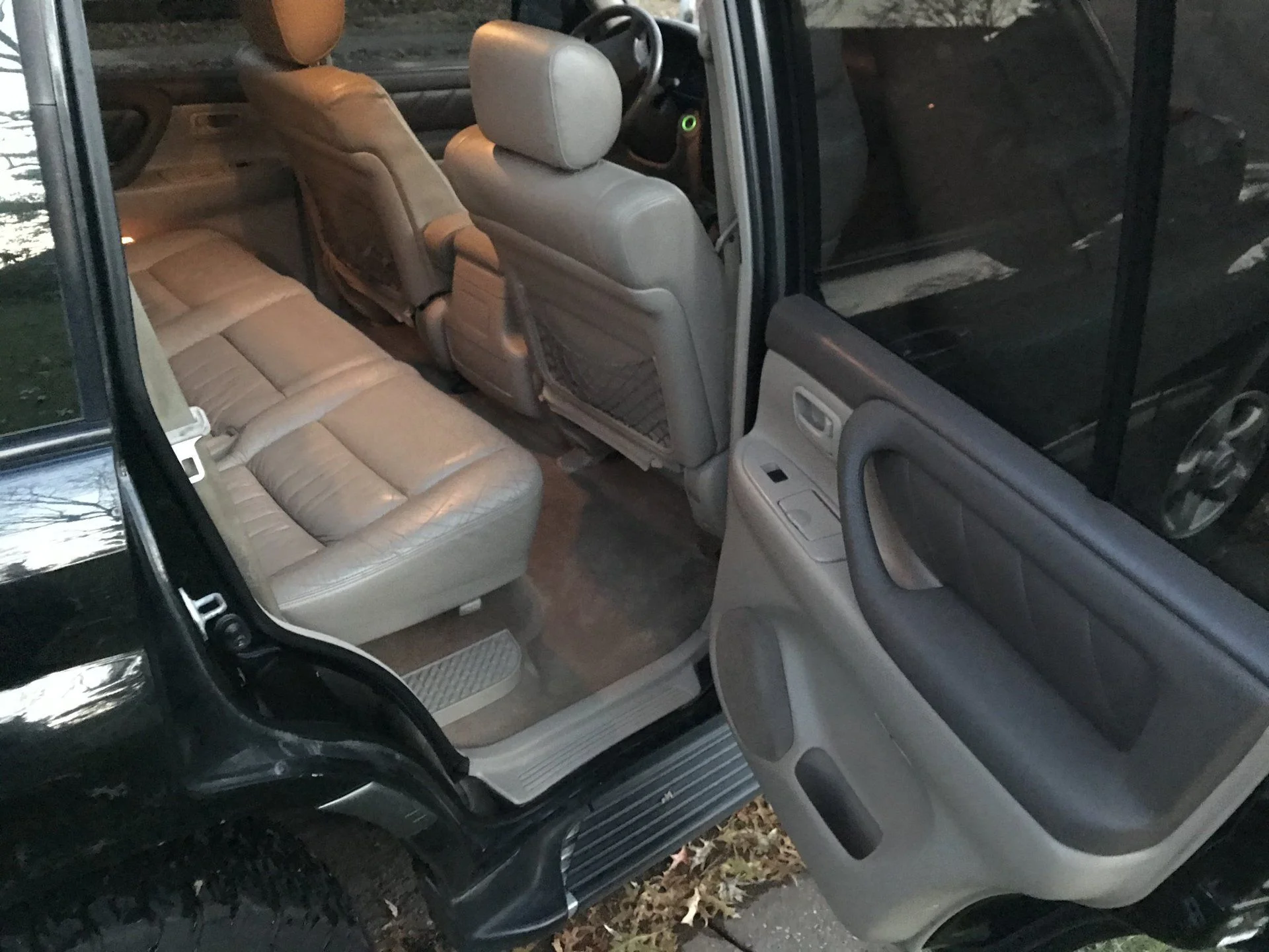

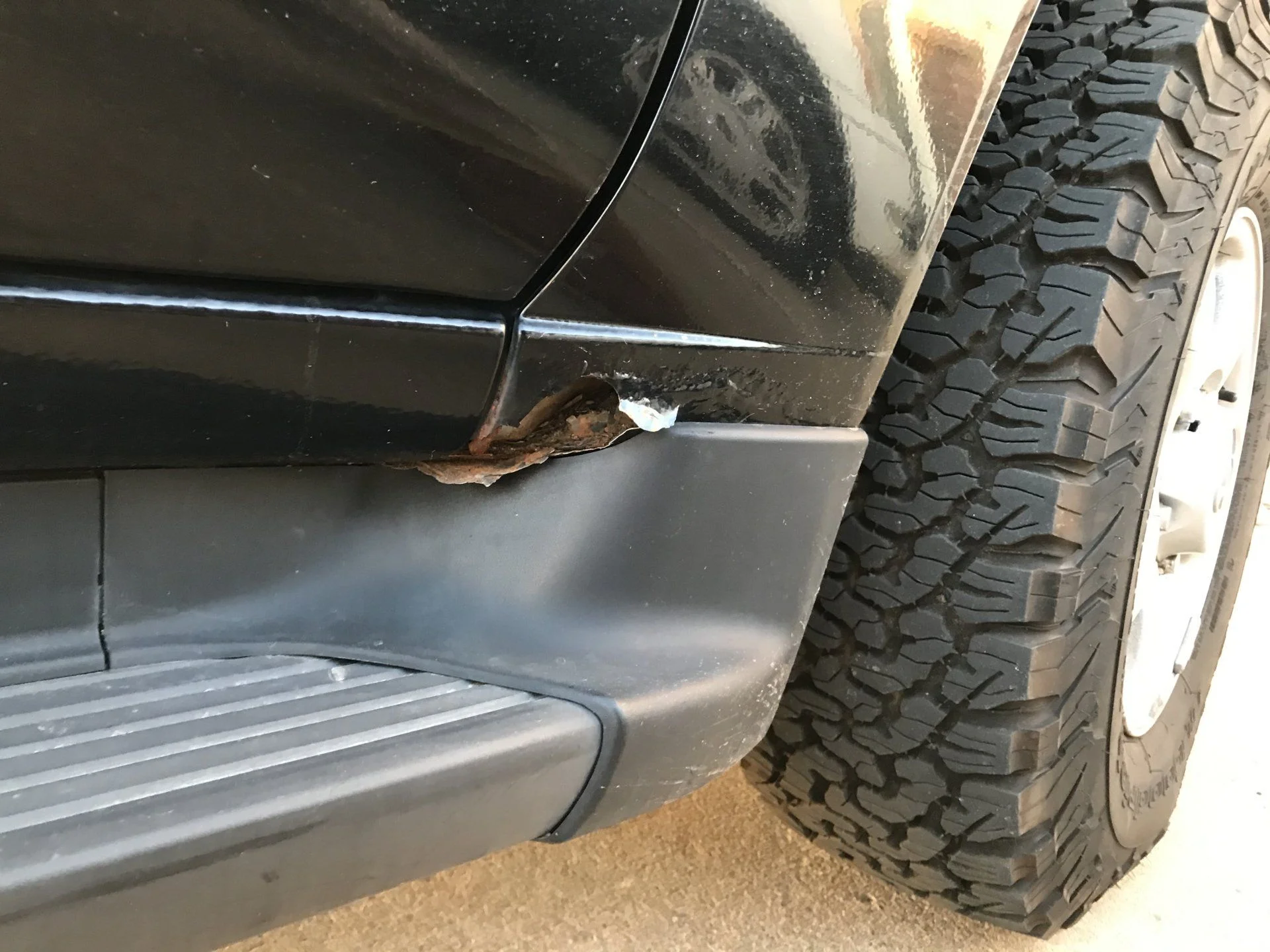

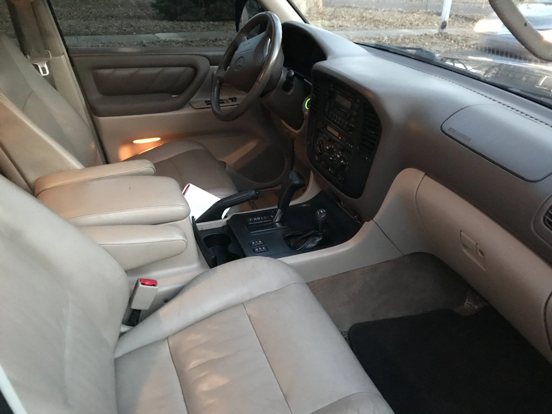

Probably could swing $3-$4k to start off. It has some rust beginning to come through on the rockers, handle on the tailgate has rusted off and in need of repair/replacement, wiper arms are rusting and could use some tlc, (not sure if there are stronger aftermarket motors to improve wipers performance?) the switches on the sunroof aren’t operational, driver’s side window/door lock switch plate seems to have a clip that’s missing or broken and looks a little janky, steering wheel could be re-wrapped, need a new/used set of tan leather 3rd row seats (missing), the “D” (for Drive) light on the dashboard transmission Christmas tree must be burned out? Antenna (of course) ain’t climbing out of his hole, windows roll up and down, but can be as slow as molasses. So far, that’s all the pesky “little” things we’ve taken note of that will need some attention. Now, the plans are to listen and learn as much as i possibly can from those of you who own a 100 series LC (specifically a 1999) I want to ease into this with the wisdom gleaned from those of you who can Offer the best advice on what steps to to take first. I would love to add a small lift kit (OME, King,etc.?) that doesn’t make it impossible for us to get in and out of it. Any other critical suspension add ons that make things perform better? Rock plates, rock lights, Slee Off Road rocker bars in lieu of the current stock running boards, ARB or Slee Off Road front bumper w/winch and LED lights as well as a rear bumper w/ ladder, storage racks/trays, spare tire swing/lock out, and some sort of idea as to what size tires and wheels w/bead locks to stuff under the wheel wells without rubbing and or causing steering/suspension parts the stress that makes them fail in the future, maybe a top rack and some light bar systems that are somewhat hidden and less pronounced than the BIG ROUND KC LIGHTS, replacement LED headlamps/lights (not just bulbs), also some smaller boxed LED lights to light up the ditches while driving the dark backroads to illuminate potential wildlife, stranded motorists or simply light up your campsite a little more while setting things up for the night? That’s about all that is running through my mind at the time. Might also include any engine performance advice for the 4.7 liter V8 and or extra battery, air compressor, bolt ons that have served others well in various parts of the build? Thanks for any advice you can offer.
Where are you located? I have the 3rd row, unsullied, that will never go back in my LX.

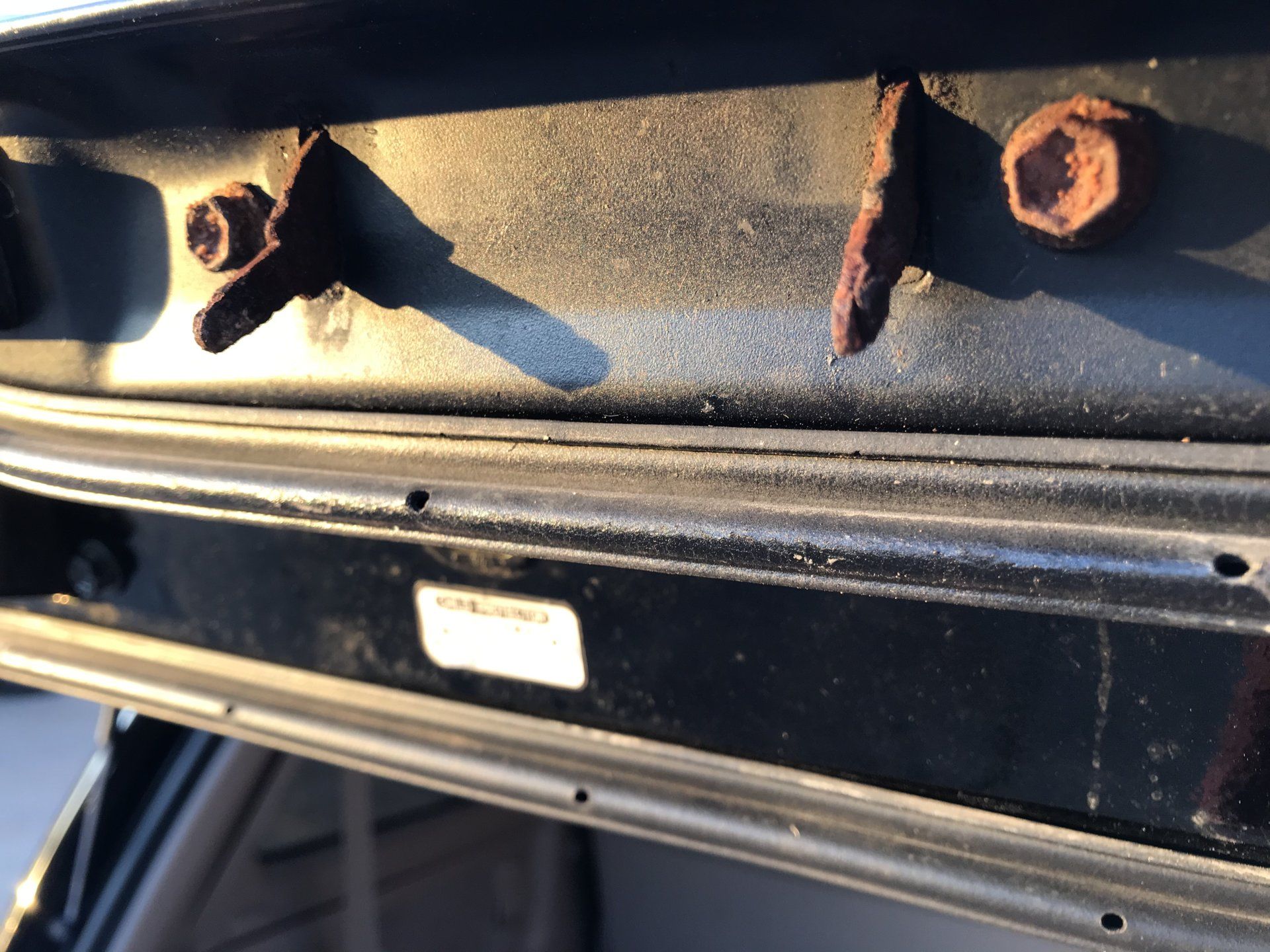

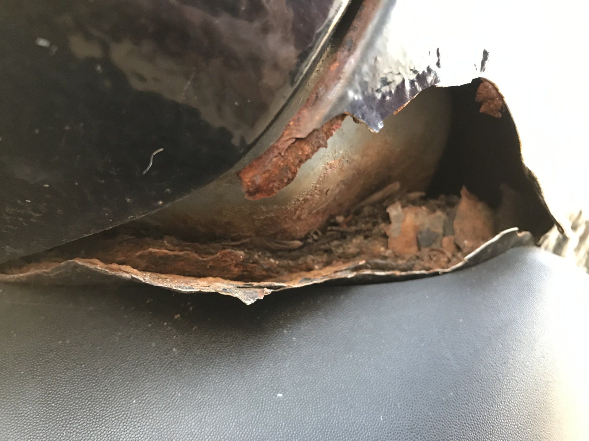

The answers to a lot of your questions can be found by searching the forum. There are lots and lots of different ways one can go with a build. However, every build should begin the same. IMO, you've got to take care of the maintenance/ restoration items first. First thing I'd do is baseline the truck and take care of all the necessary maintenance and especially the rust. Rust is the real killer of a vehicle and there is no sense is dumping money into mods on a truck that is only going for a rusty death in a few years.

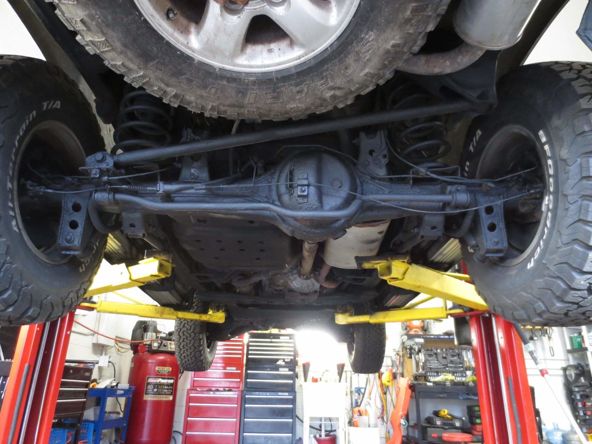

What does the frame look like?
If it's a rust bucket and has body panels eaten through, and you know this now, before putting anything into it: don't.
Baselining the truck, if it's not done already, will cost your $3-4k budget. If you aren't doing all of your own work, the timing service if not done is ~$1200. You're going to have a plethora of bushings to replace in the suspension. Front Control arm bushings alone are several hundred dollars for parts. Rust repair will cost you at minimum a few hundred bucks to just completely replace a single panel (if removable) and a lot more if there's actually body work involved.
Get the truck to a point that it's ready and worth doing mods to. If I were in your shoes and the underside of the truck is already rusty, I'd start with a new one that was a cleaner platform.
That probably sucks to hear, I'm sorry, but that's where I'd go after owning 4 and building 2 of these trucks.

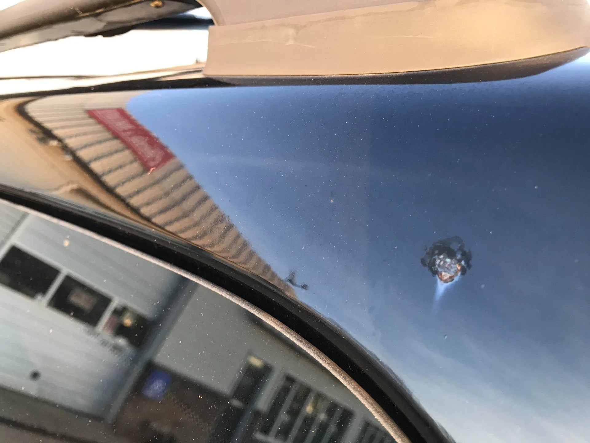

I had a few more pix of some “bubble rust” forming in a couple areas above the front window trim. I couldn’t post them because I could only attach 5 pix. It’s not a ton of rust, just needs to be addressed rather than ignored.
What about the chassis and suspension? That is what is going to make life miserable for the mechanic be it you or someone else ($$$).
Thanks, I can’t rack it myself, so I’ll have to try and illuminate the undercarriage to show you the current condition. I’ll try and post some additional pictures later “if possible?”

I am just down the road from you (Junction City, KS) and have a set of rear seats that have been collecting dust in my garage. They are in good shape but one seat is missing a head rest. Send me a message if you are interested.
As long as the frame isn't rotted out, I'd baseline the rig and start enjoying it. If that is the Cruiser I think it is, I had a good friend who wanted it but was concerned about the lack of maintenance records and the painted over rust on the axle. I suspect you will have a lot of sweat equity into it before long. The good news is you already have good tires :)
Those front rockers are holding some serious dirt. Pull the front wheels and the plastic splash shields out and get the dirt cleaned out, although it is too late for the passenger side...
