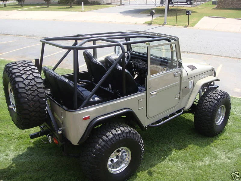

While we're on the subject I was thinking of doing kind of a "lower forty" build on this one with 37 of 38's. I know I saw somebody do a lot of body cutting to keep a low center with big tires. I searched all over but couldnt find it. Anyone have any ideas?

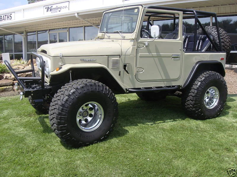

uuummm....that could be me, i got no lift but im just running 35's on my bush truck, its not done yet though
that it? thats not me in the pic, but my truck. 60 rears in the back and just cut my rear end up to fit the tires...will do 60 springs up front as well
Nice set up...I remember seeing yours too and even though its not the one I was thinking about it is exactly the look I'm going for. Have you tested out your front fenders yet? The other guy had to cut his aprons down,looks like you're probably going to need to also.

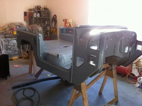

Anyway since I last posted I got quite a bit done:
-POR-15'd the frame
-Two new thirds, open 4.88's from justdifferentials
-Rebuilt the front calipers
-Replaced all rear wheel cylinders and hdwr.
-New Rotors/Drums
-All new seals and bearings in front and rear axles
-Two new poly performance axles in rear
-New Warn manual hubs
-All new brake lines
*SOR's new kit saved me hours of labor and fit great.
-Got the tub and body parts sand blasted
So now I've got some body work and paint and its on to reassembly. Shouldnt take more than a few......years.:cheers:

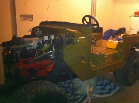

Managed to find time to get some painting and assembly done.
PPG Epoxy Prime
Olive 653 Single Stage
Now Im throwing parts back on it with reckless abandon, knowing I should be doing some things that Im not in the interest of getting it done. Is it easier to paint my brake booster now? Sure....but Ill do it another weekend after I'm driving it. :steer:
