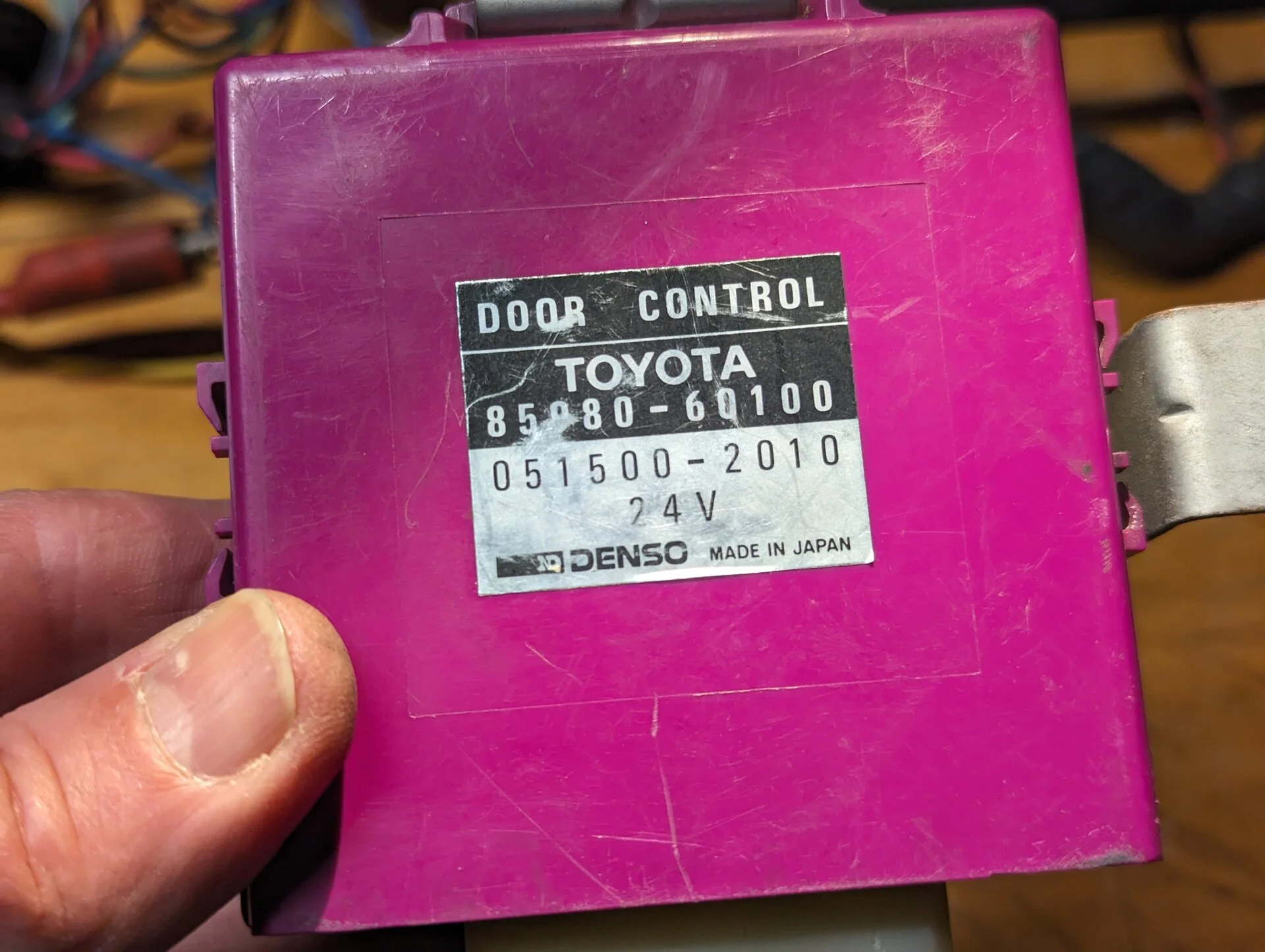

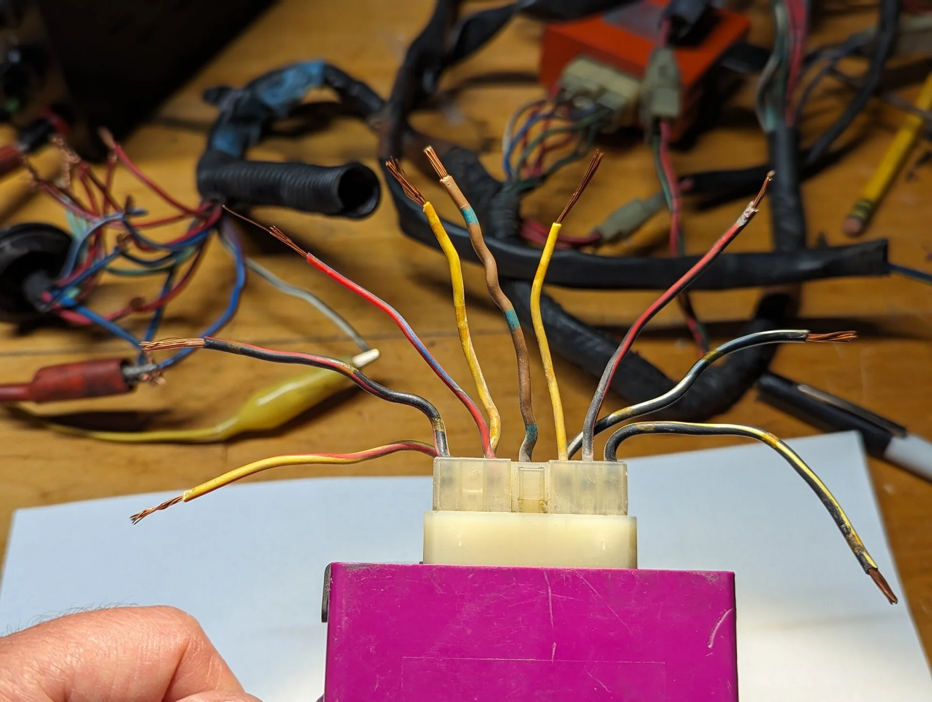

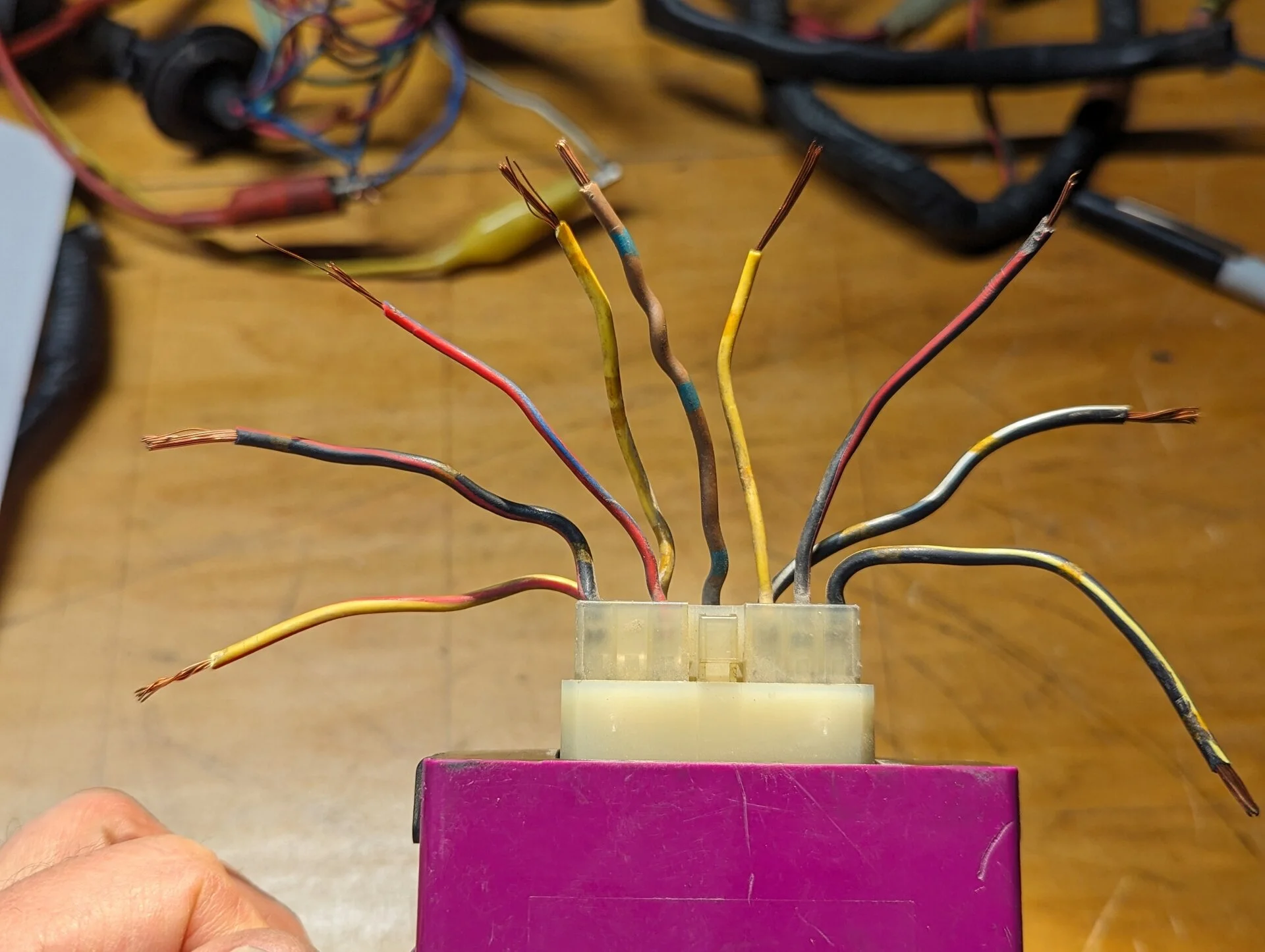

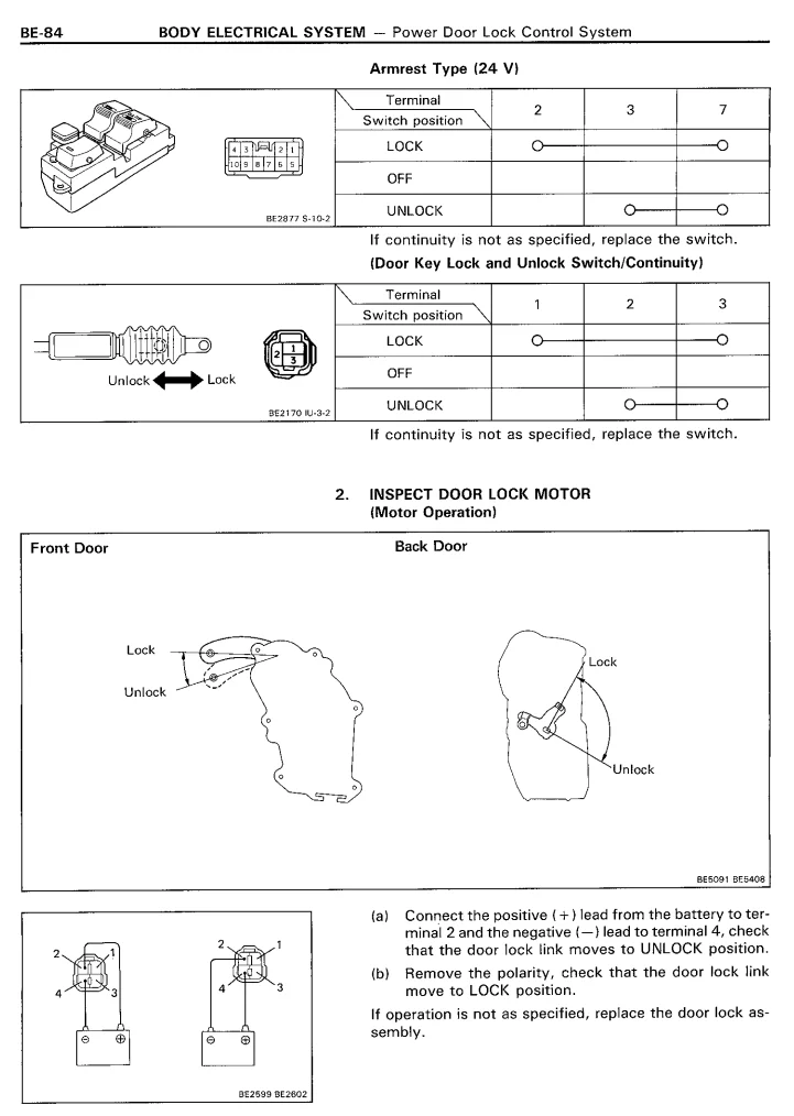

I have everything temporarily wired up on the bench and both front door lock solenoids are activating as expected. I thought it was going to have to use the door control relay according to the wiring diagram but as it turns out I have this hooked up without. I am using the power window relay that is part of the same harness for the windows which also work as expected. I guess my question is is this door control relay necessary and if so can anyone help me with wiring?
Anyone familiar with this circuit?

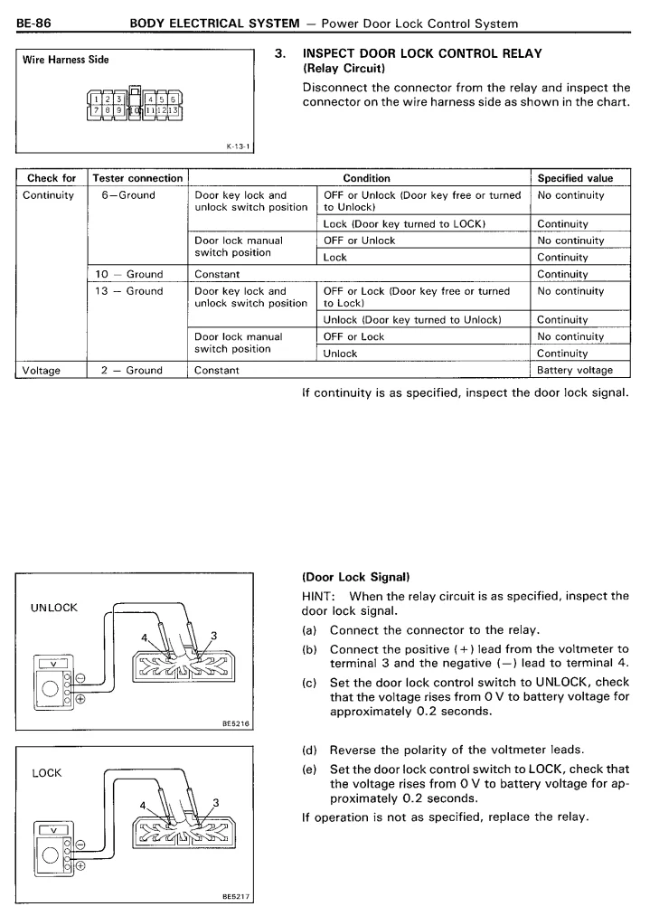

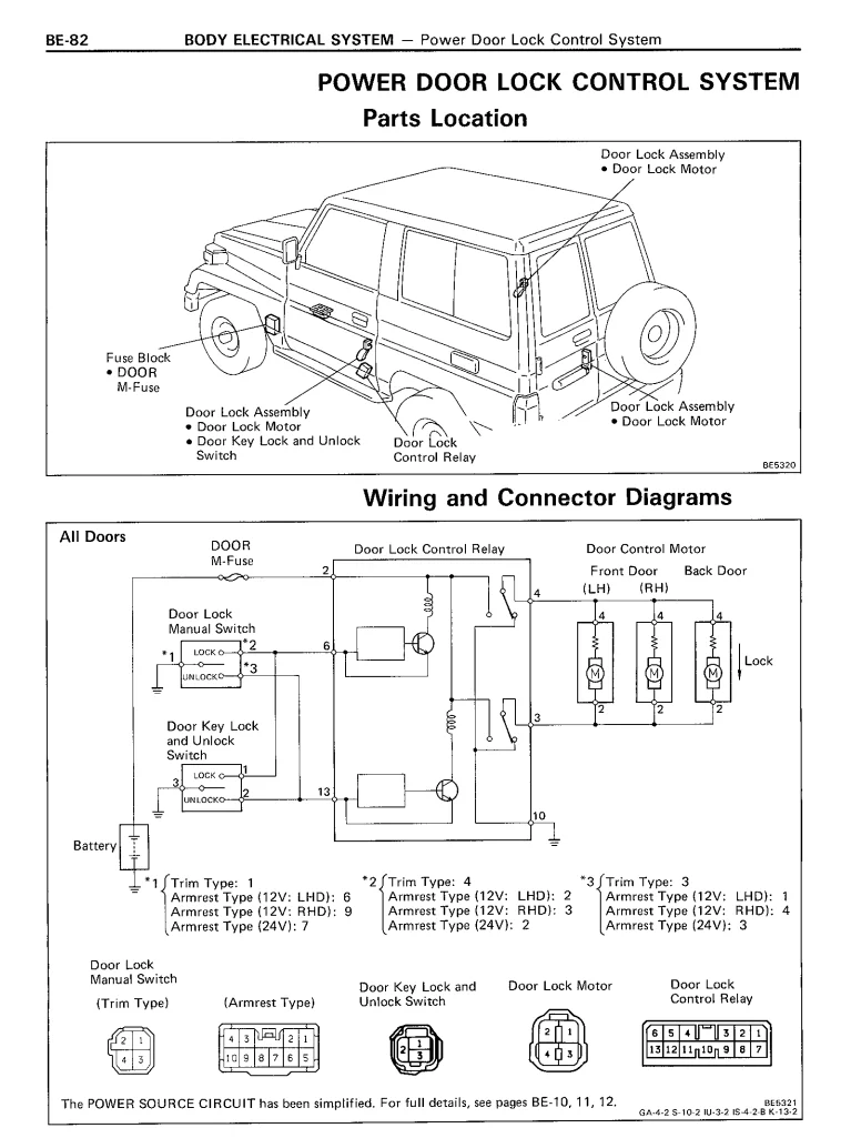

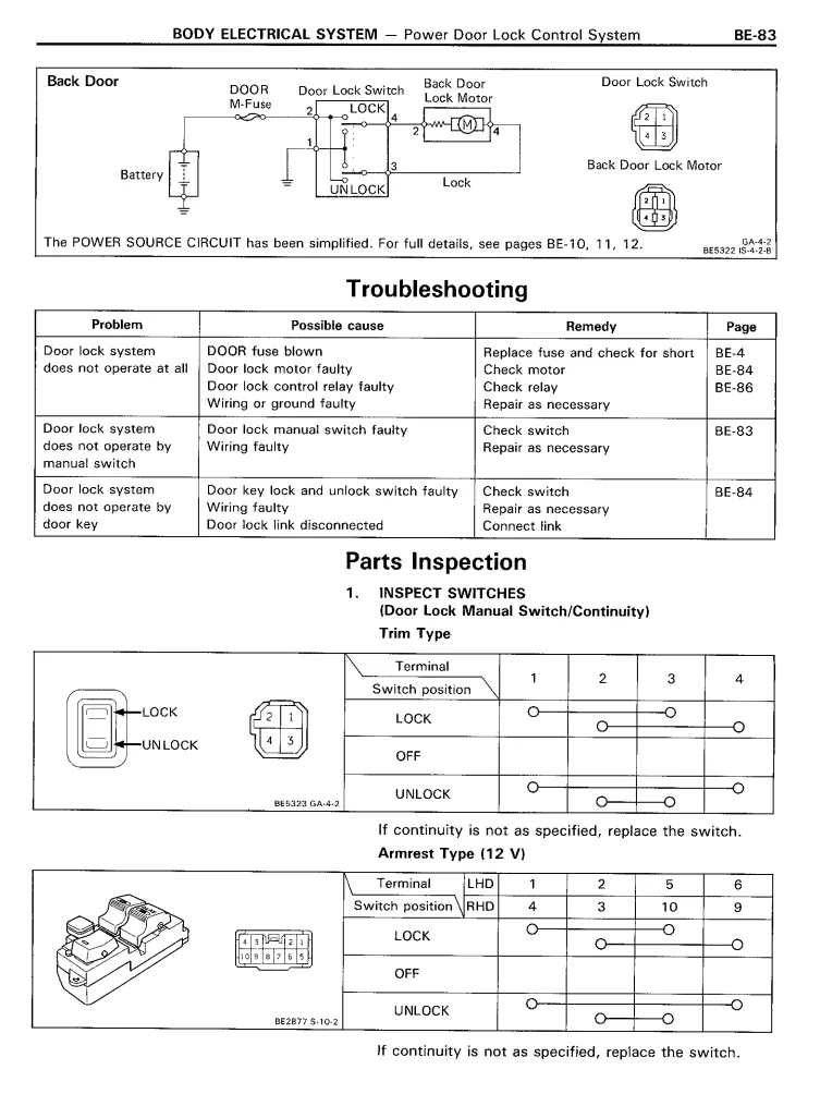

I believe you are looking for these:
Wiring is not a strength of mine, but my cruiser had remote locks wired which I have removed temporarily and plan to re-install. The relay was under the steering column and was wired to another controller in each door to actuate the locks.
Thank you, this looks like it'll help. What FSM/EWD did these come from?
I'm working on combining some manuals into a consolidated file so anything I need is all together, and plan to add some usability improvements to it.
Ahhhh... I see.... very nice. Consider sharing that with the community once you get there?
