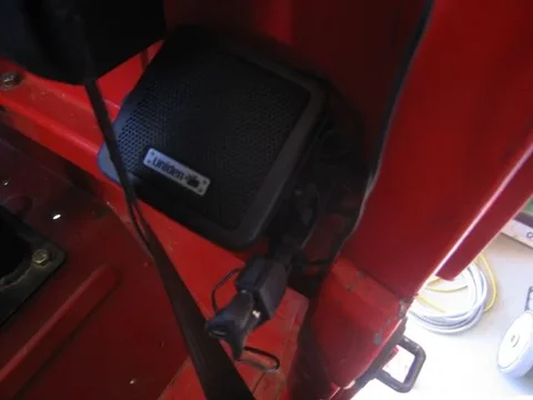

I've tried both. For driving, especially with other people in the car the earbuds worked better for me because I could still hear what was going on around me. Here's a picture of my temporary setup I have in my FJ showing the external speaker with the splitter next to it.
